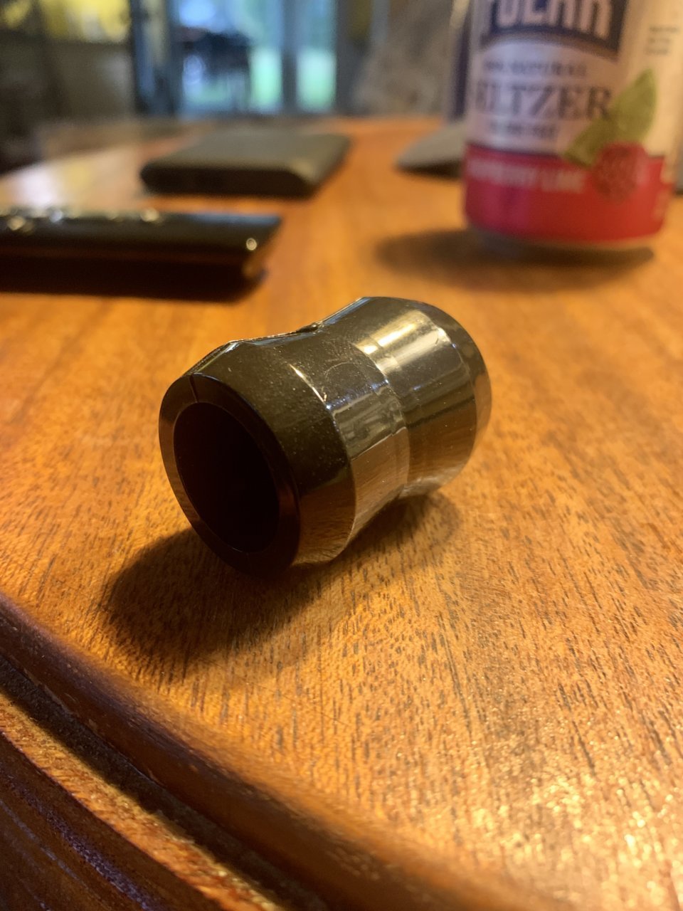

    Does anyone know the correct size hourglass bushing that fits the tacoma rear axle mounts and where to get them?
    Long story short when you buy Fox 2.0 shocks they come with the wrong bushings installed (For Fj, too wide) and you have to swap them to a skinner bushing that comes in the box. I believe it’s a 5/8” ID X 1-1/4” length. I looked all over and I cannot find hourglass bushings this size.
    I had my shocks serviced by Fox and they sent them back with the wrong wider bushings installed. They’re customer service is god awful and you cant get anyone on the phone so they have been of no help. Supposedly they shipped me the correct bushings but it’s been two weeks and nothing, my trucks been down for two months for this shock rebuild so im starting to get annoyed
    The picture is of the bushings thats too wide.

    I ended up sanding down the bushings I had to make them fit but the correct fox part# appears to be
    FOX-014-11-003-A

    I bought FOX-014-11-002-A for my rear 10in 2.0's w/ resis. Might be different than a 2nd gen though as it went on my 1st gen
    Should have probably sanded them down as they are pretty tight going onto the mounts, but some lube and a rubber mallet worked just fine.
    I got mine from polyperformance. Super fast shipping and awesome customer support.
    They're probably at trail hero rn so might not be as responsive, but I would definitely give them a shot.
    https://www.polyperformance.com/fox-hourglass-shock-bushing
