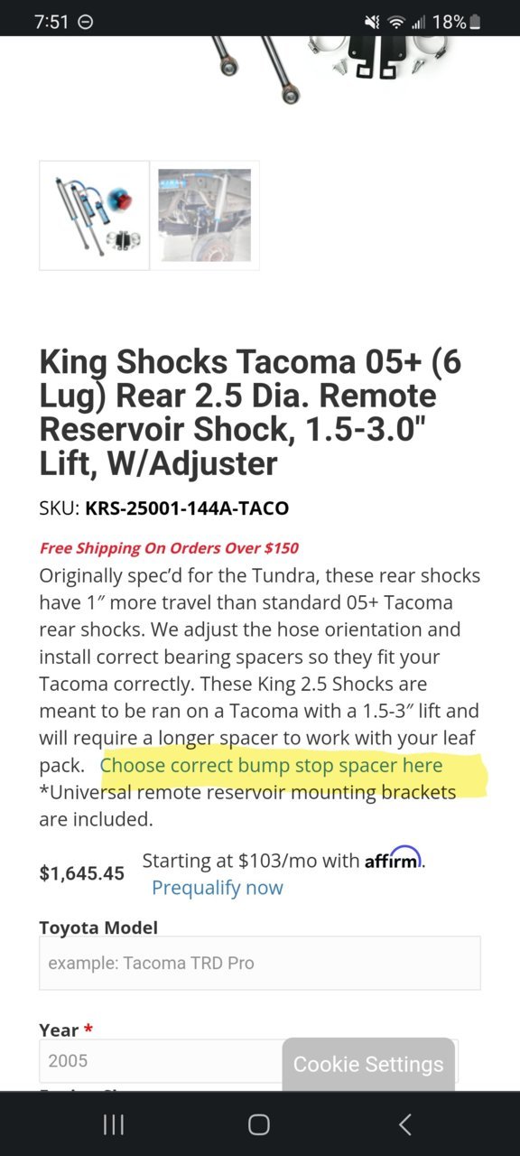

    recently purchased some tundra converted king shocks from accutune and tried to slap them on before work today. I thought it would b as easy as my eibach shocks in the rear but these kings dont compress by hand like the eibachs do. I cant seem to get it in the lower shock mount. Ive tried dropping the axle down but still has got a few inches to go. any tips on getting it in?? I just put my old shock back for now.. I thought to use my floor jack to conpress it upwards towards the mount but do I risk damaging my new shocks like that? thanks attatched a couple pics for reference

    kodiakisland

    I have these same shocks from @AccuTune Offroad. However, I have extended brake lines and taller bumpstops. The factory bumpstops and brake lines are insufficient for this setup.
    Simple, but necessary fixes.

    You might get away with the factory brake lines (I wouldn't), but you absolutely need talker bumpstops.

    Yea I am planning on brake lines soon. To everyone I already have a taller bumpstop and ubolt flip just havent replaced it yet
