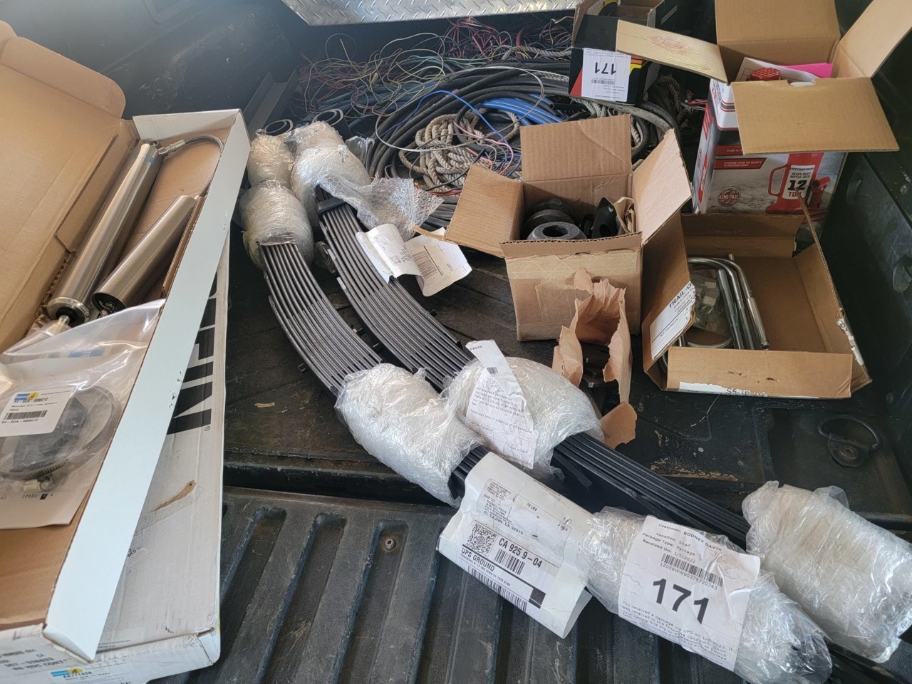

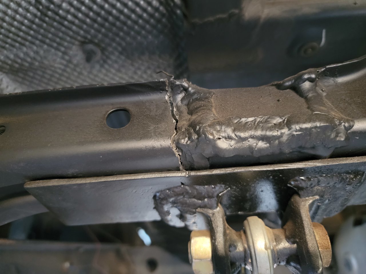

    My truck had a unexpected component failure in the rear suspension while I've been saving up parts to redo it.
    I'm very low in funds and can't purchase off the shelf rear shock mounts.
    I have new rear springs (AllPro? can't remember) and new Bilstein 14" travel 7100 rear reservoir shocks. New aftermarket bump stops and a ubolt flip kit.
    Anyway, I need a crash course on rear suspension travel to build the rear shock mounts so the rear shocks don't bottom out in either direction. I've got plenty of steel and a welder.
    I'm not looking for parts recommendations. I need some sort of formula, I think.
    Thank you!

    It’s just basic math. Put the new pack in and take all the leaves out but one, put a block of wood to take up thickness of the pack. Cycle the suspension and measure travel, where you’ll mount the shocks you’ll want to make sure you’re as close to middle as you can be, but may have to sacrifice some numbers for the sake of mounting configuration. You can always extend the bump tops to prevent bottoming out the shock, and where you put the axle mount is a compromise between ground clearance and up travel capability.

    Thank you! I never would have done it like how you wrote but I am doing it that way.
    Thank you. I'll check those 2 options out, it might save me some grief.
