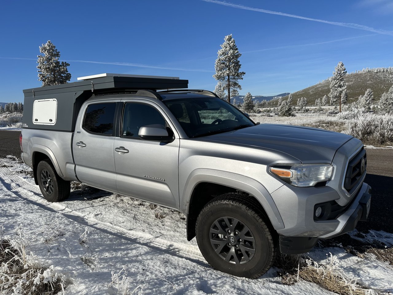

    I have a 2020 Tacoma double cab long bed. I added a Topo Topper and according to truck scales the total weight is now 5400, with an equal distribution front and rear. I do not intend to lift the truck or add larger tires, but would like to stiffen the drive a little and provide better support for the additional weight. I am looking for shock recommendations. Thanks in advance.
