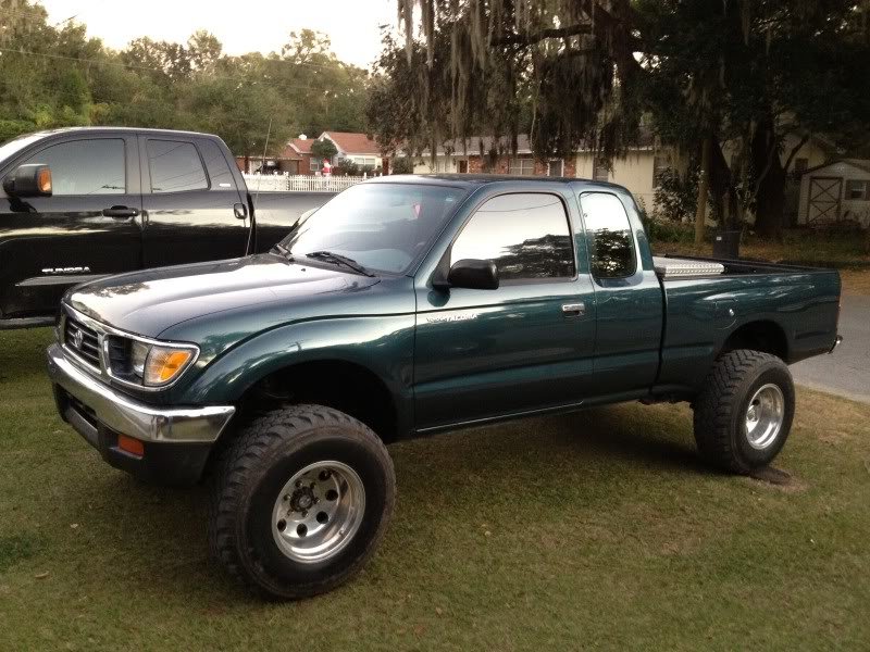

    here is a pic
    and here is a pic of the truck. I love the way it sits i just dont like how it rubs just a little bit backing out of the driveway at a full turn.
    The tundra in the pic is very big. My truck is on 32x11.5's

    that is a daystar kit that is composed of a top spacer and a coil spacer. One preloads the coil and one serves as a spacer to push down the front shock for lift.
    about 3'' of lift
    That lift is trash.
    Get rid of those ASAP and get Bilstein 5100's and toytec coils to lift the same amount.
    Where are you rubbing? On the frame or on the body?
    And what do you have lifting the rear? Good looking truck btw!

    looks like you might have lift shackels for the rear? idk in the pic the truck looks pretty level and you have a stock leaf pack

    You probably have a shackle in the rear because the daystar kit came with a 1.25'' shackle (I had the same kit on my truck, PO installed it)
    be more specific about "toytec" whats expensive?
    I have/had the same spacers as you...and trust me...they suck...trash...get rid of them.
    If you dont have the cash for toytec coils, get the 5100's for the front for now from downsouth motorsports and set them at 2.5'' without any spacers. Will ride better and wont suck.

    The bilsteins are adjustable for lift, .85'', 1.5'' and 2.5'' IIRC by using preload.
    You can remove all the spacers you have now, and just use the third setting (2.5'') to be level with your shackle in the rear.
    That will be much better than those spacers.
    If you do use the toytec coils, you set the bills at the stock level to get 3''.
    trust us when we give you advice.
    And $400?? The front shocks are $170 and the coils (if you get them) are $150.
    Not much money considering how high the quality is compared to what you have.
