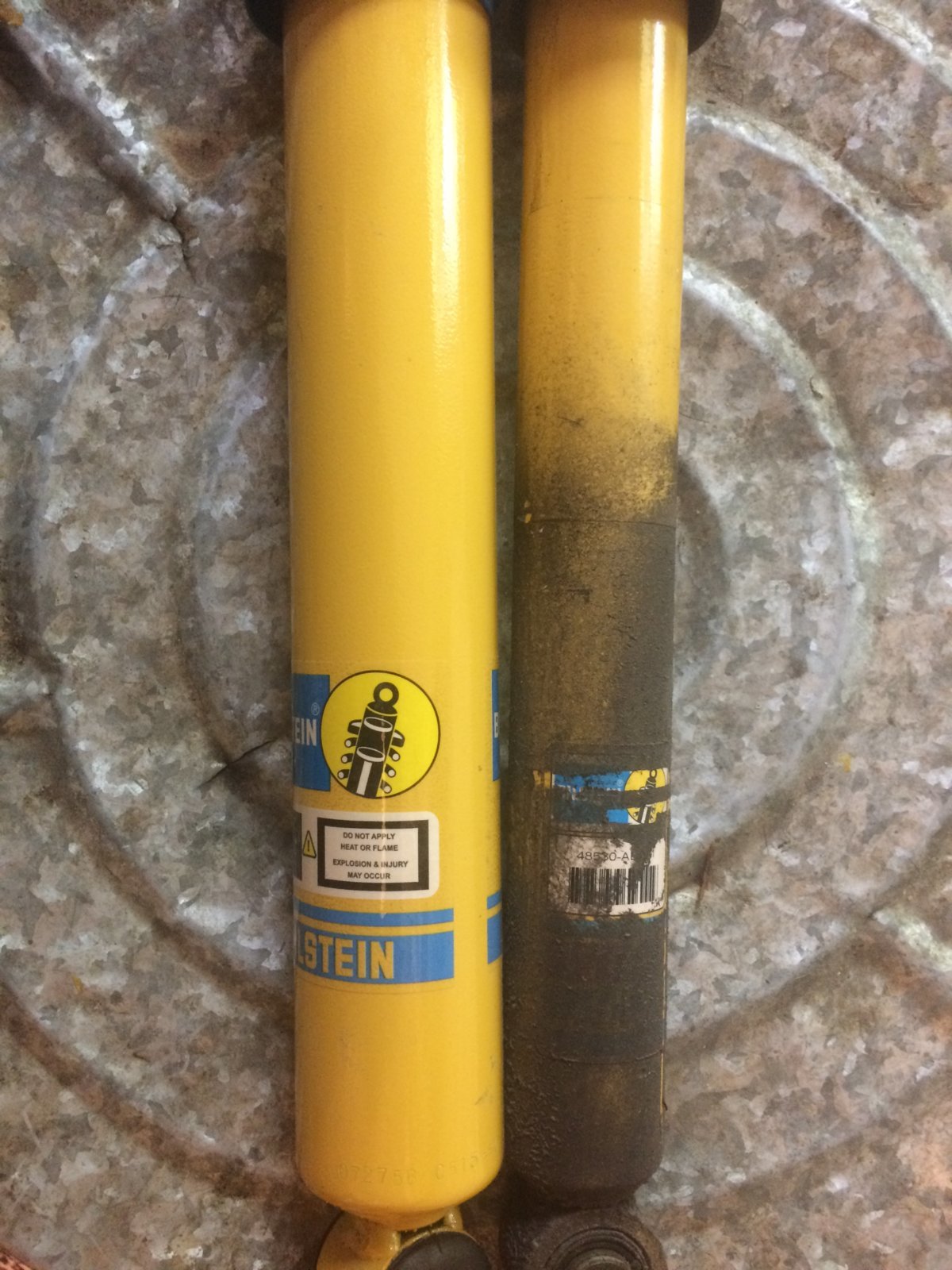

    My TRD sport came with I thought were 4600's from the factory but they are a smaller cheaper bilstein. If the shock you currently have are factory then I doubt they are 4600's. I bought real 4600's and there is no comparison.
    Now if you installed 4600's way back bilstein does have a lifetime warranty of their shocks. If you think they are bad you can get then repaired.
    https://offroad.bilstein.com/en-us/warranty/
    I find the ride with the 4600's well controlled with just the right level of firmness.
    very smooth on the highways. Had them on my older mustang LX 5.0 and even my Minivan.
    This is a real 4600 rear compared to the factory "bilsteins". 4600's larger in diameter.

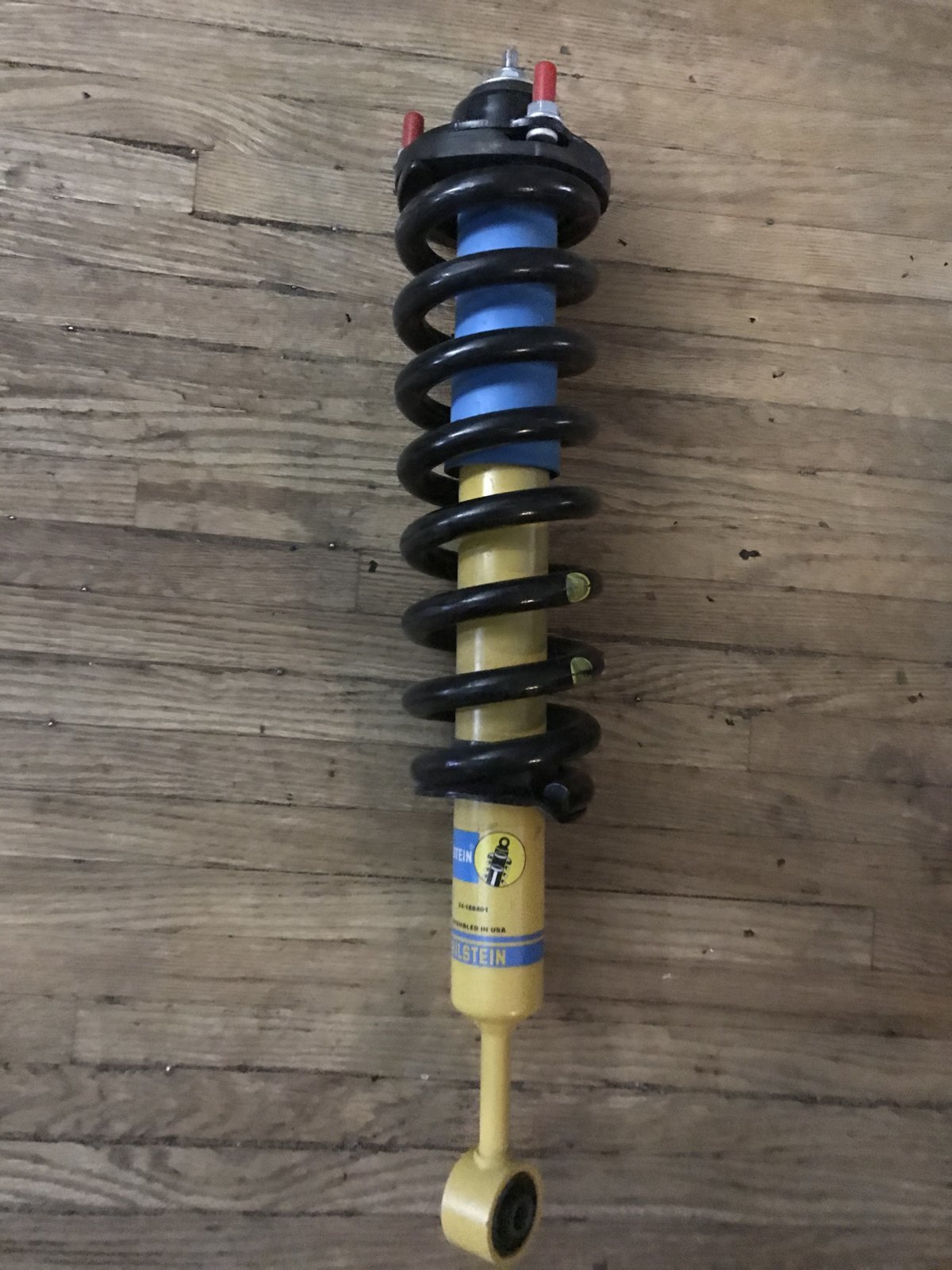

    and this is a new 4600 strut with takeoff TRD sport springs and new strut mounts ready to be install in the spring.

    Even though you're talking non-1st gen parts, this is a well known and documented topic. The factory equipped bilsteins have a smaller diameter body than standard 4600s. That's most posts you'll see are along the lines of "the closest you'll get to factory are 4600s".

    But the original poster didn't seem to know that so I was pointing out the error..
    "Should I go with another set of Bilstein 4600's (what came with the truck)"
    ...Since it didn't
    And from previous posting the OEM shock maybe twin tube.
    But whatever they are they are not the monotube 4600 series
