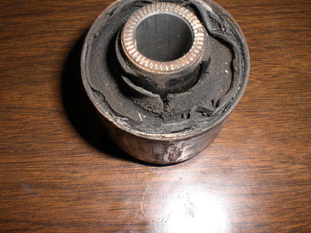

    Looks like you replaced the front torsion bar bushings on that other thread....
    and thats a big deal on 5 luggers, if those are worn, the whole front wheel tri-angle will move back and forth.
    That will wreck all kinds of havoc on the upper/lower, control arms and bushings.
    The lower control arms on 5lug is just a straight piece with a single bushing and needs that torsion arm to control forward and back movement..
    A lot of 5luggers aren't even aware of that torsion bushing...
    On a 27yr old truck....all those rubber bushings are well past their prime....all of them...
    Here's what my torsion bar one looked like after 25yrs....
