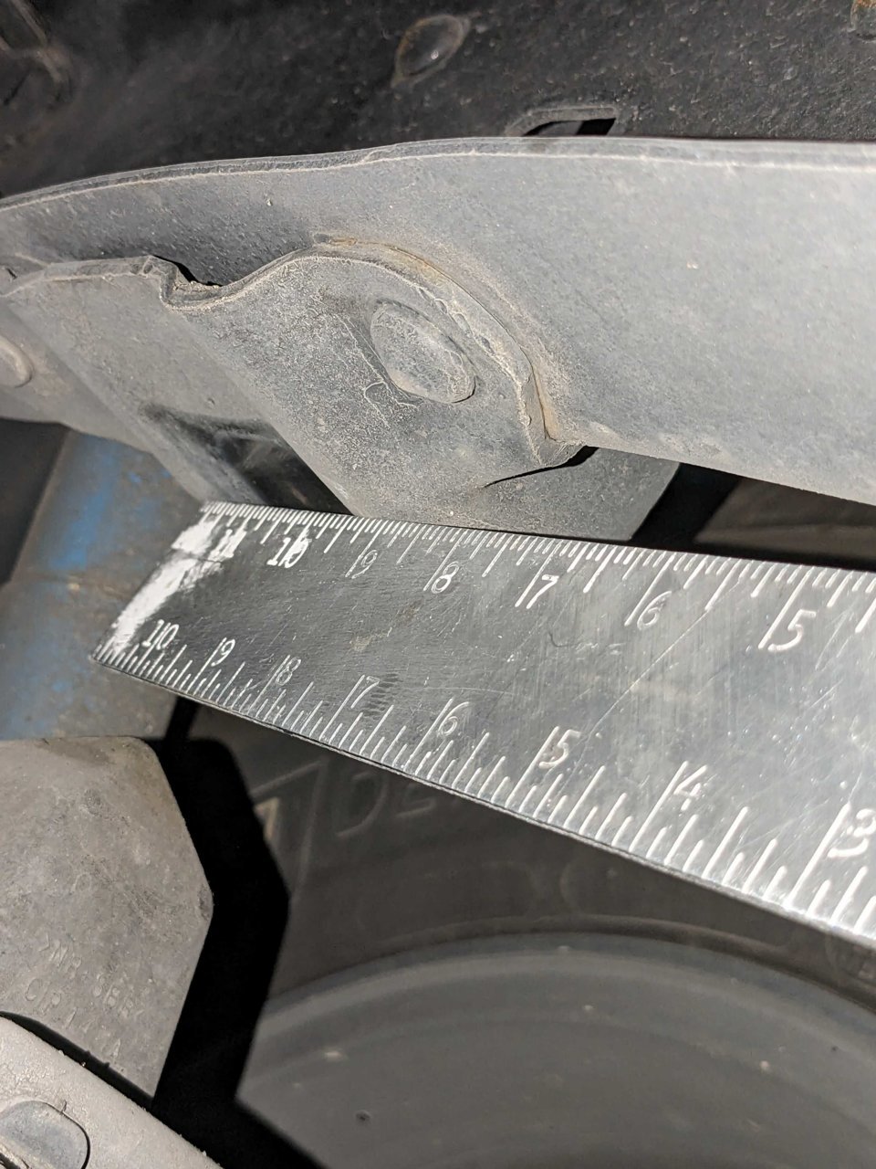

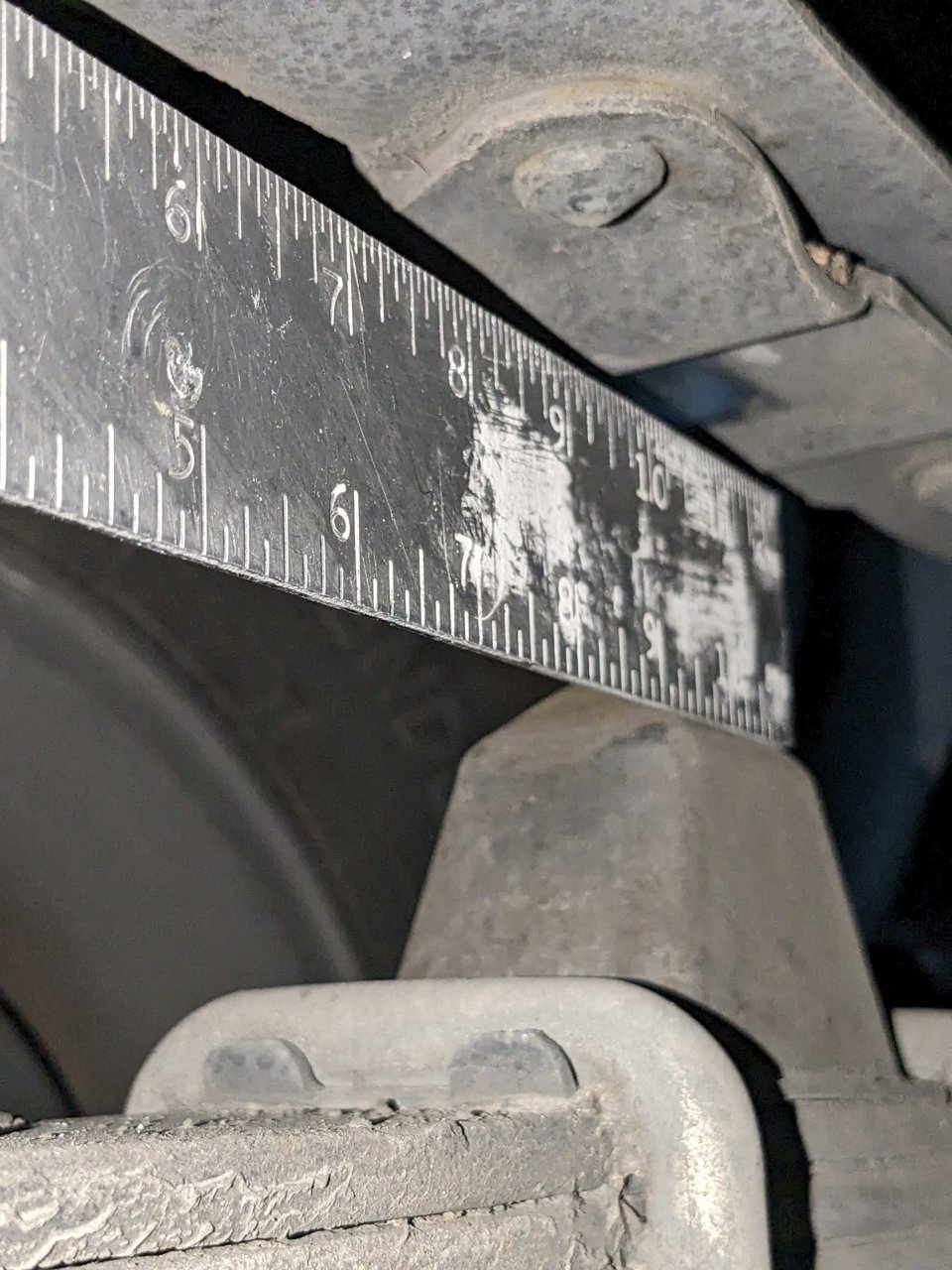

    Take a photo of your rear leaf springs at rest, and if you can how close they are to bump stops.
    I was bottoming out hard in my last truck until I did heavier leaf springs and matched it with OEM upgrade bilstiens.

    That's my left and right side. The ruler is 1.75 inches wide. My driveway has a bit of twist and I'm going to say that's why the left and right aren't equal.
    Any idea what this distance should be?
