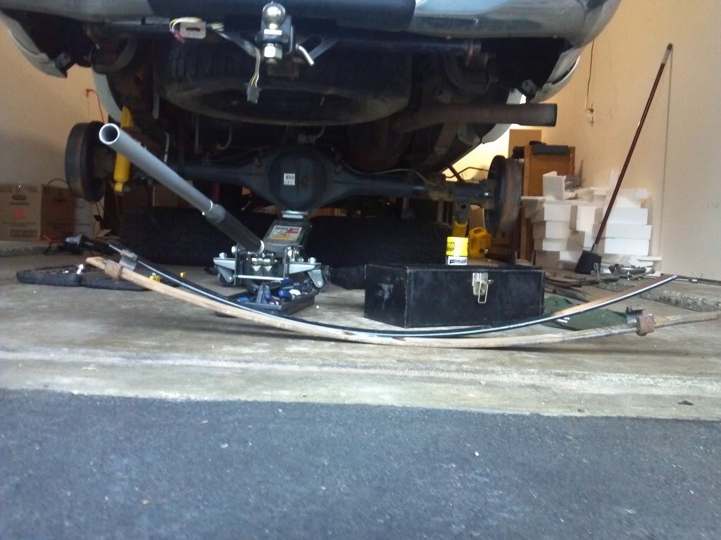

    My truck recently started bottoming out on the rear axle. And if you look at the truck from behind, it appears to tilt to the left.
    I am trying to determine if it is a problem with the shocks or leaf springs. I have done the weight test and I don't think it is the shocks.
    The leafs have some gaps between them on the ends. Is that normal?
    I took some pics of the leafs. Take a look at them and let me know what you think.
    If its the shocks, I can change those, if the leafs, Ill need to get it fixed. Any advise on that?
    Thanks for the help!

    All the heavy items are on the drivers side, battery, gas tank, you. The rear leafs are weak as crap as well. Check into the TSB springs, OMD leaf swap, or upgrading to aftermarket.

    They look normal.

    How many miles do you have on your truck and have you hauled heavy things? Like sandman said the stock leaf packs are weak.
    Edit: forgot to mention yours look just like mine.

    Negative ghost writer. The shocks don't keep your ass in the air, that's the springs job. The shocks keep you tires on the road by dampening the spring.
    Here's a Toyota Secondary flat/weak leaf next to the chevy leaf I replaced it with. Big difference.
