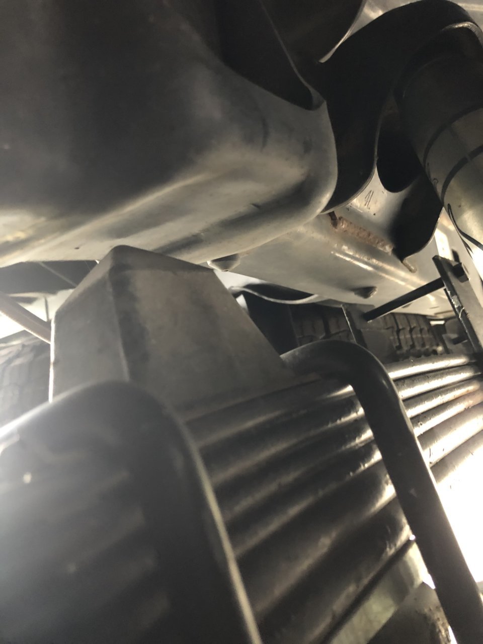

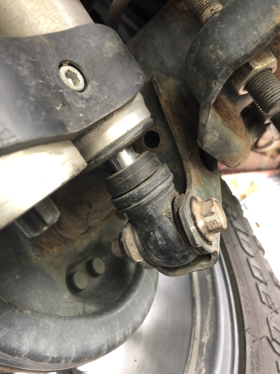

    if you care to read the full explanation, here it is. So In the pictures you can see the shock is just about fully compressed. You’ll also see the bump stop about a quarter inch from the frame. This looks way to close for comfort. I’d imagine the shock would bottom out before the bumpstop is fully compressed. I’m assuming the shocks are a little long for this application. Fox’s website says they’re for a 3.5-5” lift setup. I’m only at about 2.5” loaded with my usual 150lbs in the bed. It was part of a headstrong kit so I didn’t think much of it. I fully intend on keeping the shocks because the droop is pretty insane so I’m assuming the only other option is bumpstops. Iv taken some pretty good bumps on the highway and the frame doesn’t look like the bumpstop has hit it yet so I can only assuming, I’m Fully compressing the shock. Any advice would be great. Thanks for looking

    Yes, you definitely want to space up the bumpstop. Have you felt any jarring hits yet? Hopefully not

    Those shocks look a little long to me. You said you have 2.5" in the rear, it doesn't look like it, by how close your bump stop is to hitting. I have 2.75" lift in the rear and I have way more than a 1/4" between my bump stop and frame. Yours looks a little too close for comfort for me, especially off road.

    Is that a little built in bump on your shock? You could easily zip tie a block of wood or a hockey puck on the top part (frame side) until you decide what way you are gonna go.

    I've always considered the rubber bumps on shocks like that as the emergency "shit I fucked up" bump.
    When accounting shock travel vs bump travel, I measure the shock travel I have minus that bump.

    I'm assuming his pic is at full compression... if not, there's big problems.

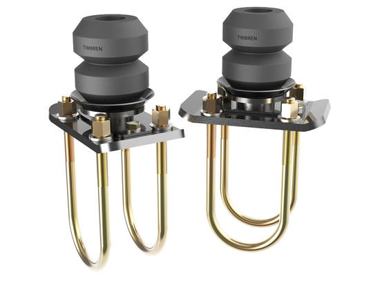

    i have sumos on currently and they don't have flipped u bolts, but the bracket is low profile, i have those Timbrens on my garage floor ready to go in. excited to try them and drop the bucking i get at high speed with the sumos.

    That’s as compressed as I could get it. I have the passanger side front tire on a hill so the drivers rear is as compressed as I could get it in the driveway. So those pictures is with that tire tucked into the wheel well. It was just meant to show the shock travel left with how far away the bump stop is
    yea. It’s a little quarter inch think rubber pad. I guess that’s designed to act as a last line of defense before jamming the piston into the top of the shock

    Glad you said that. I've been thinking about doing Timbrens or Sumos... If the Sumos buck like that, they are out of the equation.

    But that was my concern, that the shock is almost bottomed out and the bump stop isn’t all that close to even contacting the frame. Let alone compressing enough to stop the axle from moving up further
