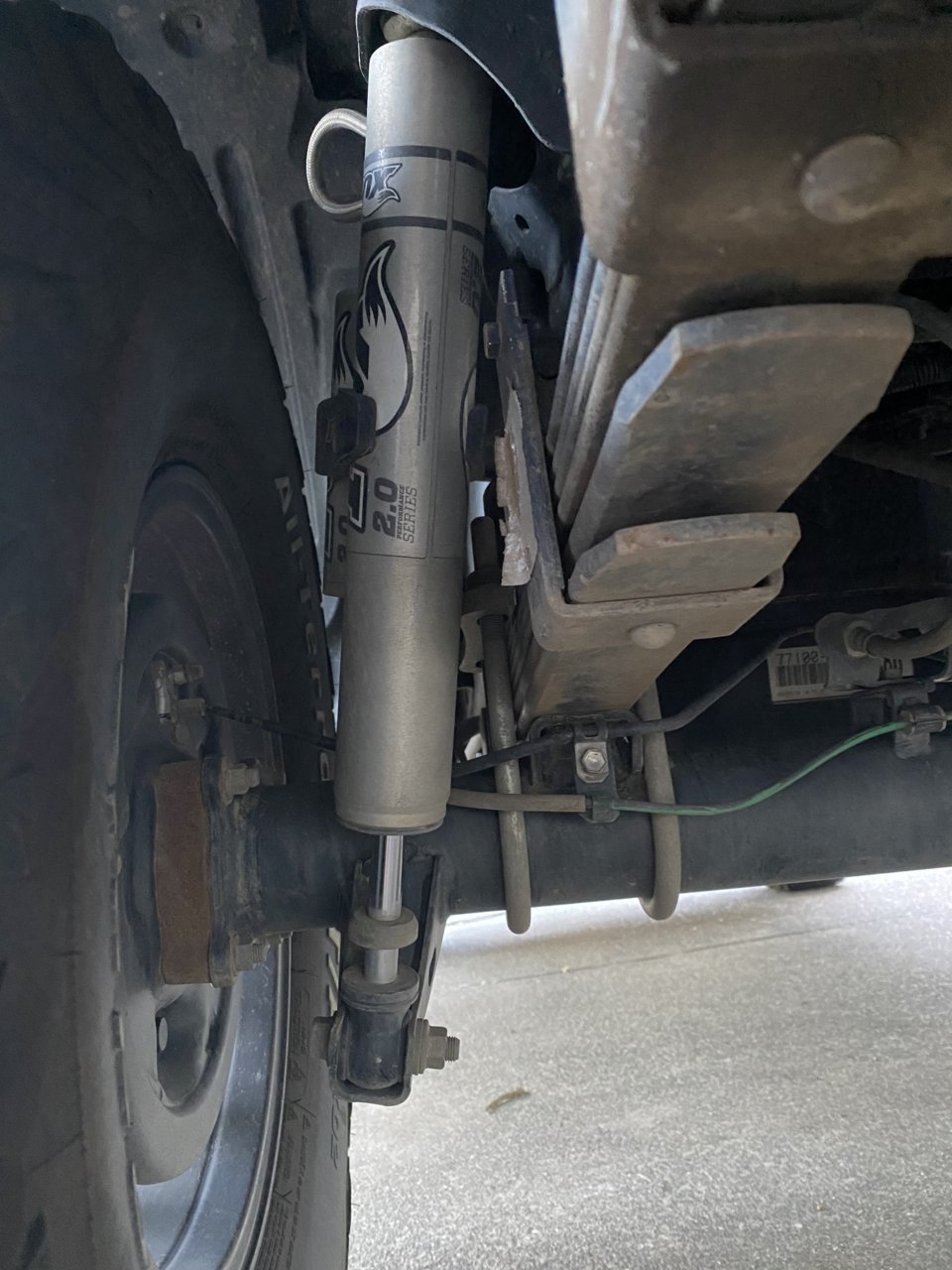

    I want what he has! Gimme the deets. What kit is this?

    Edit: just saw what’s actually going on.
    I have the same rear Leaf pack and shocks as you @Tacoclifford and the superbumps with ubolt flip kit is perfect for the setup. They bump to about 1/2” of bottoming out The shock. Doesn’t get much closer than that.

    the pictures isn’t ride height. Iv got a steep hill on the side of my driveway. I parked with the passanger front tire on the hill and the rest of the truck on the flat driveway so that I can get the drivers rear as close to bottomed out as possible. The picture is with the drivers rear tire crammed into the wheel well. Iv got the same up travel as you

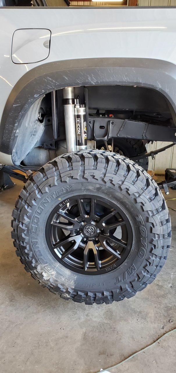

    HI ex GM engineer that worked on the Zr2 race program- you never want the shock to stop first. this will definitely shorten the lift of those shocks. most REAR tacoma lifts are for 2inchs of rear lift with 3 up front to level the truck. with that you should be using the 2-3 inches of rear lift shocks (fox PN-985-26-117) below i listed the fox shocks dimensions. i would not sell a customer a 118 unless they had a block on top of a +2 spring. or a extra large bump stop. but even the super bumps are designed to eventually compress to stock bump height under hard enough hit (if not its limiting designed travel) im on a custom kit we do for long travel. i have 14.3 inches of rear travel using an icon 2.5 inch piggyback shocks made for a 6in lifted f250 re-vavled to my spec. that compressed WITH full axle articulation (the shock will compress more on one side bc its further out then the bump stop and the axle is using the bump stop as a fulcrum) im about .5inches away from fully compressing that shock.
    2-3inches
    Extended 23.800
    Compressed 14.700
    Travel 9.100
    3-5
    Extended 24.800
    Compressed 15.200
    Travel 9.600

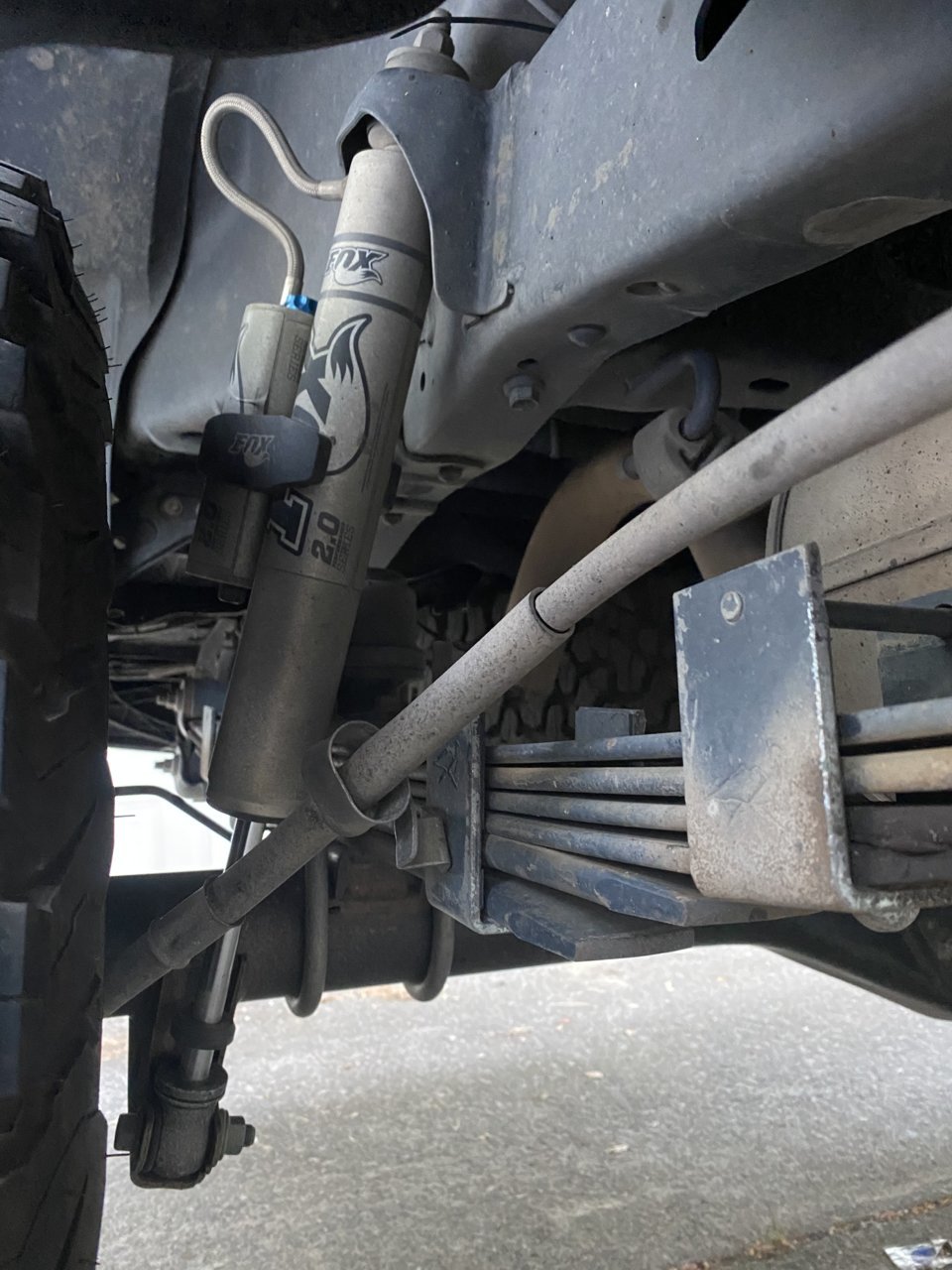

    here my rear shock
