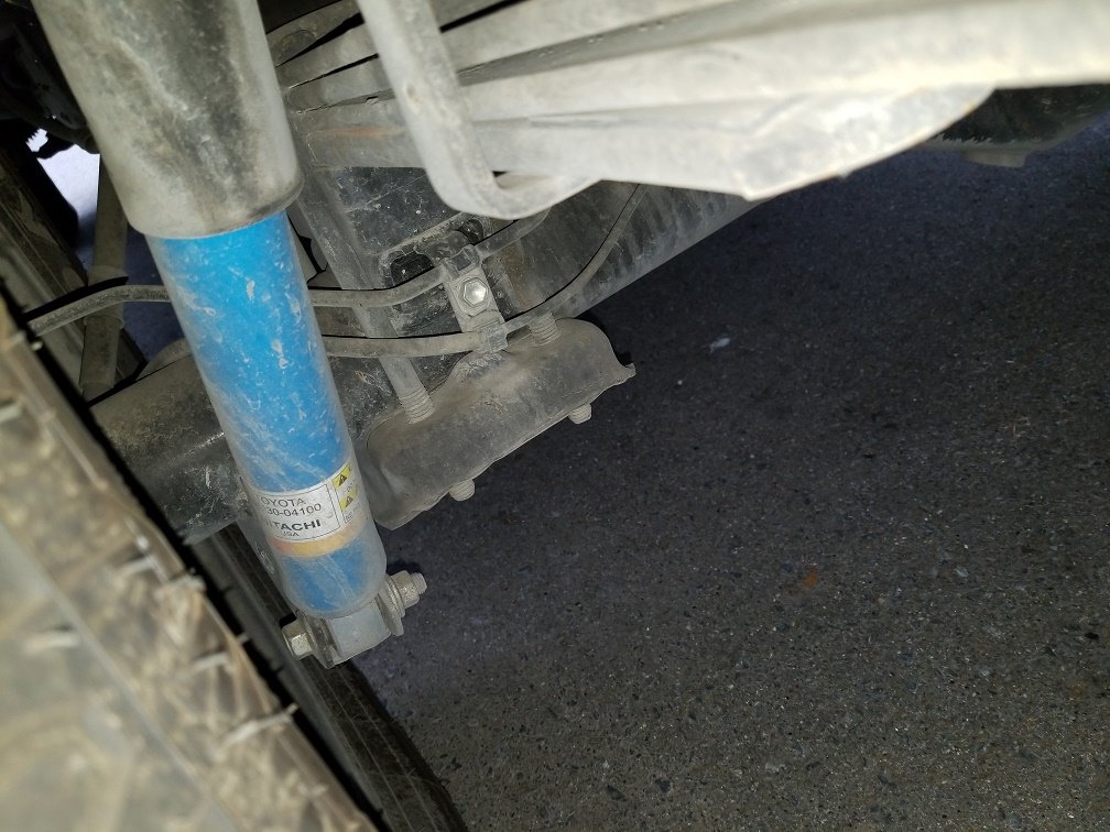

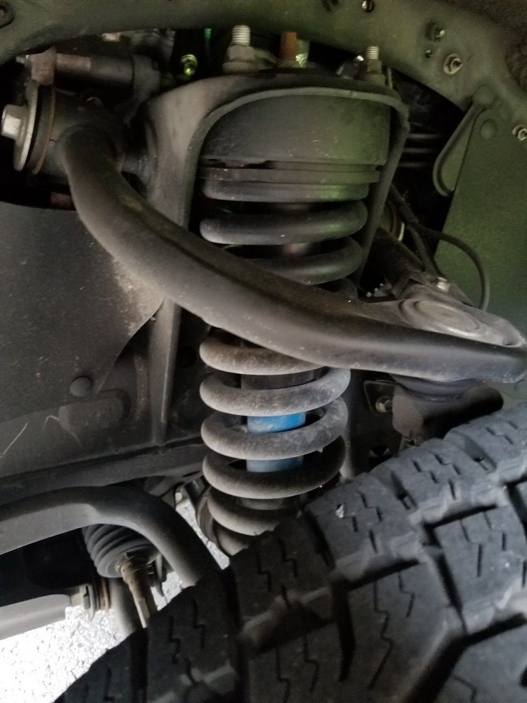

    Question for you guys, i bought my 17 Sport 4x4 used, and the previous owner put a spacers and a block to lift the truck about 3 inches, it is a little nose high, but doesn't bother me as much as knowing that my front shocks have spacers. I wanted to know if i should keep this set up until the shocks eventually give out, or would it benefit me to swap out the spacer, and go with the billies with a 2 inch lift setting? would the ride quality improve, or would i even notice. I do not mind dropping from the 3 inch lift in the front to a 2 since it is nose high. Thanks! Here are picks of what the previous owner had set up.
