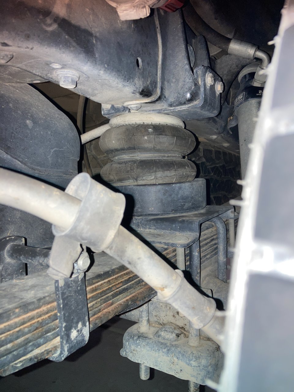

    You won’t notice any difference in sagging with shocks alone. Shock absorbers do just that, absorb shock administered by the terrain instead of transferring it to the chassis. There are many nitrogen and oil filled shocks on the market. KYB or Bilstein are good options for gas shocks that won’t break the bank. But to address the sag, you will need to install bags or alter/replace the leaf pack.

    You can always go with new shocks and upgraded bump stops to help with load carrying if you're not interested in swapping out springs yet. Timbrens, Wheelers super bumps, Sumo springs to name a few

    for @friendswood taco application I second the airbags. 5-15psi around town. Heavy loads, 30-35psi. Add the Daystar cradles and you are good for offroading too.
    the kit for the 3rd gens is like $330
