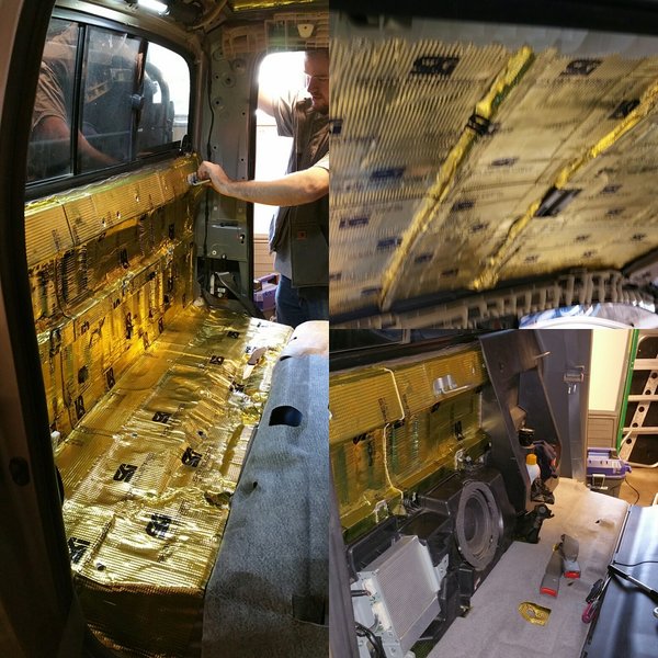

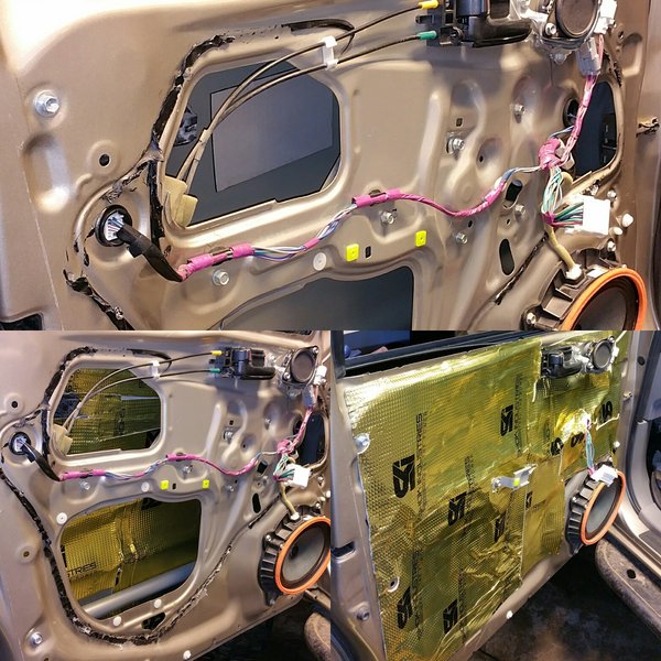

    @CoTacoTRD and I got his truck done today! I'll post some of the pictures I took today and we used up 2 packs perfectly doing 5 in the felling and 5 on the back and the other ten in the doors. The doors were done inside all over and then the panel all over and it came out awesome. It is amazing how well the deadener help the ceiling it was a HUGE improvement over the ping piny sound that it had befor. Very solid. Can't wait to do mine!! Thanks again.
    image.jpg Before image.jpg after.
    All the way down to the cubbys
    Inside one of the doors. image.jpg Out side.

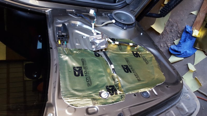

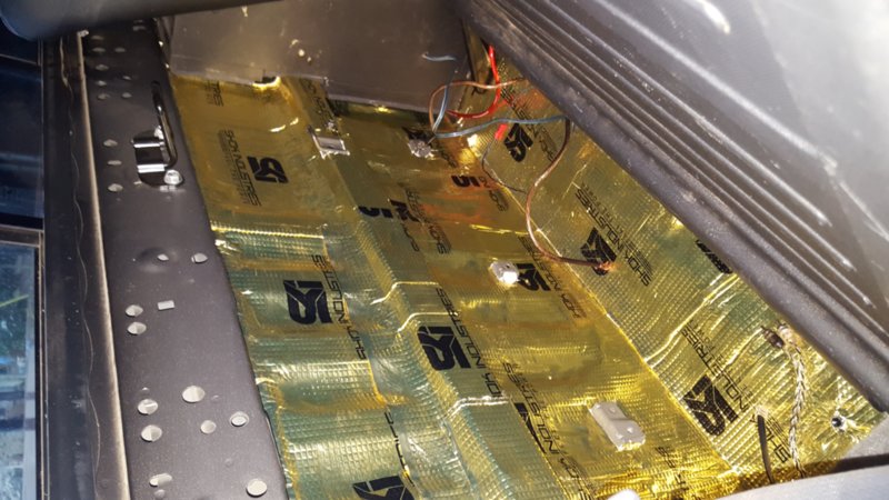

    This stuff is awesome @manethon. Thanks for the group buy.

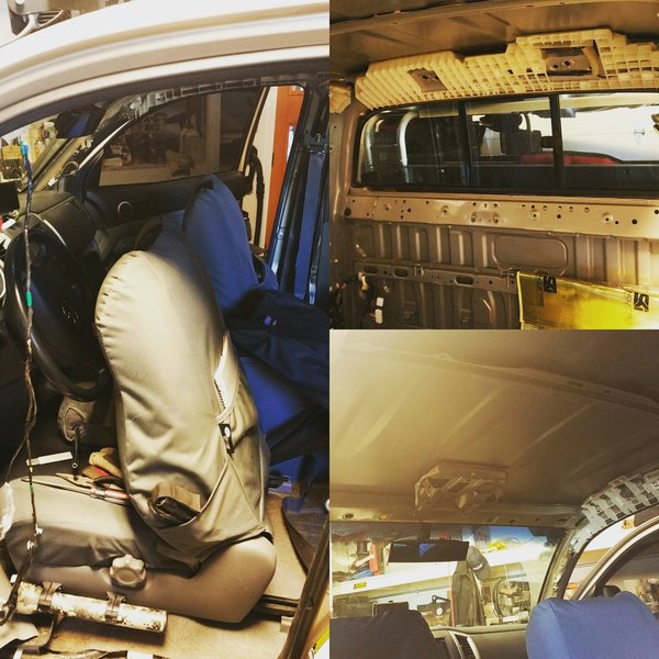

    Bump bump. I got my ceiling installed today it took about 3 and a half hours to pull it all apart and install along with wiring my over head console. There's some pictures. I'll post more when I do the doors.
    @manethon i think I qualify for messiest install too.
    The seams where not rolled down when I took the photo and so that's why some look raised.

    The deadener helped a ton on the sound from my roof rack!!so much quieter. I can here my self think going down the high way. And yah I have one or two keys on there, if I don't have them on me I'll loose them. :anonymous:

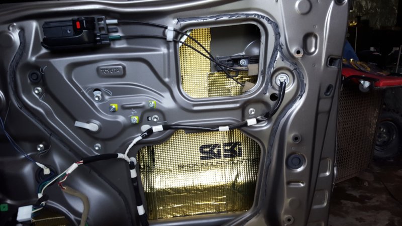

    Just finished deadening the back wall and the rear doors.
    Used almost all of 1 pack, and covered the part of the floor in front of the back wall as well. Noticed a big difference when covered the back wall, less so on the doors. I'm defiantly going to buy a more packs on the next sale. Does anyone know how many packs to cover the floor and front doors offhand.
