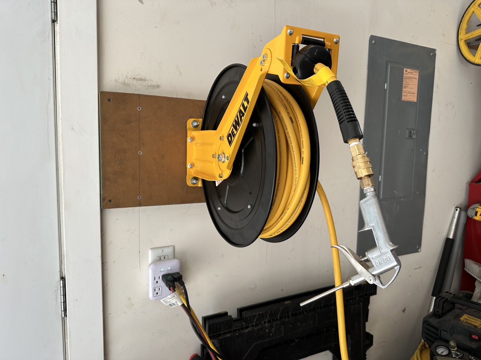

    How big is your garage? Bigger is better but this size compressor and a sand blaster is going to take up some decent space in a standard size garage.
    I have a small pancake compressor mounted on a shelf with a retractable reel I use for dusting things. Sure i have to take breaks some times but i can’t justify the time and cost of what you are planning.
