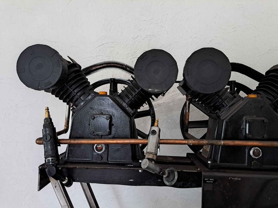

    Just found this beauty on FB marketplace for $600 :rofl:
    445562574_7616240925122299_9259464628917_67c6036ea530399063d75c2f1bf7dddb146def2f.jpg
    443006837_505760151878874_26302636100689_d4ee7b825b760429a6ebc1586492d0b086bdfc93.jpg

    hopefully that picture is in your garage! there's an extra $200 in material into that one!

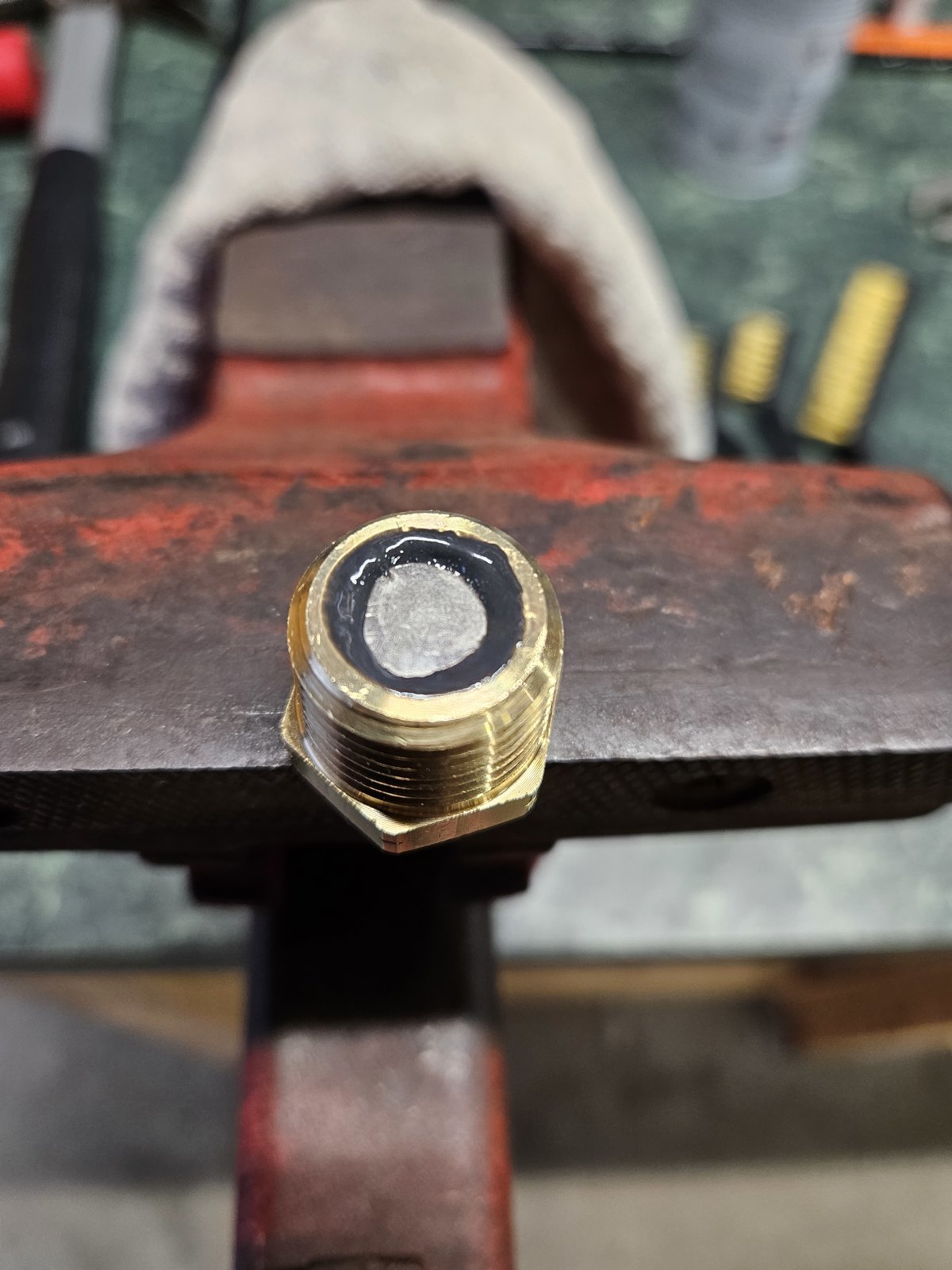

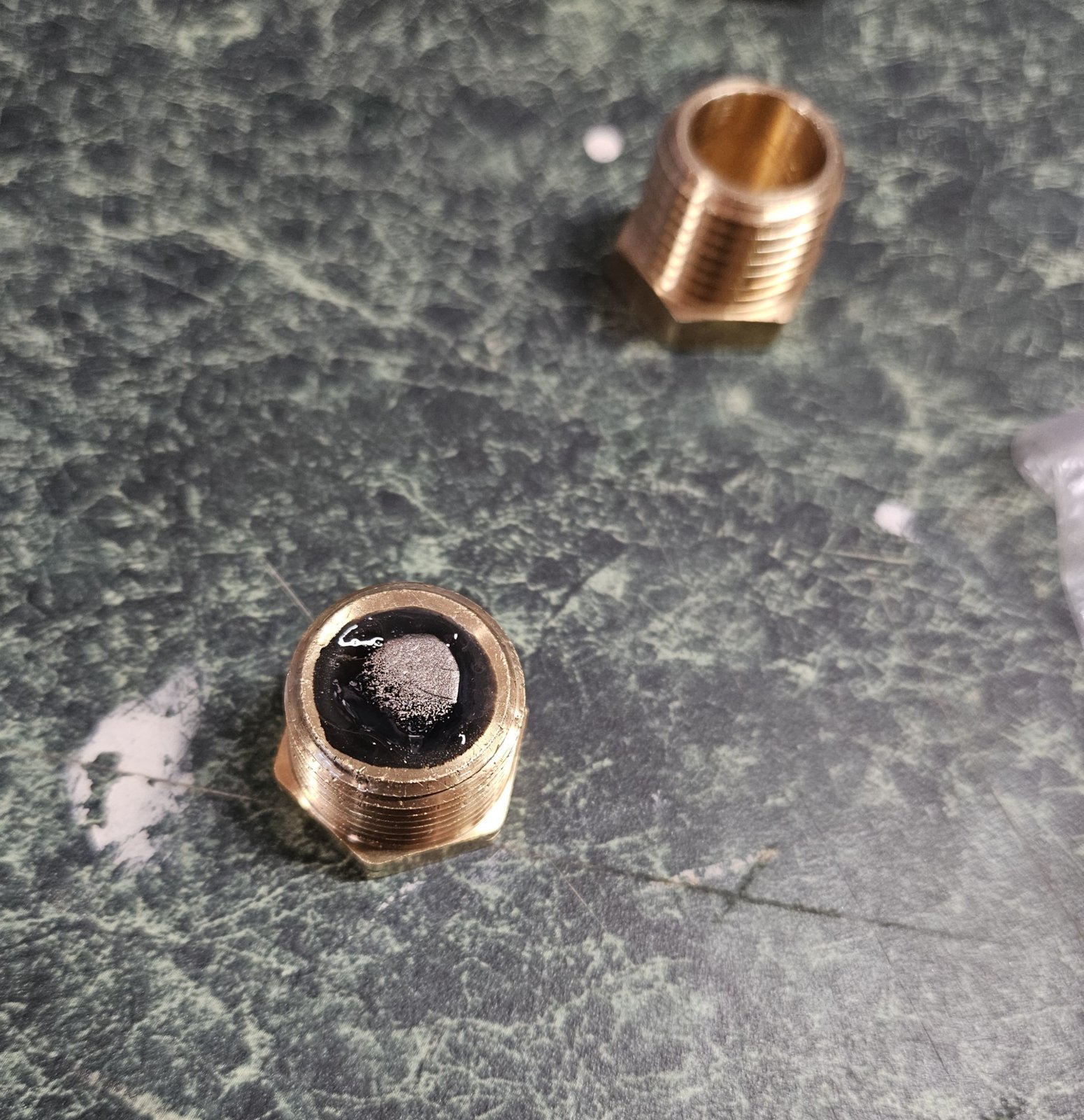

    Decided to change the oil in my little one while Im still using it. Couldn't find a 1/2" MIP magnetic drain plug anywhere so I made one with some JB weld and a neodymium magnet. Honestly I should have done that a long time ago. Last pic is after just 5 mins run time

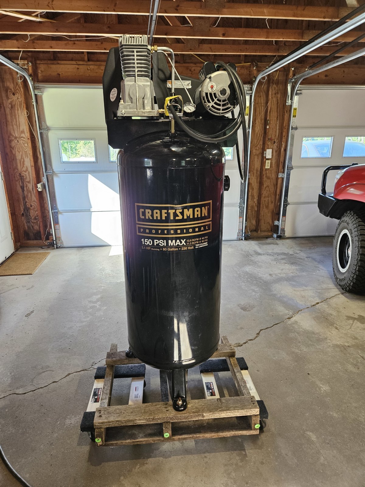

    Manufactured in 2015 according to the tank nameplate. Been sitting in an old gentleman's garage in VT. Never been used or even wired up before I got it, from what I can tell

    Very nice, how much you got it for?
    If your going to bolt it to the concrete you should put a rubber cushion between the feet and concrete, I've seen people use cut up pieces of tires.

    $500
    I do have three isolation pads on order. Didn't have anything suitable laying around. Plan to put it on those in the corner. Dont think I will bolt it to the floor though, Im hoping the rubber will be enough to keep it in place.

    I have the exact same one except the tank is red. Mine is still bolted to the pallet it came on, hasn't moved yet :thumbsup:
