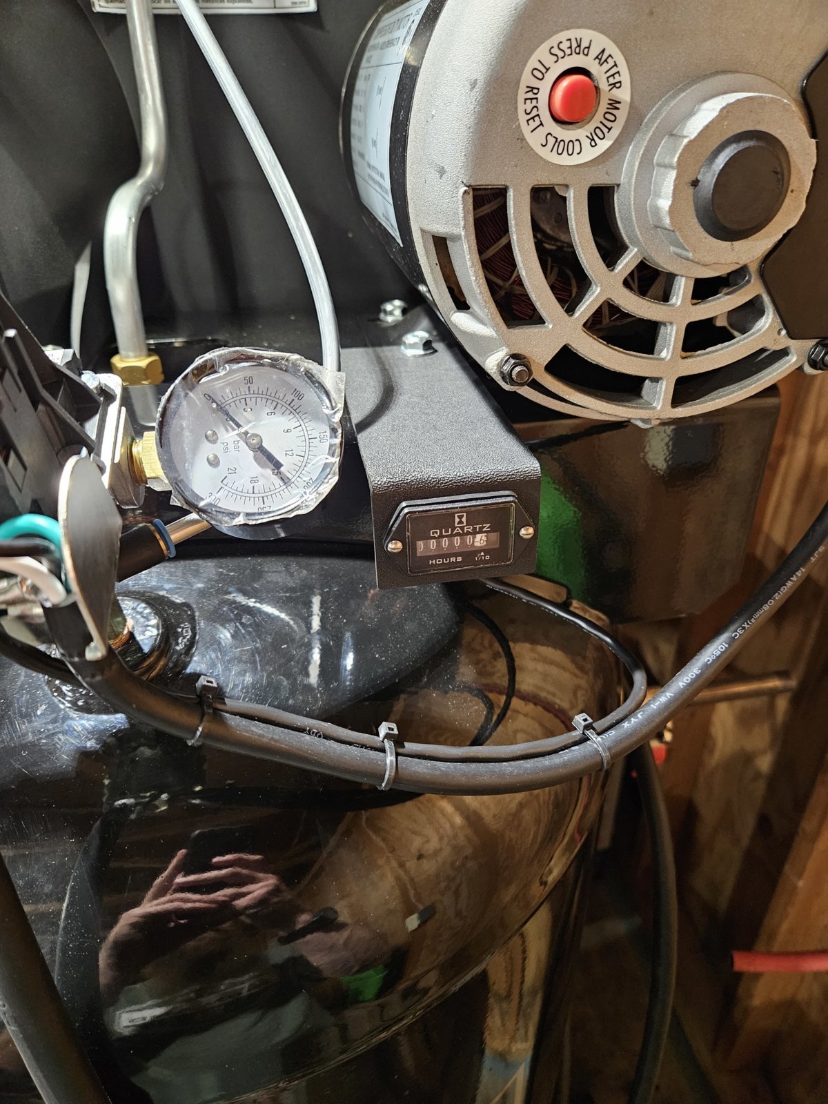

    Took a while but finally got it all setup. For now..

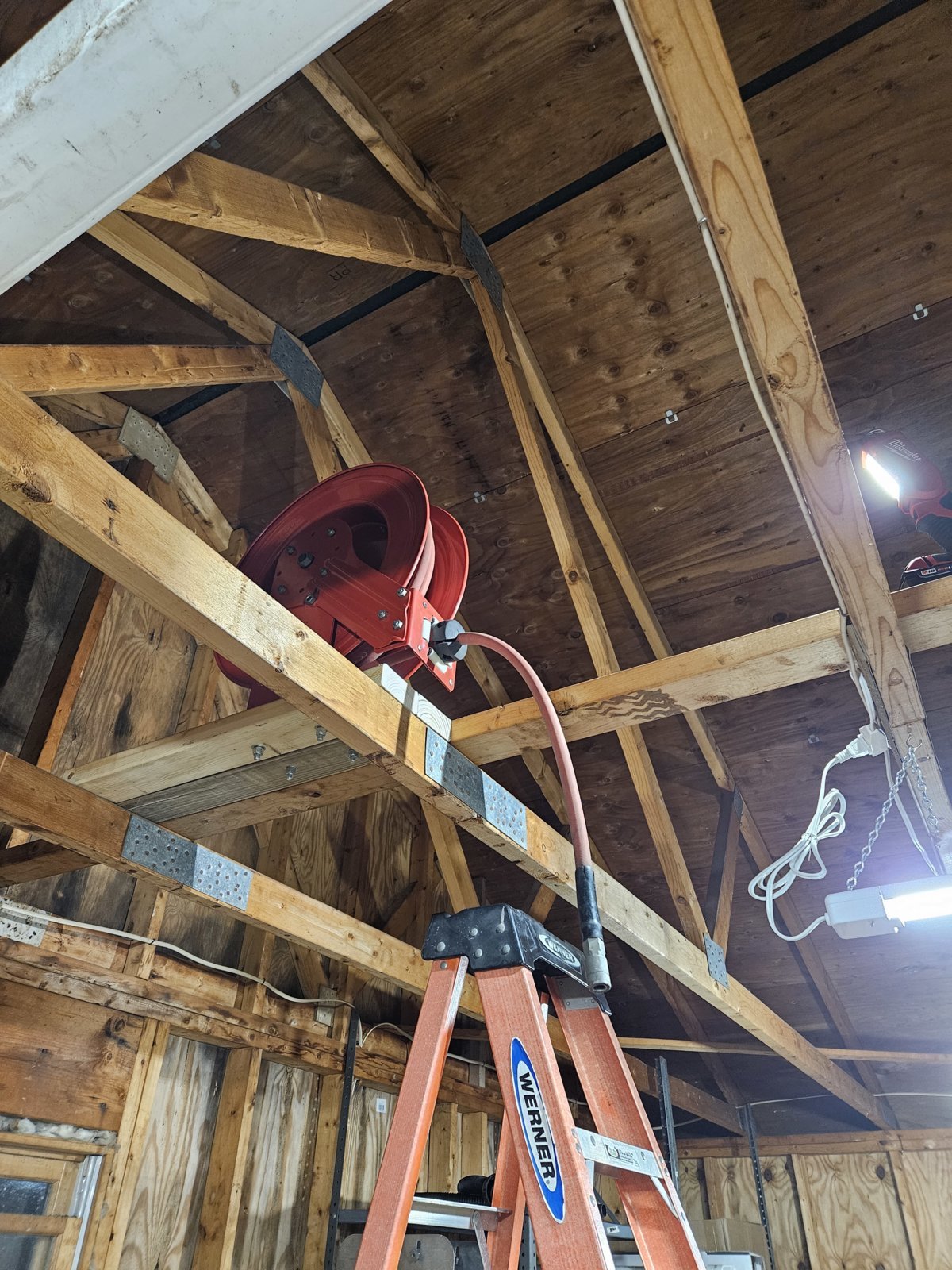

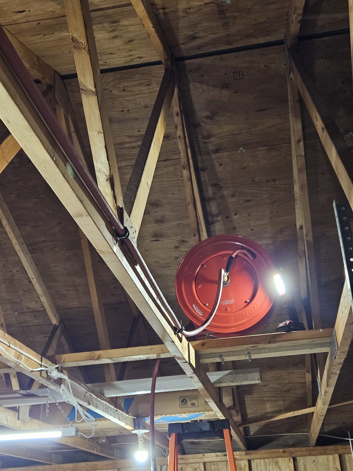

    Air reel mounted up in the rafters. All 3/8" rubber line from filter/regulator output to the reel, only one 1/4" fitting right where it enters the reel. Went with a Merlin 40 micron filter & regulator followed up with a Merlin 5 micron filter. Both from Harbor Freight. Impressed with them so far. Only have about an hour of run time on them but they've caught a decent amount of moisture. No pics of those, but I mounted them directly on the output post shutoff with steel nipples. Might move them to the wall eventually to save space, not sure.

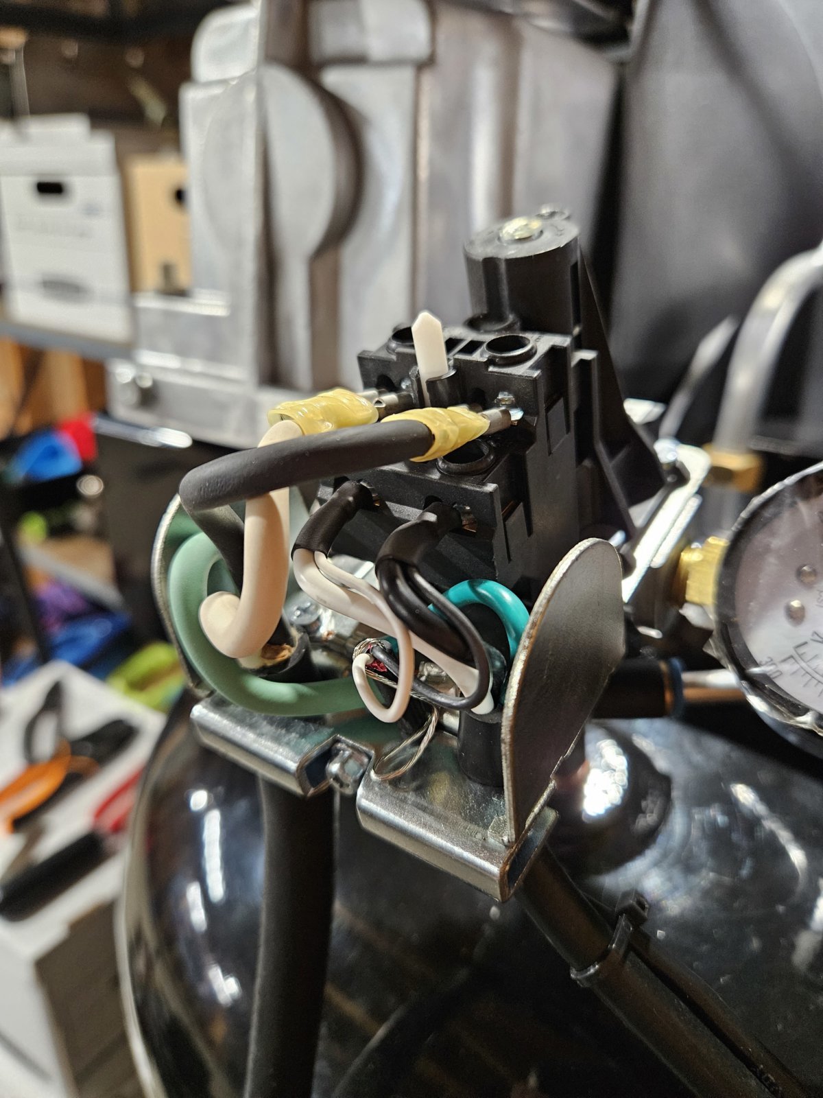

    Speaking of run time, added a mechanical hour meter on the switched side of the pressure switch. Cause why not for a new machine :D

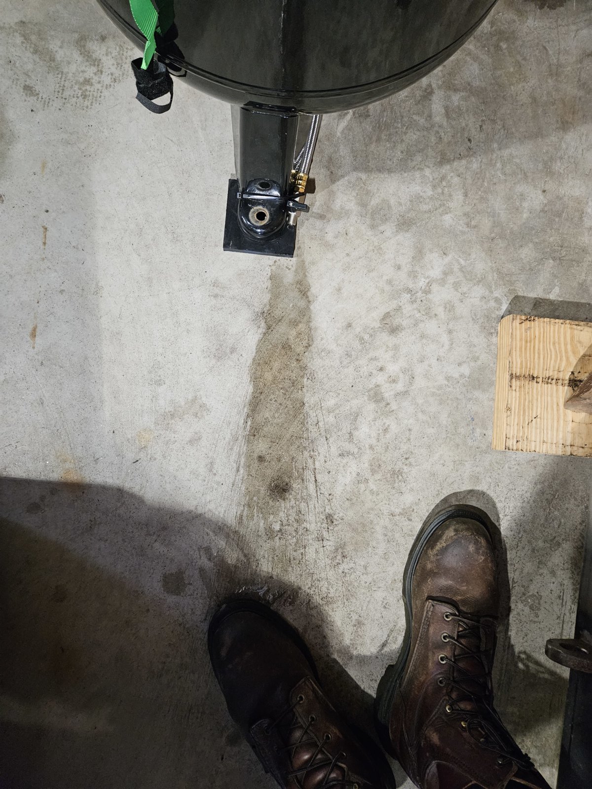

    Lastly, an extended tank drain. Highly recommend. PowerMate 072-0023RP. Caught way more water in the bottom of the tank than I would have expected

    What are you using for the hour meter signal? I am use to the ones on engines where it wraps around the spark plug wire.

    Just straight line to line AC voltage to power it
    TruMeter model 722-0001
