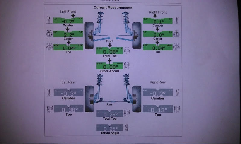

    Can't remember exactly, but everything was in spec besides the camber. That is why the outsides of my tires were wearing. Here is my alignment now with LR UCA's

    if you get the caster to 2.5-3*, you'd have less rubbing.

    Thanks. I'll probably go back up there tomorrow, and see if they can do this.
