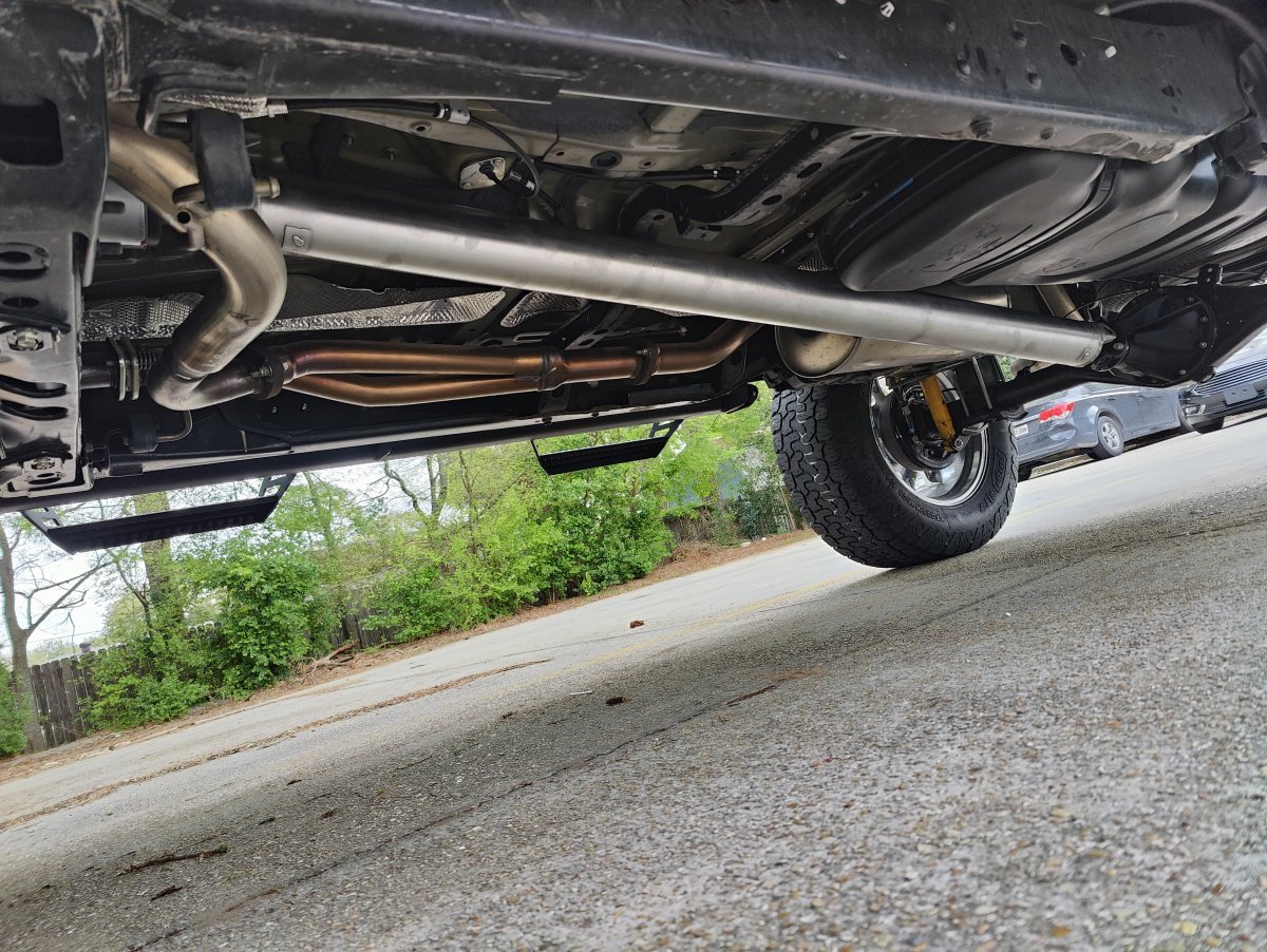

    Interesting, other than weight savings what else does this offer?

    Probably should have spent that money on new tires. :eek::eek::eek:

    Yah, it's getting close for new set of those too! But solving all the Tacoma driveline issues is a must! No more axel wrap, vibrations, dealing with center bearing, etc... On my 2nd gen I spent more on carrier bearings and other fixes than it ended up costing me to go get a drive shaft made. So on this one, I skipped all the BS and just had one made :)

    Hope it works out. There is a reason Toyota designed it the way they did. I'm sure it would have been a lot cheaper for them to go that route.

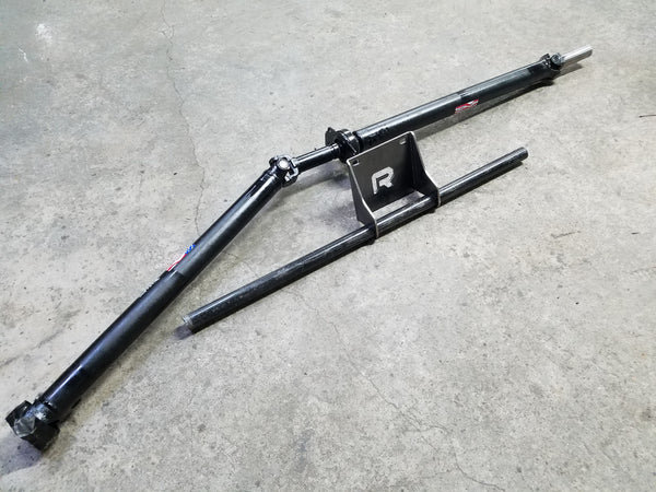

    I know nothing about nothing, but looks like 2 piece driveshaft tucks in a bit higher, giving it less chance for damage off-road.

    Exactly, build a 2 piece DS with a CV, reinforce the CB mount and go with a TCCB. Tucks up out of the way and is almost bullet proof. 1 piece hangs to low and will get all bent up when transversing over a ledge.

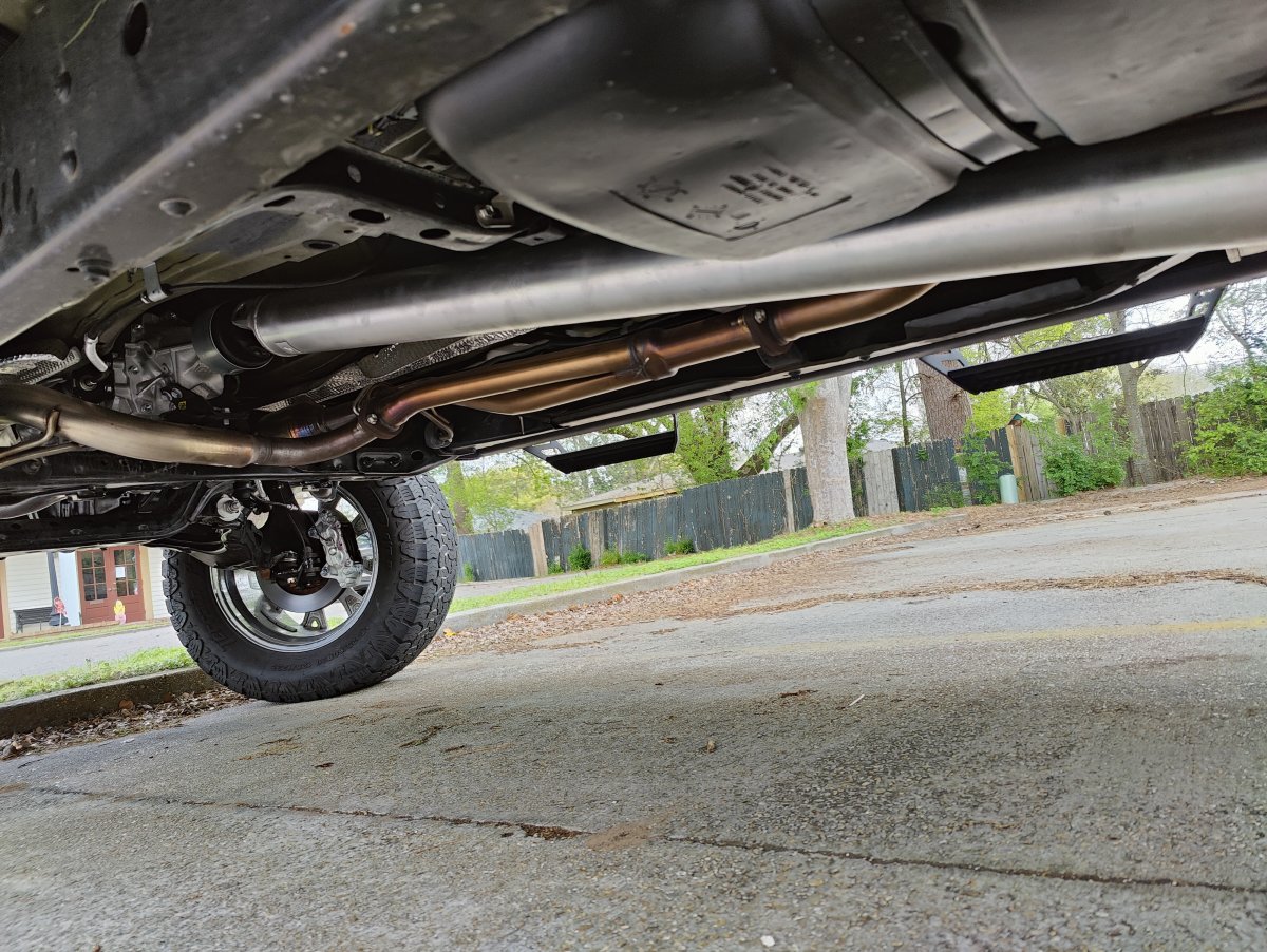

    Make sure to check with interference with the brace (for seat belts) behind the stock carrier bearing cross member. I had a one piece and it would rub on it slightly during rear suspension compression.

    Here's an example of what I am talking about.

    you have not been around very long have you? lol! the 2 piece drive shaft is a known issue especially once your lifted. Once you get to about 6 inches a new drive shaft is manditory, look at your center bearing its being pulled.

    it will be fine, I have the same on on my 2nd gen, once you get to 6"+ lift there is plenty of room.

    2023 TRD Sport
