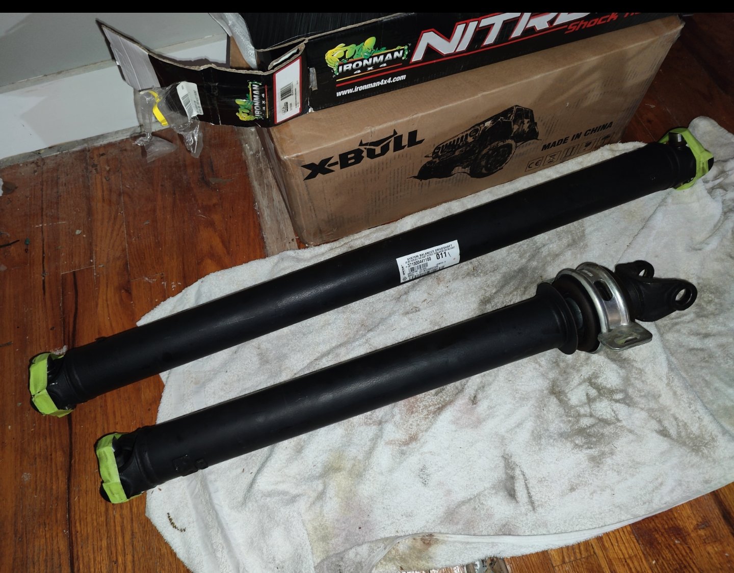

    jboudreaux1965
    jboudreaux1965 [OP] Ragin Cajun Fan
    Jun 2, 2014
    #131162
    3,826
    Joseph
    Hub City
    2023 TRD Sport
    I beg to differ, it is the opposite. Put a 6" lift and go flexing. Your carrier bearing will be about to pop out the back of the seal. An easy test if your 6"+ unbolt the driveshaft, watch how much it gets pulled away once the bind is taken off of the carrier bearing.
    exact opposite, it is much harder to get drivelines correct on a 2 piece, do some reading.
    pdxTacoSR5 and ace96 like this.
  7. Mar 14, 2024 at 3:51 PM
    #27
    jboudreaux1965
    Jun 2, 2014
    #131162
    3,826
    Joseph
    Hub City
    2023 TRD Sport
    A steel driveshaft that long would be too much weight, thats why we go aluminum on these. Without the U-Joints and the slip yoke, I can hold the thing in one hand and twirl it.To make it that long they would have to use very expensive aluminum tubing, (aluminum custom made ain't cheap) plus going aluminum you have to use larger diameter tubing, without a lift you could have rubbing issues, but they could fix that by adjusting the body design.

    Hub City
    2023 TRD Sport
    Stops the jerk when you come to a stop. The carrier is holding tension and the springs haven't totally unloaded when you stop. Then the carrier unloads and you feel the jerk. Thats what i was referring to. You will have some axel wrap with heavy tires and alot of power no matter what with normal leaf setup, i know that.

    Hub City
    2023 TRD Sport
    Completely from scratch, (rough estimates because it costs by the inch for that tubing) all aluminum For PreRunners about $950 for 4WD he custom builds the slip spline so about $1,200. If you pay cash won't charge taxes so that knocks some off the total :)
    The machined aluminum ends that are welded to the tubing where the U-Joint connects alone are about $400. The tubing for mine was $170, then add U-Joints and labor to weld and balance...

    jboudreaux1965
    Jun 2, 2014
    #131162
    3,826
    Joseph
    Hub City
    2023 TRD Sport
    I know the slip yoke is on the transmission. When you have a 2 piece drive shaft the part between the transmission has limited amount it can slip. After that the carrier bearing starts to get pulled. I wish I would have taken a pic before I pulled my 2 piece off so you would understand. At rest, the carrier bearing was being pulled so much the boot was bulging out. With 6" of lift, when the measured it, the 2 piece driveshaft was about 1.5 inches to short. To bolt it back to the differential you had to pull the sh$t out of it to get the bolts in. So under flex it's even worse.
    Even with a 4WD the slip in the rear shaft only gives you extra distance between the carrier bearing and the differential. So you won't have as much constant load binding, BUT with a 2 piece and with a 6" lift good luck getting your driveline straight again!
    Have fun with your shims and drop brackets, etc... that never ends up correct anyway
    After 8 put the 6" lift on my 2nd gen, Before I had the one piece driveshaft made I ran GoPro's under the truck for a couple weeks to watch how everything moves under different conditions.
    If you don't have a lift, then don't worry about it, otherwise...
    Keep your 2 piece and have fun with that.

    jboudreaux1965
    Jun 2, 2014
    #131162
    3,826
    Joseph
    Hub City
    2023 TRD Sport
    FYI.... Before at 70MPH the vibrations from the 2 piece would get pretty bad then get worse the faster you went.
    I just did a test run at 95MPH, zero vibrations.
    Remember this only really applies ones you get to 5"+ lift

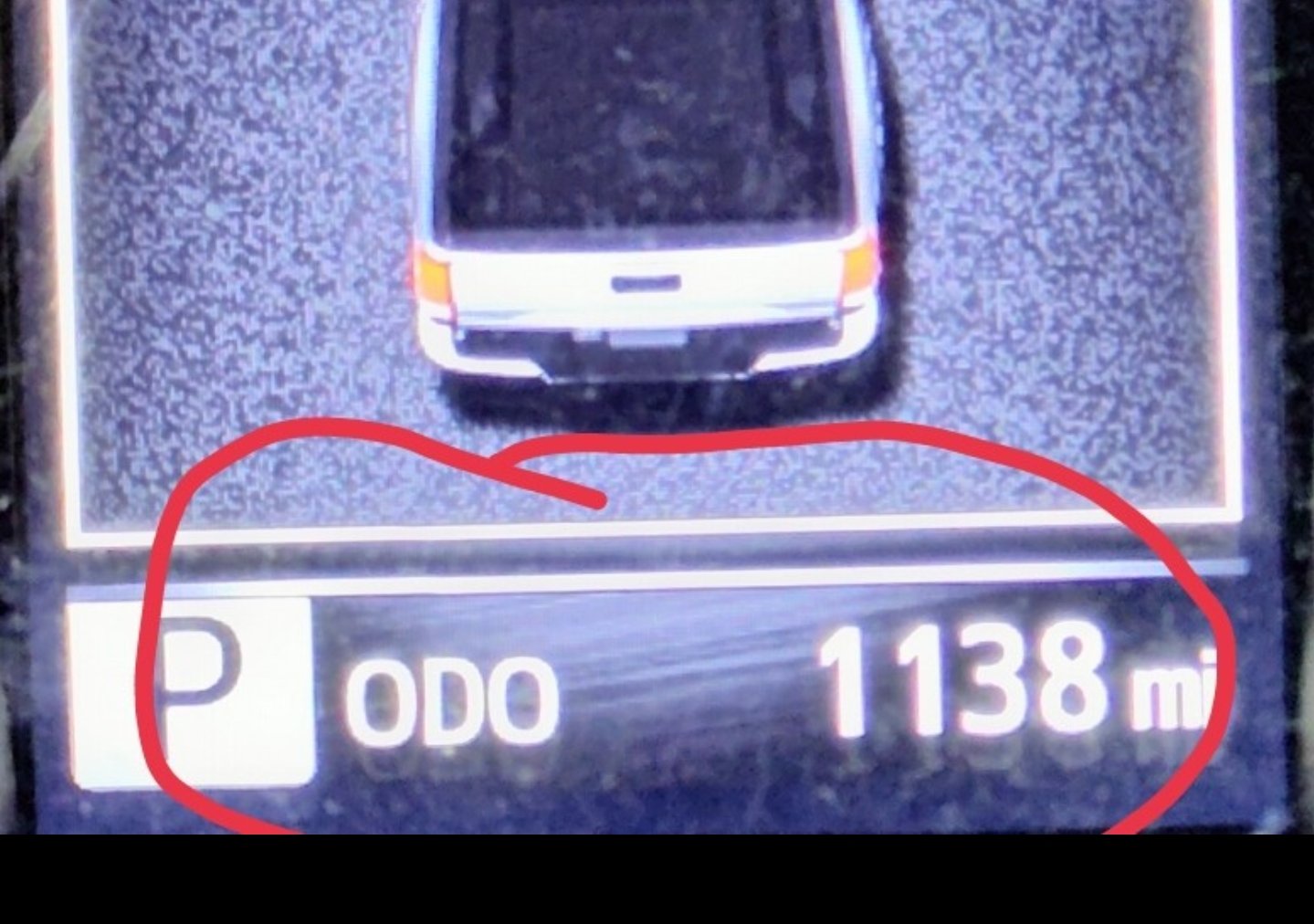

    For all of the 2 piece driveshaft lovers out there, I have a brand new 2023 take off, 1,138 miles on it, sell it to you cheap :)
