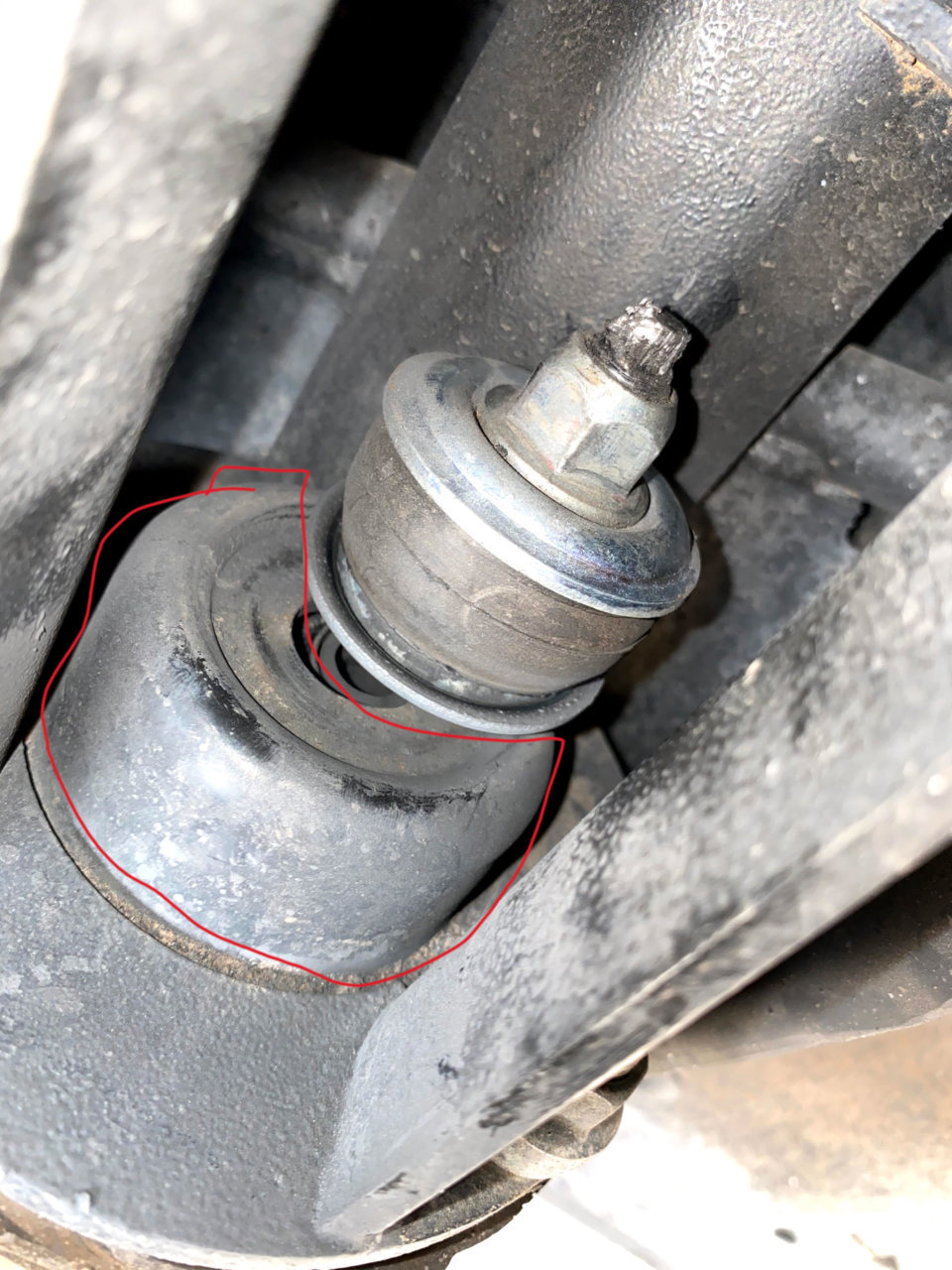

    Hello,
    The front Strut (shock shaft) is loose at the top and has damaged the Strut Mount Kit (top hat). The truck has a Rough Country 6’’lift kit installed with Strut Spacers used instead of lifted struts.
    Since I plan for moderate off-roading, I would like to remove the strut spacers and install two new Coilovers (struts with coils) specifically designed for a 6’’ drop bracket lift . I am not sure if they have to be Rough Country brand or if any brand will do.
    Any shop recommendations near Phoenix Arizona? Thanks for the help!

    Is that picture of your actual truck? The top hat does not appear to be damaged. As for installation, any shop that normally works on lifted trucks can do it. You might want to check with Rough Country about fitment of other brands. They actually have pretty good customer service if you call them. If their shit is proprietary youll likely have to go through 4 Wheel Parts.

    That is the exact shop that I ended up going to earlier today thanks for the recommendation. They ended up ordering me two new 6 inch extended struts from rough country.
    and yes that is a picture of my truck.
