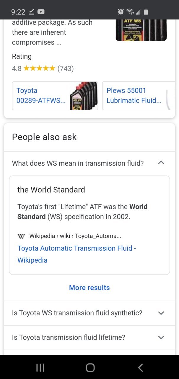

    I believe you are not supposed to change it. WS stands for World Standard and is listed as a "lifetime" transmission fluid.
