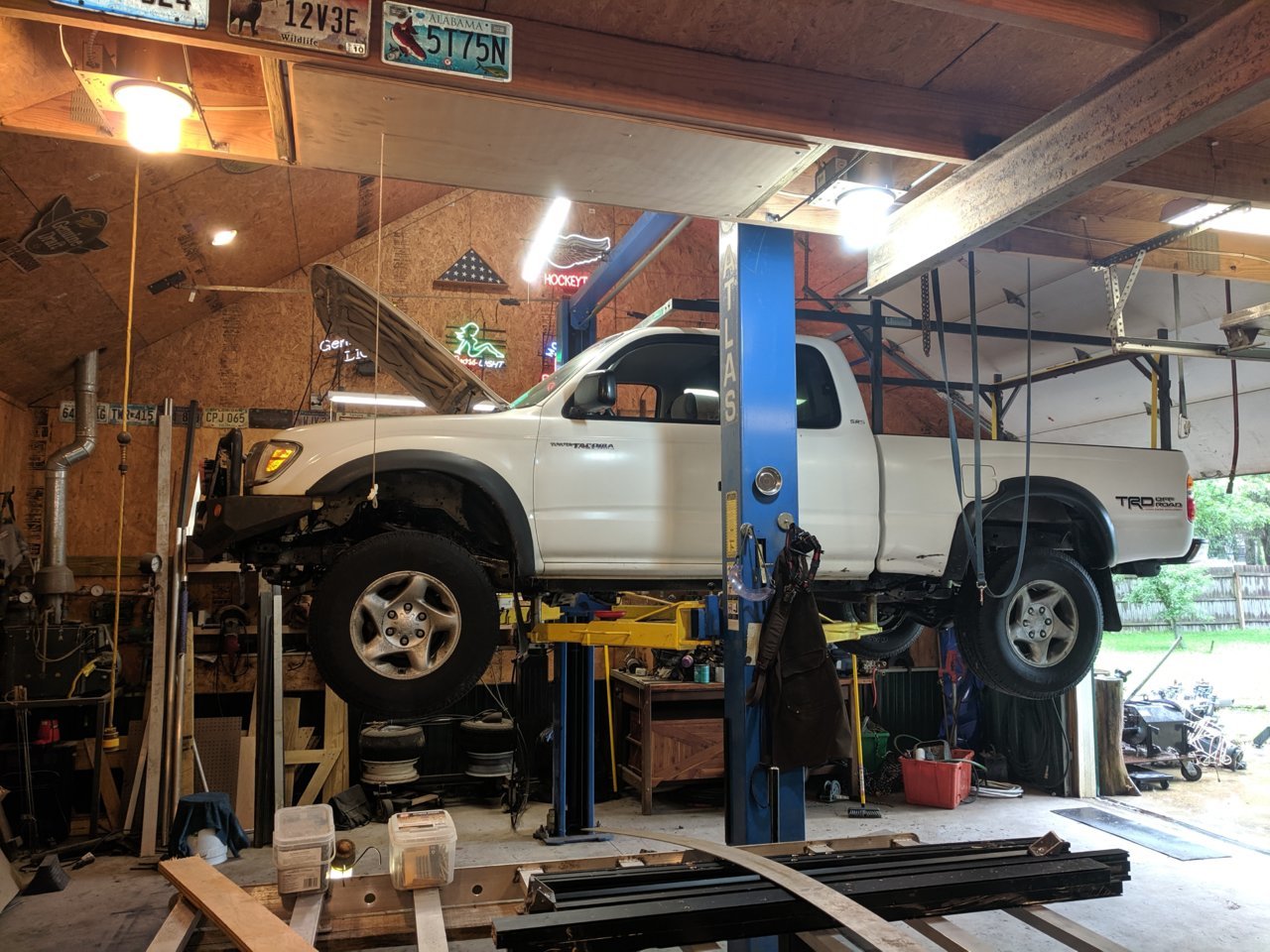

    Would you guys mind throwing up some pics to get my creative juices flowing? :taco:

    Black iron pipe along the ceiling in the upper right of the pic.IMG_20190613_172502.jpg
