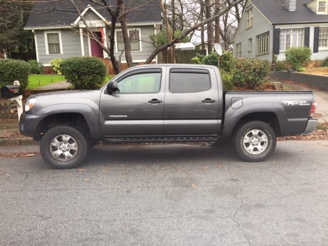

  20. Jan 24, 2017 at 6:10 AM
    #20
    Chrisf06
    Chrisf06 [OP] Well-Known Member
    Jul 20, 2016
    #192446
    1,169
    Bogart, Georgia
    2014 MGM Tacoma DC TRD Off Road
    Before:
    After
    Lost my measurements from before, so not sure total gain... but i do remember i had 3/4 inch rake, and now it sits almost dead level, a little back end high, which is fine, so i assume i probably got the advertised 2" front and 1.5" out (took overload out), or something very close to it.
