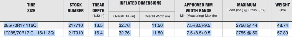

    Hey gang. I could use some opinions on how to proceed.
    I bought my 3G Tacoma around three years ago, and when I bought it, there were already Nitto Trail Grapplers on it (33x12.50R17LT E 120Q). So I'm used to the driving experience of 10-ply rated mud tires on stock gears. Super bumpy, loud at speed, 15 MPG, the decelerating as soon as you let off the gas (without even braking..).
    Fast forward to now.. I wanted to get some new tires that were a better match for my use case. I have to say that the mud tires were fantastic when off-road, but given that this is my only vehicle, I wanted some all-terrain / hybrid tires so I could have a more comfortable driving experience without sacrificing too much of the reliability and off-road performance that the mud tires provided. I decided that 6-ply rated Ridge Grapplers would be the best choice for this.
    Well I went to the shop to pick up my truck yesterday evening, it's dark, I see the tires are on there, all looks fine. I get home and see them in the garage with the lights on, and when I look close enough, these aren't actually the same ones I told the shop to get. Very similar, but not the ones I wanted. The ones they put on were (285/70R17 116Q). The main difference being that one is a passenger rated tire while the other is a light truck rated tire. As Nitto explained to me on the phone, the sidewall of the LT tire is more rugged/durable. Also there's a noticeable difference in the tread depth (see attached spec sheet).
    TL;DR: I purchased a new set of tires + 1 spare from a shop:
    What I requested:
    • 5 x Nitto Ridge Grappler Tire (LT285/70R17 C 116/113Q)
    What they installed:
    • 5 x Nitto Ridge Grappler Tire (285/70R17 116Q)
    What would you do? Try to claw some money back from the shop and live with it? Or try to negotiate with the shop to reconcile?

    Who ever pulled the tires simply pulled the wrong tires, the article number (stock number) is one number off, I have made that mistake as well as I have seen many others do the same over the years, the POS system that we used would have caught the oops when entering the DOT numbers to the government (incase of recall), but most smaller shops will not...
    I agree with TS4x4 above.
    Simply take your invoice with you back to the tire shop and ask to speak to a manager and nicely ask them to take care of it or refund the difference...

    I know the manufacturers make the numbers up, but one thing that stick out to me is the weight capacity. The p-metrics have a 1lbs higher rating at a lower psi. Oddly the p-metrics are 9 lbs heavier. Is that weight from the extra 3/32 of tread? That would add some, but the differences here is really splitting hairs. I seriously doubt they will offer you more than 10% of a refund to keep those tires. They are going to tell you that they are the same and you got what you paid for. Your invoice showing LTs will be your arguing point. If you really want to split hairs, measure the tread on your new tires to see if they are indeed as stated. Often times manufacturers will sell the same tire with different published specs. They do this because car manufacturers will dictate specs for OE tires and that is why you will sometimes see similar tires like this. All specs are nominal and no one verifies them.
    One thing I would do is compare the plys to the P-metric and LT. On the sidewall it will state the number of body plies and tread plies. The LT should have more plies. In the old days this is where the idea of a 6 ply or 8 ply tires was determined. You would have 4 body plies and 2 tread plies to make a 6 ply tire. Modern tires use a rating system. You can have a 6 ply tire that only has 4 physical plies. Anyway, just another thing to compare.

    The p-metrics are 9 lbs lighter, I think you may have mixed up the rows. But that aside, I tried to find out the info on the plies for the LT Ridge Grappler and couldn't find it anywhere. I can only share what I know is true which was printed on the sidewall of the tires I have.
    Ridge Grappler (285/70R17 116Q)
    PLIES:
    Tread: 2 steel, 2 polyester, 1 nylon
    Sidewall: 2 polyester​
    Trail Grappler (33x12.50R17LT E 120Q)
    PLIES:
    Tread: 2 steel, 3 polyester, 2 nylon
    Sidewall: 3 polyester​
    The drive home last night, going from 10-ply mud tires to the 4-ply (I'm assuming?) of the non-LT all-terrain tires, was honestly a crazy difference. I know that's obvious but wow I gotta say it was a much more comfortable ride. Makes me wonder if I should just throw the four mud tires on different set of wheels and just put those on when I plan to go off-road / out in the sticks and just throw them on when I need them.

    A "C" rated tire is considered LT. Apparently you wanted "E" rated tires and there was a miscommunication.
    If you paid for C rated LT tires I'd probably ride with what I have. If you paid for E rated tires and got C rated tires you are due a refund or new tires. If you paid for C rated tires and wanted E rated tires they will probably do it for you, but you will pay extra. As you should.

    That's not what happened though. The invoice says LT because that's what I ordered and paid for. They didn't put LT tires on at all, they put on standard load 28570R17 tires.
