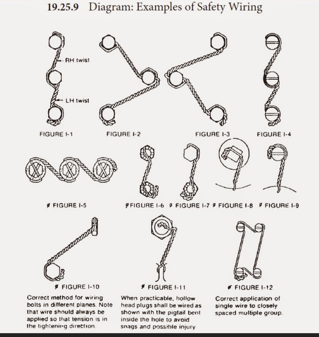

    We used those on aircraft, called them safety wire bolts

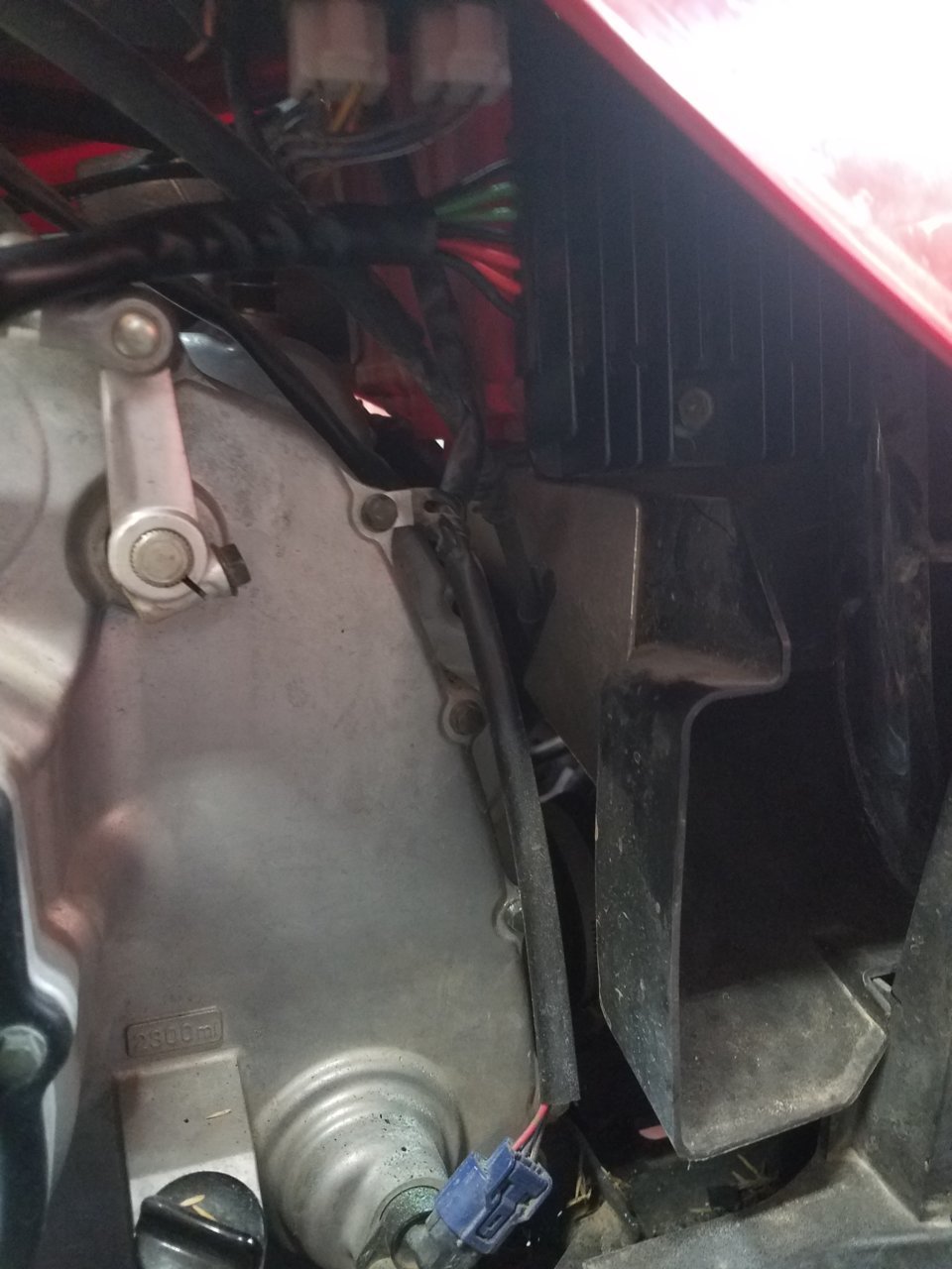

    How about a picture of where it sits on the quad… you can almost see blue corrosion on the wires??

    I'd say that part has been wet before but not since it was practically new. I'm thinking I better look it over real good, the wiring for anything obvious, like rodents or something. I'll report back. My wife is asking for help working on sons car.

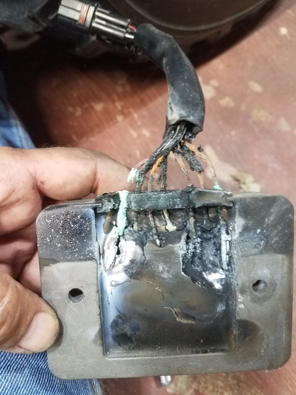

    Does that bolt directly to the engine or alternator?

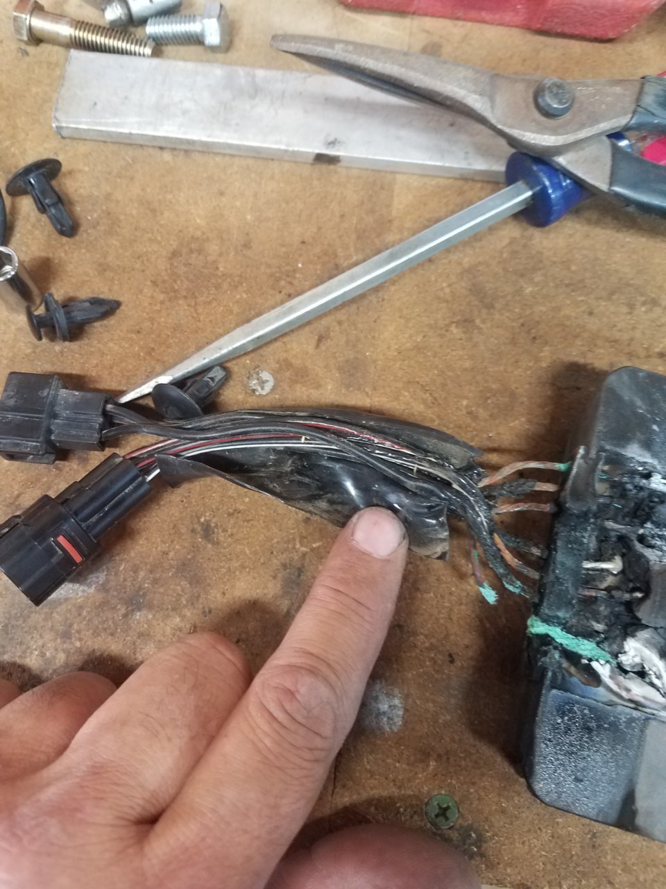

    Pull back the sleeve and see if the if the wire insulation is melted all the way up to the plug. If so there was an overload situation.

    Hang on, it's not up to the plug but I'll cut the sleeve off and post. One thing for certain on test ride it has more jewels

    I'd say half way up the wire harness. It's also getting quite warm, to warm to keep my hand on it. I've wanted a IR thermometer for awhile now, guess a good reason to get one.
