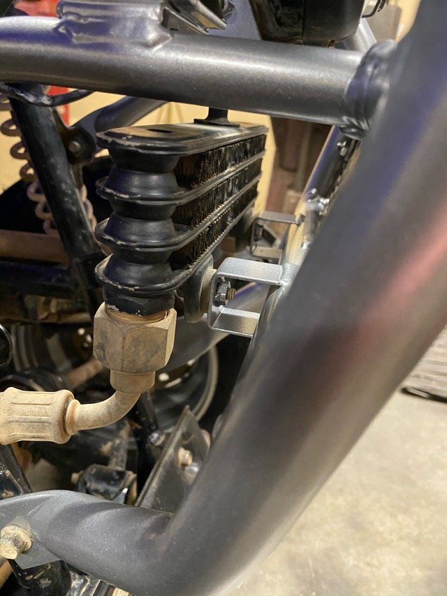

    Oil cooler guard is ready for some black powdercoat.

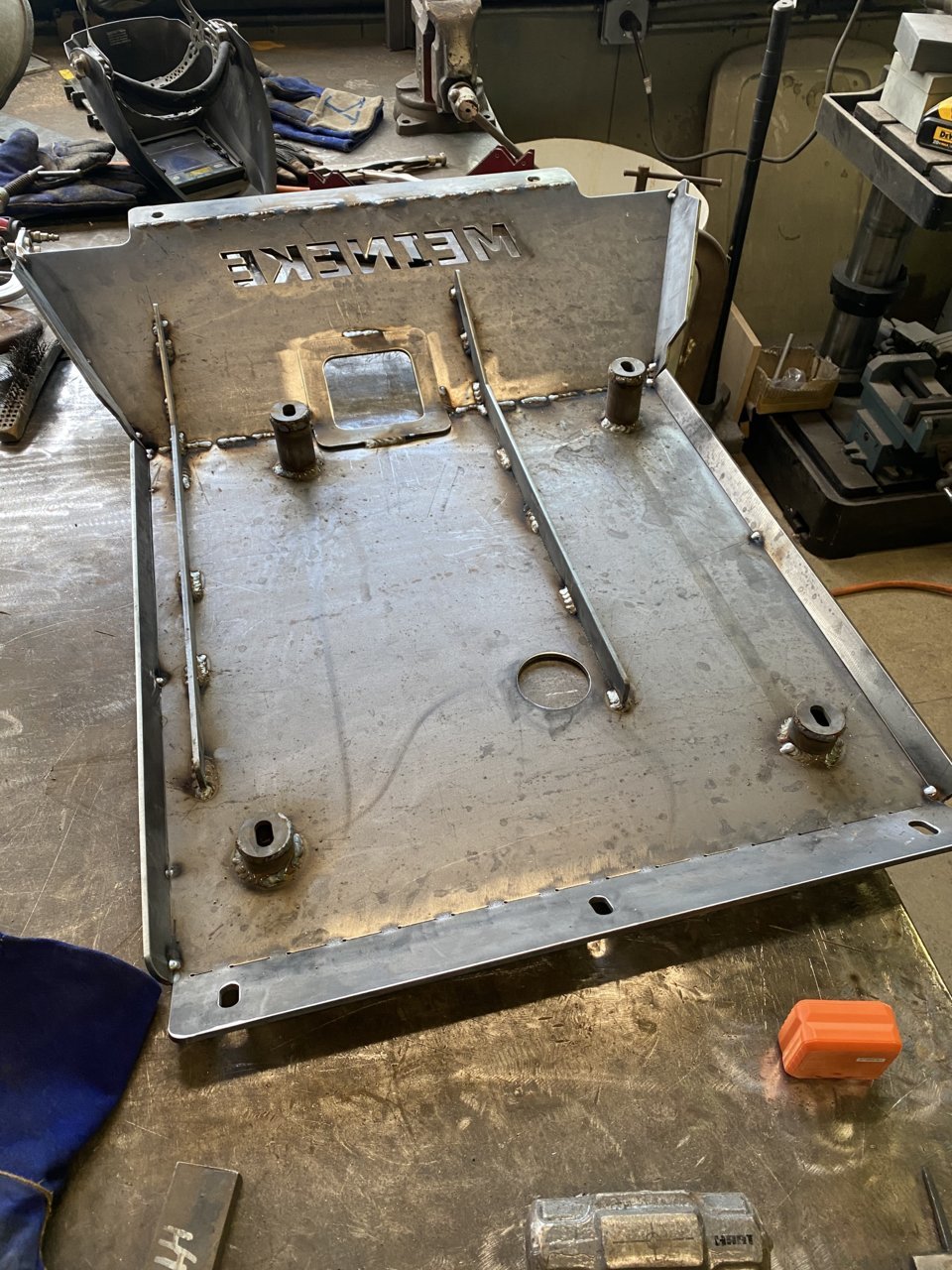

    Hey @six5crèéd thanks for the shout. Cool thread, love me some shop talk.
    I’m always making things for the truck and other projects.
    Here is custom skid I made for another member, 3/16 mild steel, CNC Plasma cut.

    That's a nice, heavy skid plate :thumbsup:

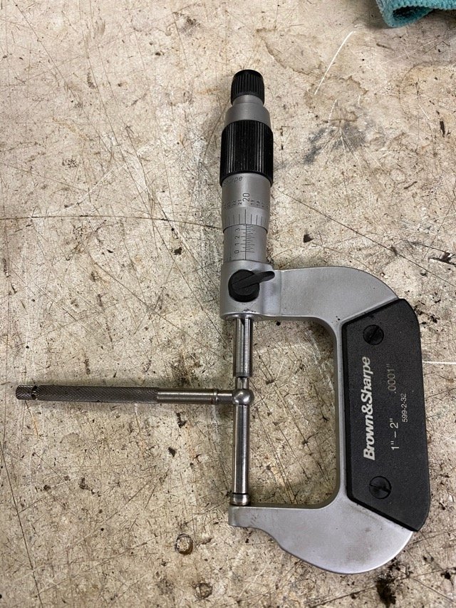

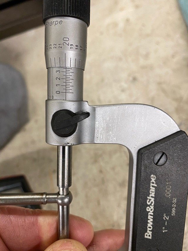

    My preference would be to finish turn the bushing to interference requirements. Surely motorcycle guy could handle ito_O

    It was a .001" press, it was tight! Had to put it in the 20 ton press to get it in.

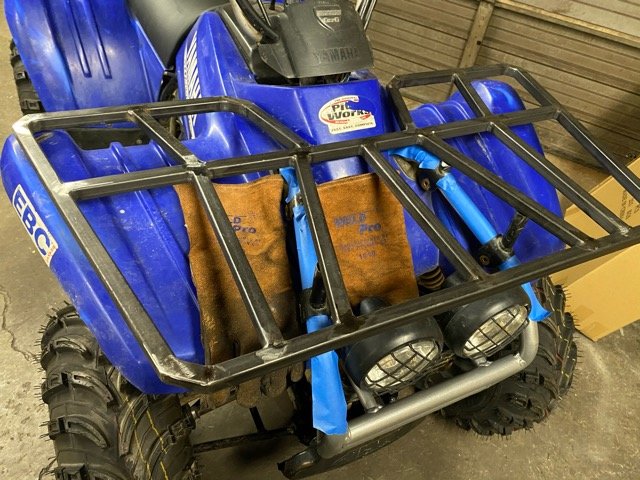

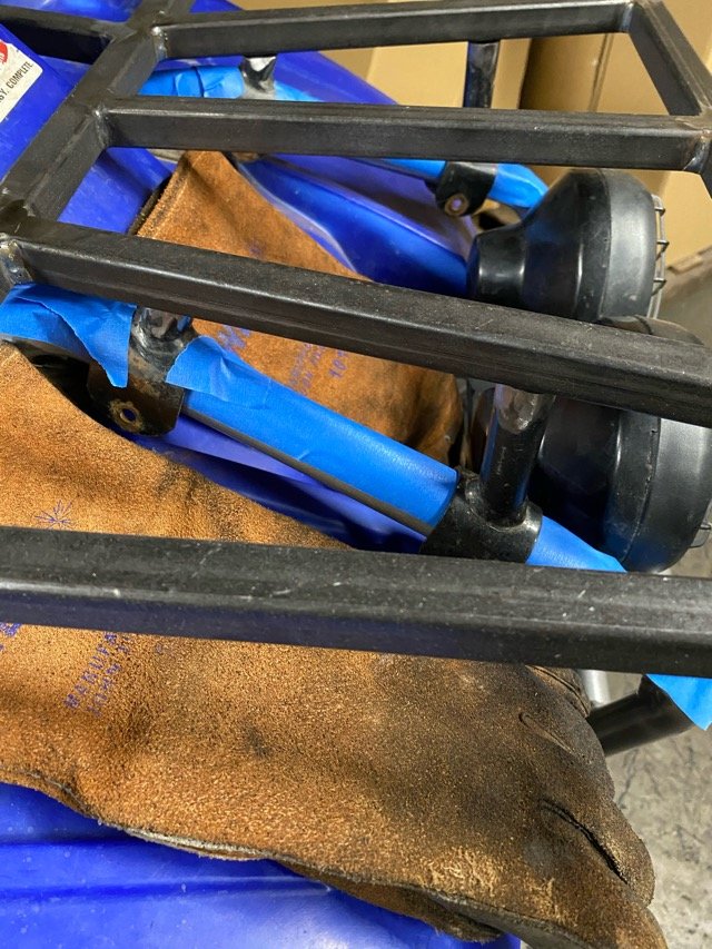

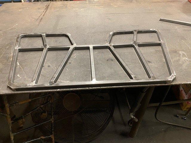

    Rack is getting closer.

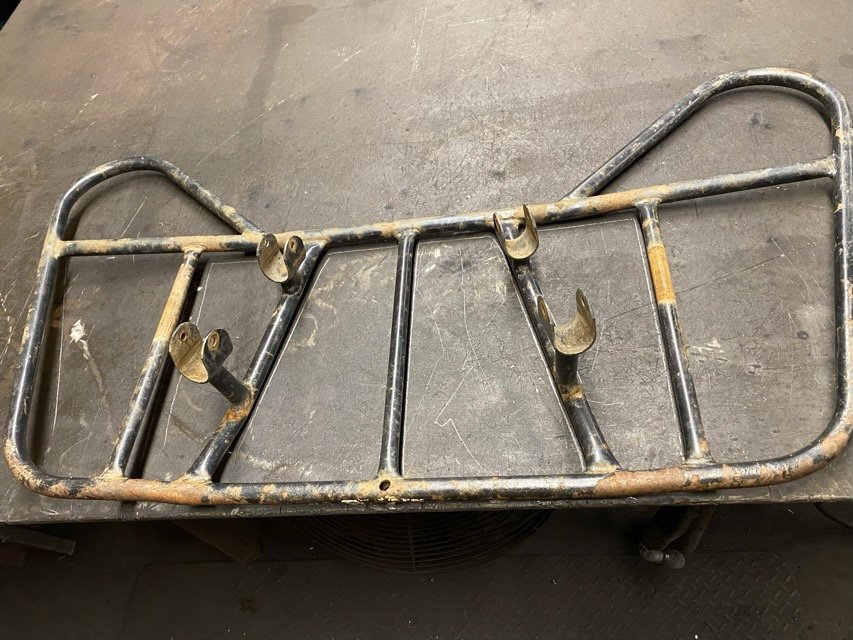

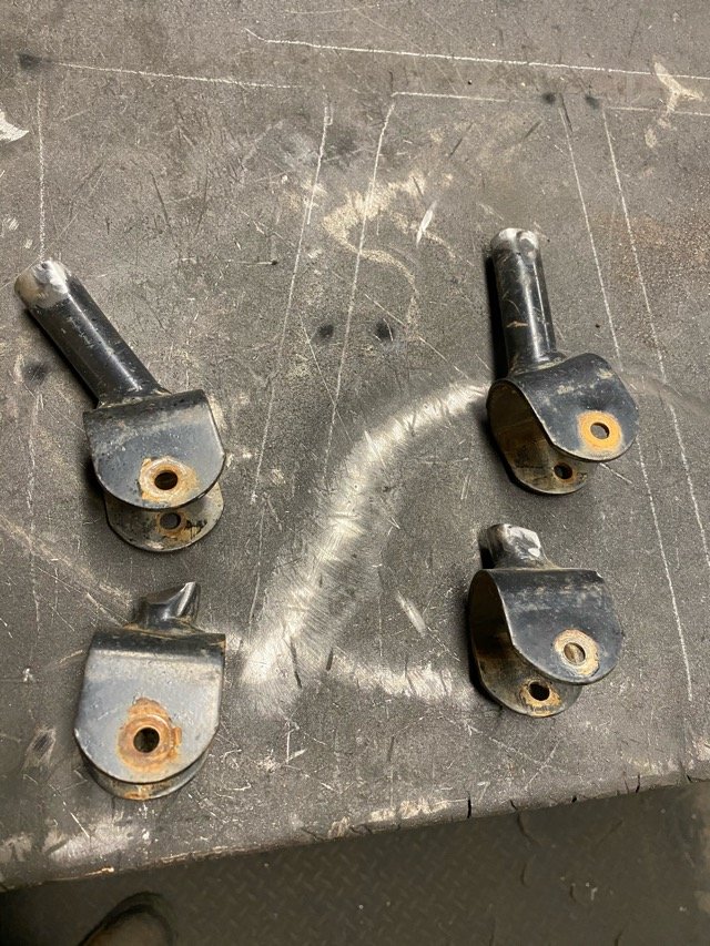

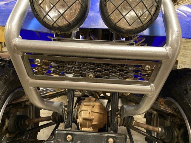

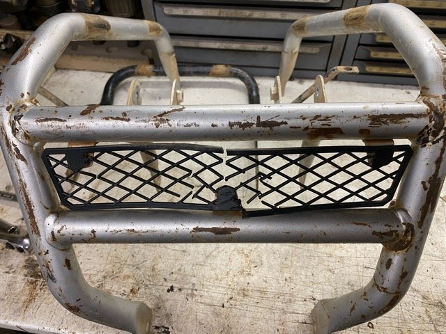

    Reclaimed the original mounts :D

    Got gun rack for this

    I took them off of the other one :thumbsup:

    You mean to tell me you’re not machining a set of billet mounts? Disappointed :boink:
