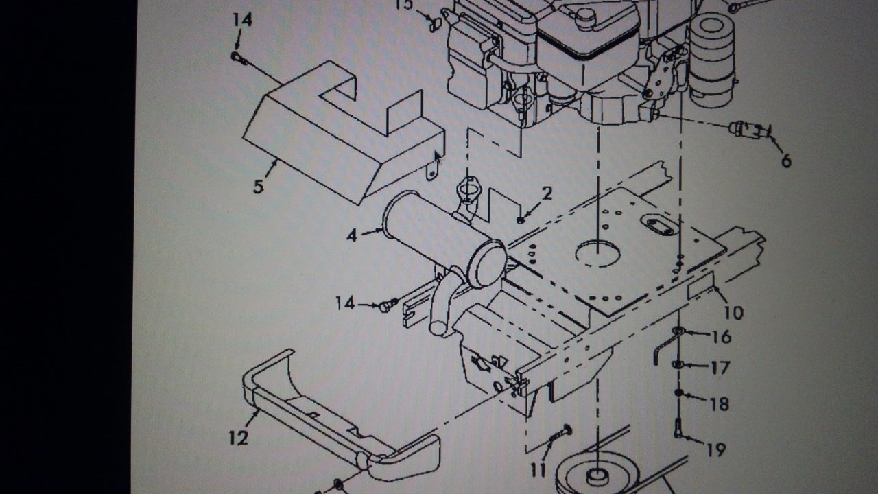

    Blade length or deck contour. It looks like the deck has an insert and the upper blade is straight and the lower provides first cut and lift. Using a single lifted blade might be higher and cause interference damage or improper edge clearance.

    To me it looks like a blade clutch for the belt drive.

    Oh, I just offered so that perhaps the specs were there for finding an equivalent. Back in the day I used to use muffler specs to fit oddball vehicles or handle sound or engine changes. I couldn’t quite tell, but assumed that was the entry from the head and the backside was perforated. Probably a dual tube with packing or just resistance slots.

    It seems to have more ripped away (fatigued probably) than rusted.
    The muffler is (was) under the engine at the front of the mower, I haven't gone prospecting yet to find the part attached to the engine yet.
    This one has always been quiet, in about 5 feet it went from normal to sounding like a air cooled VW.

    I venture one of these fine people with a fancy plasma table could make a new flange if needed.

    Looks like a flange tube. Should be able to make a round saddle to fix this. Cut a circle of similar light steel and shape to the curve of the muffler. If you have a punch of the flange pipe diameter, do that, otherwise cut an X and work to let the pipe pass through from the up leaves of the X. Flare the bottom of the tube and weld the circumference inside and the flared X outside. Then weld the saddle to the muffler itself…. Fixed!

    I like that! :thumbsup:

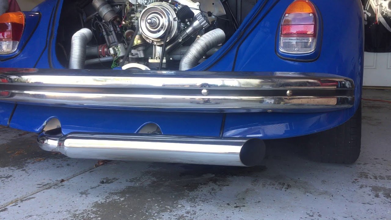

    Mmmmmmmmm, a 1641cc with a small cam and a stinger with no baffle!

    I always liked the Boom Tubes on the Beetles -- much better than the fart cans today.
    40 hp never sounded so cool.
