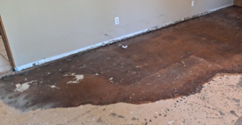

    Another casualty to Florida sandy soil

    I'll see you, and raise you one ice maker burst

    That really sucks. Did it soak into the Sheetrock?

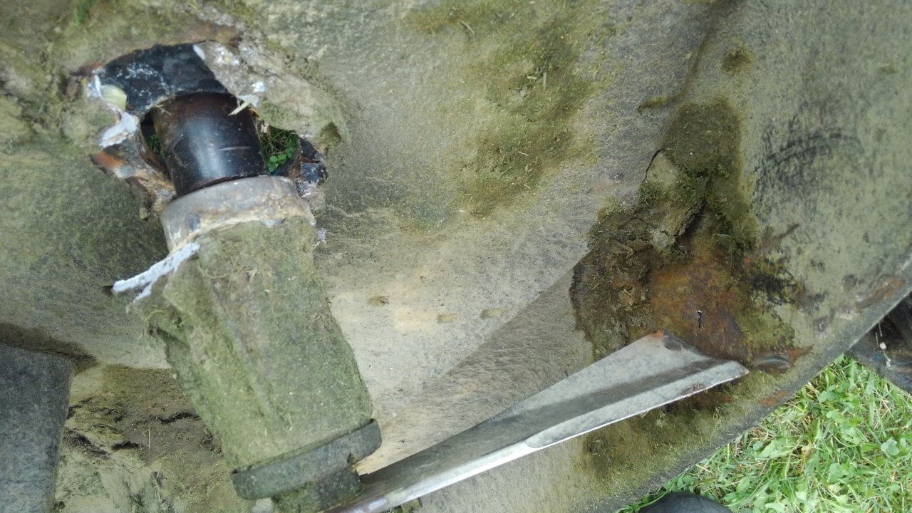

    Looking for a new deck now but going to load it up and run by the local vo-tech to see if I can talk them into trying to weld a plate over it. Pretty thin feeling in that area so I know it won’t last. That’s the location of the deck that gets sandblasted the most from the blades.

    I know I could no problem added reinforcement in that area might help .
    Even if it needs to be on the outside because of clearance with the blades.
    Not as bad as garbage Truck Floors but real close.

    Something wanted out in a hurry…

    Buuuuttttt, water alarm?

    Yes, and they are intact! They were about wore out from the sand but no indication of hitting anything. I know I hit a couple of sticks but nothing solid. I felt sand hitting me toward the end of my mowing, especially if I was backing up. When I finished I found it.
    I actually think it’s just from the sand getting kicked up and abrading the metal and plastic guard over the years.

    The hole looks about the right size and shape for a piece of metal or rock to have exited the deck at a high velocity.:notsure:

    A piece of ⅛" x 3" flat stock heated up and hammered over a solid part of the deck to get the radius could be tacked inside the deck if you have enough clearance from the blade. A little fiberglass on the outside (if you want to make it look pretty), and you're back in business.

    I agree, I just can’t say there was a oh @#$&! moment where I know I hit something :notsure:

    I’ll get the deck pulled and put a new blade on to check for clearance. I think it might be high enough to be ok. I’m not worried about pretty on the outside lol
