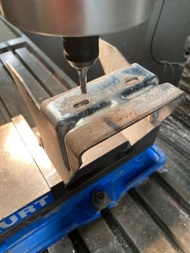

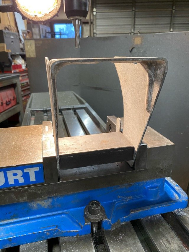

    Customer wanted to extend these slots and take an inch out of the middle. If it works there’s 59 more.

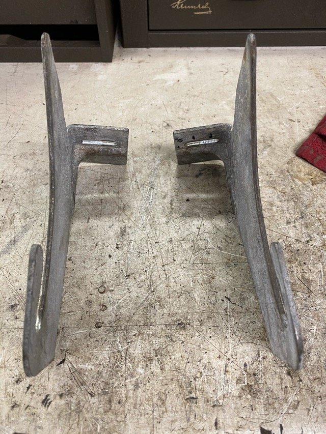

    It’s 1/2” X 2” 6063, soft enough to bend without stress cracking. We’re bending it with a 2-1/2” radius, so it works out well.

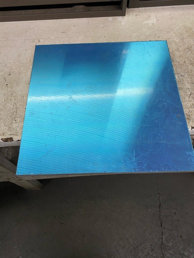

    Now onto an aluminum plate with a few holes. Thank goodness for CNC.

    WTF! :eek: What thickness is that?
    Is that cast plate? 5000 series? Or possibly MIC6?

    1/2" :D I've made about 5 of these, luckily I saved the program :thumbsup:

    It’s cast jig plate.

    We cut a lot of that on our laser in 1/4” thickness, it’s very brittle. The neat thing that I never knew about cutting it on a laser is that it is much more heat stable and allows a lot smaller holes to be cut in it than 5052 or 6061.
    We would normally limit out at a .220” diameter hole but with that stuff we can cut down to a .100” hole in 1/4”.

    It sure is shiny under that protective film.
