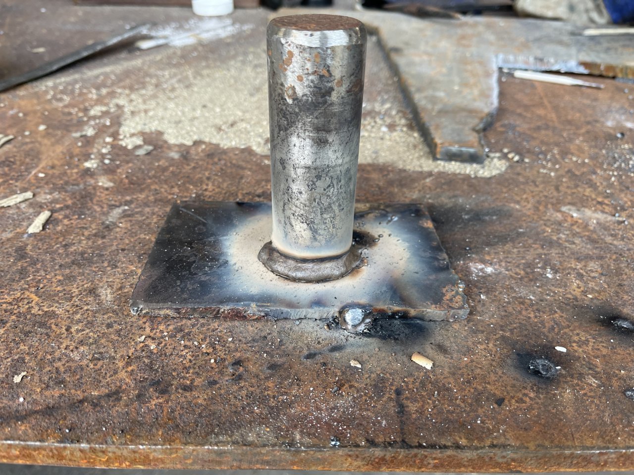

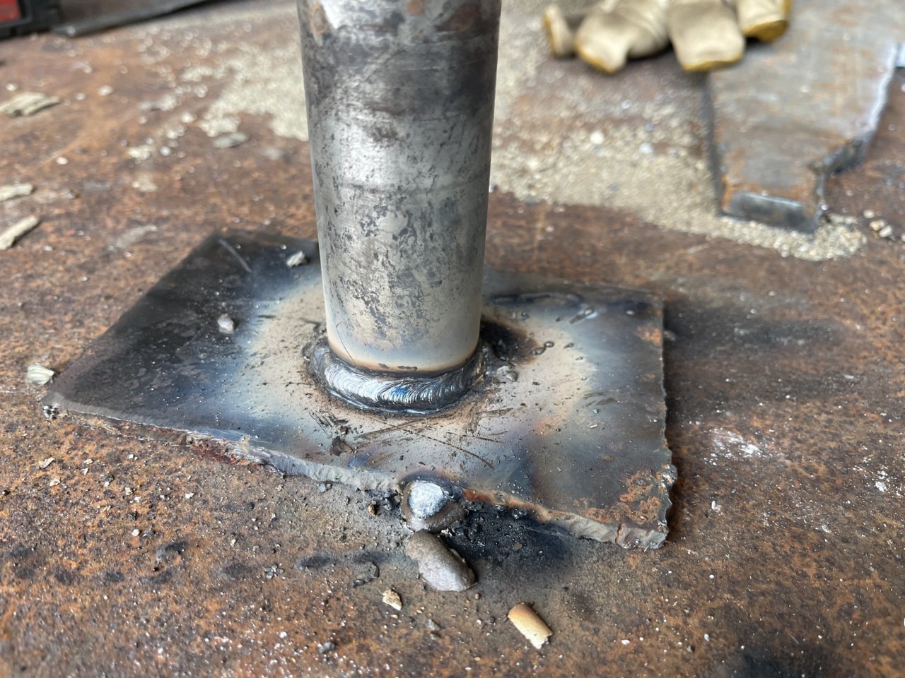

    Morning fellas. Doing some welding and looking for tips/advice. 1/8 7018 rod at ~110 amps. I feel like I need to go slower possibly? 210B15CA-9F9C-4682-BB4D-C31E6C251447.jpg3B873291-6062-4045-ACFA-585D7ED98482.jpg

    The weld looks good, turn the heat up :thumbsup:

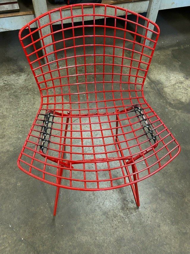

    Powdercoater wanted this chair welded back together. Barely messed the paint up o_O

    Honestly that looks pretty damn good. If you're gonna be welding something that thick, you might want to crank it up to say 150-165. Obviously keep most of your heat on the solid piece of metal. 7018 is a structural drag rod, so keep that in mind. Personally I hate the 7018 rods and usually stick (no pun intended) to 6013. They seem to weld better for me and go through rusty metal better.

    I agree, 6013 is an awesome rod, will burn through rust and dirt, and easier to get a bead down. 7018 is stronger but not as easy to weld with.
