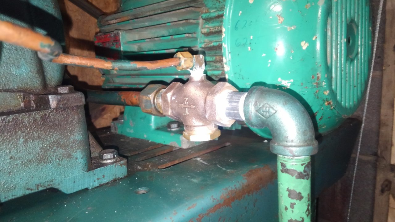

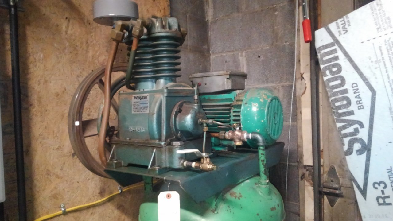

    Well fellers, today's episode of Past Tech with Rusty finds us spending a bit of time with the 1960 Wayne air compressor.
    After 60 + years the check/head unloader valve didn't check very well any more and the tank would lose pressure in a day or two. As I frequently said at my old job -- air is expensive.
    The part was about $30, almost identical, a 1/2" longer pipe nipple was all that was required.

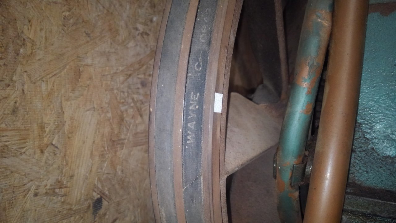

    As I had already wheezed up to my top speed (that of a snail) I adjusted the belts too. Note the picture, genuine Wayne belts. Original?
    She took off just like always, I used my new cool non contact tachometer - the pump turns at 378 RPM.
    This old girl and I have that in common -- not fast, we just chug along.
