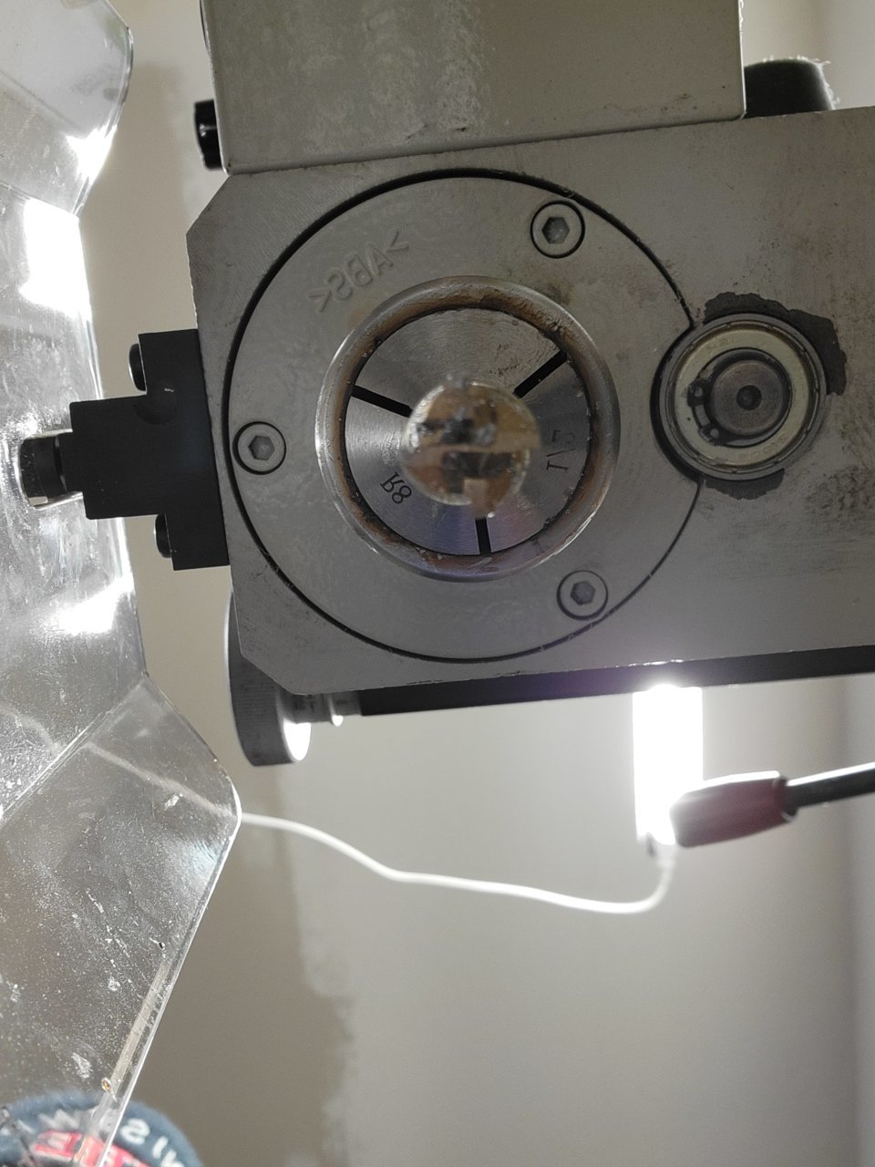

    Yes.. it's an R8 and I have a collet holder on order. I have a set of collets in the kit I ordered but no collet holder. Haha.

    R8 is pretty standard but I bet a complete set is pretty expensive. Been awhile since I priced them.
    You'll find running that end mill in a collet is going to work much better.

    I agree, I’ve ran some end mills in a drill chuck when they were an odd size and we didn’t have a collet, the chatter is awful, not to mention runout.

    You remove that drill chuck and stick the appropriate collet in there and tighten up the draw bar. That kit came with what you need it looks like to me.

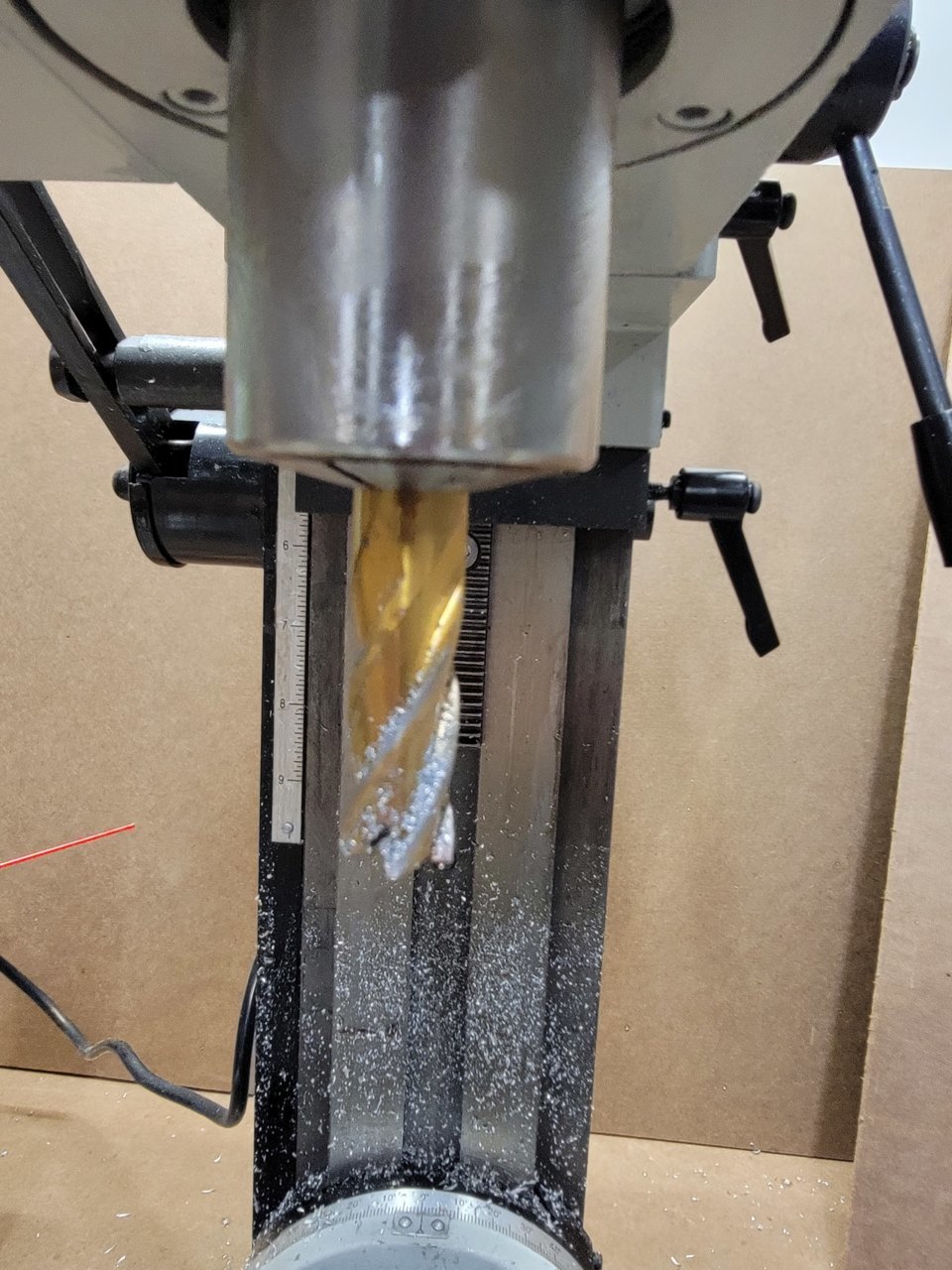

    I'm a damn idiot.
    Fixed

    No you’re not. You’re learning :fistbump:

    We all started not knowing.
    I’ve been machining 26+ years and still don’t know what I’m doing…..and make mistakes :D
