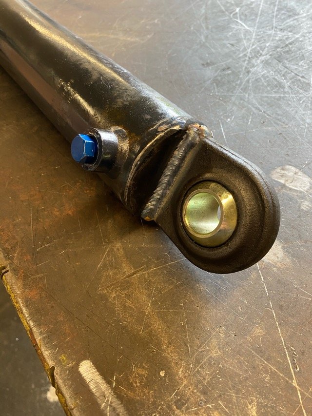

    New fish eye on a hydraulic cylinder this morning.

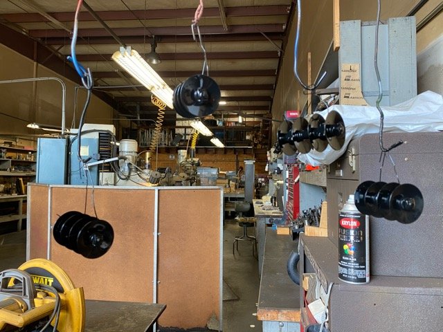

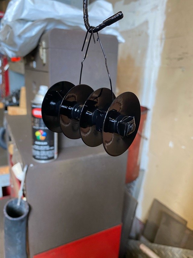

    Spray painted the gangs. Will have the frame powdercoat painted red. I didn’t have these done because I want them to still roll, the powdercoat would stick them together and the parts are too small to take part and have done separately.

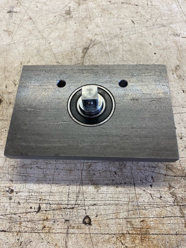

    Just got this done for a customer, he calls it a crank tool. Not sure what it’s purpose is.

    I think it's to loosen a crank bolt. Socket goes on the end with the spring-loaded ball. Ratchet goes in the other. Two bolts go through the holes and thread into the pulley. Keeps it from turning while trying to loosen the bolt.
    Orrrrrrrr, I could be completely and utterly way off.

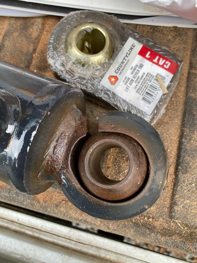

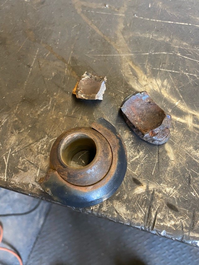

    Man came by the house to pick up his cylinder and brought me the other side to fix tomorrow, it goes on a dozer type blade for his cat skidsteer.

    Wouldn't the pulley rotate with the crank bolt?
    I am curious about this tool... There may be an attachment we are not seeing.

    It would, but I'm guessing the square portion butts up against something to keep it from spinning.
    And you may be right, there may be other parts we don't see.
    Hopefully, when it gets picked up we get our questions answered.

    If the one the customer brought is still at the shop in the morning I’ll get a picture of it. The center came out (no bearing) of it and it had a lot more holes but he said he didn’t need them.

    Creed, do you know if the drive mechanism is original? The little 1/2" drive piece?
