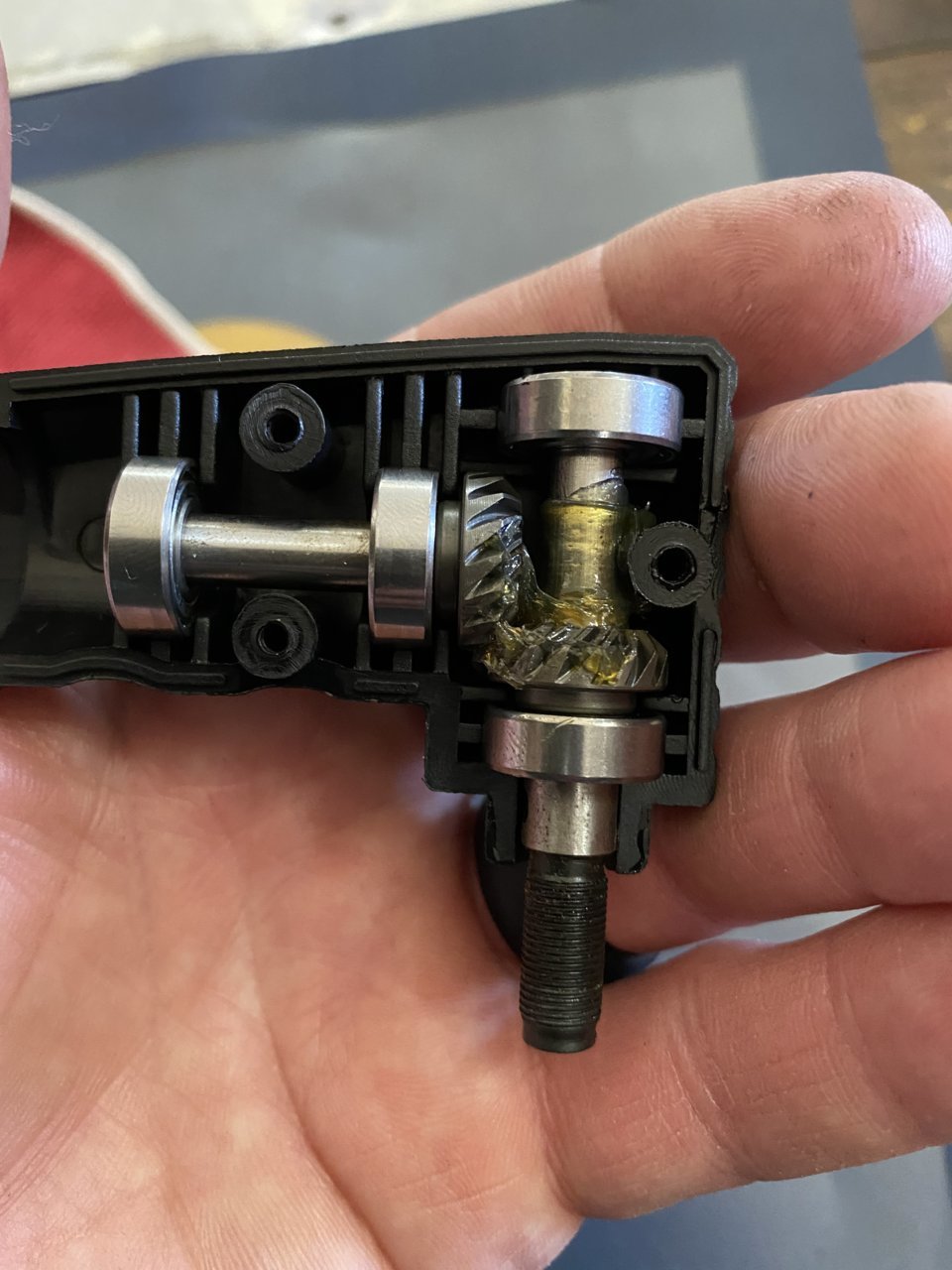

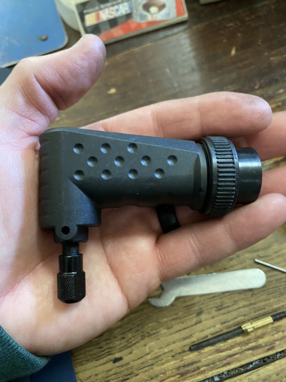

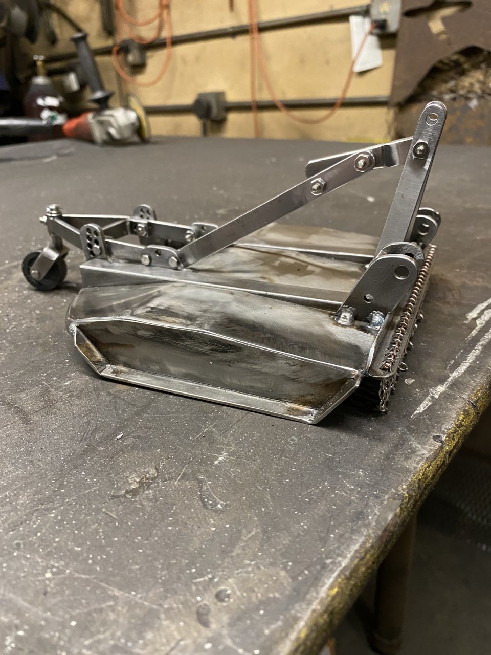

    Bush hog needs a gearbox. I want it to work. Got the wife to order an angle head for a dremel, wanted to see what was inside it. :yes:
    All I need is the guts.

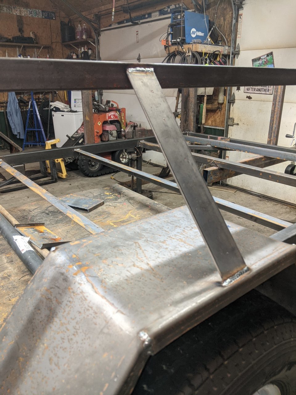

    Fender supports.
    These are 11 gauge steel fenders. Pretty hefty. The trailer should move if someone backs into one of these fenders. Factory, stamped steel fenders are 16 gauge.PXL_20220225_215548888.jpg
    Support strap.

    Dremel head seems larger than the Bush hog?

    RC car diff parts?

    Small spinning reel has the same parts

    The head is, all I want is the gears out of it. I’ll have to make shafts to fit the way I need them and probably use brass bushings instead of bearings because of size. It just needs to turn, won’t be used :D

    RC helicopter transmissions were small and light.
    Not sure if I still have a spare one from my flying days
