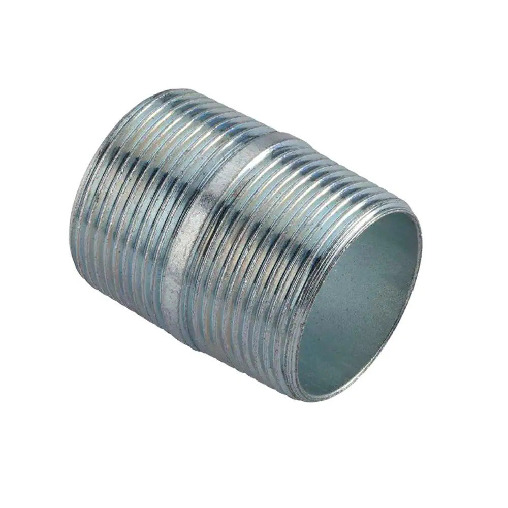

    Here is a “Technical” question for you pipe fitters.
    I had an interesting discussion and wanted to get your alls opinions. It had to do with preassembling pipe joints. I had a situation today where I had to put a 2” nipple into a “coupler”. The other guy on the job said it’s not good to preassemble joints and use the far end to tighten the whole thing. In our situation, we had no choice. I will add a picture below for demonstration.
    Let’s say we preassembled the cap and nipple below. We then had to go through an object making it impossible to turn the nipple. So we have to use the cap to tighten the whole thing.
    The other guy on the job said you can’t get a good idea of how tight nipple is because you are using the cap to tighten the nipple.
    I say, if the cap is tight to begin with, than the nipple has to be as tight or tighter than the cap before the cap would start to turn.
    Preassemble this
    Then use the cap to tighten the whole assembly. (I doesn’t have to be a cap, in my case it was a coupler) As you can see, you aren’t using a pipe wrench to tighten the nipple in this case.

    Short version: Yes it will work but is not best practice.
    I wouldn't call myself a Pipe Fitter though I have run miles of black iron pipe.
    In the example of the cap, it (the cap) will be tighter on the nipple than the nipple is in whatever it is threaded into. Sometimes one wants to remove the cap and it will bring the nipple back out with it.
    With a multiple piece assembly, that end piece is going to be a lot tighter than all the parts down stream from it, you won't get the desired consistent torque on every fitting like if they were assembled one at a time.
    Although it seldom happens it is also possible to strip the treads or split a fitting too.

    Nothing like a good :censored:ing to teach you a lesson. :mad:
    This is called a "close nipple", it is not your friend and the use of it should be avoided.
    Many of the plumbing service calls and call backs over the years involved a close nipple at the root of the problem.
    It is not your friend. :mad:

    I'm trying to follow along here, jumped on kinda late about to hit the sack.
    The consensus is that you dont want the cap to have the highest torque incase the need for disassembly arises, you start moving further upstream than necessary. Ok I'm following.
    You don't want to use a nipple fitting like that basically because you have no shoulder or shank to hold the fitting in place and tighten/loosen. You could wrap a rag or some rubber under channel locks but you're probably gonna dick your threads trying to disassemble it. Am I picking up what you're putting down?

    Every time you use a pipe wrench you leave marks on the pipe.
    The close nipple has no un-threaded area to wrench on so you are going to mess up the threads, it is a given.
    Since you don't want to mess up the threads so much that you can't get the damn thing to turn it probably won't be tight enough - it will probably leak - maybe at a time after the job is complete and the pipes are subject to some vibration.
    Generally all fittings of the same class are interchangeable between different brands, however that doesn't mean they are identical. You may end up with fittings too beefy and they hit before the close nipple is tight enough to get a good seal.
    Since both halves are threaded the close nipple is thinner and a bit weaker, as you are trying to tighten the damn thing without messing up the threads it might distort into an egg shape so the other fitting won't thread on.
    Or the weaker close nipple might snap off if the pipe is subject to vibration or impact.
    Yeah... That close nipple and I go way back -- it isn't your friend. :devil:

    In my situation today, that would be the ideal scenario should one ever have to take the assembly back apart. If the “cap” comes off and the nipple stays in, the job just got a whole lot harder.
    As for the cap being tighter, it should be pretty equal. Torque in should be close to/equal to torque out(end)
    The weakest (loosest) connection should turn before the rest.
