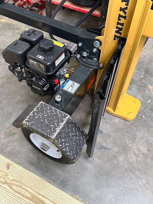

    Got another post in and one 16’ board up. Mountain life :eek:

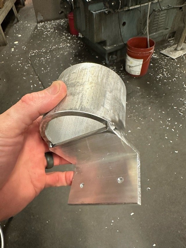

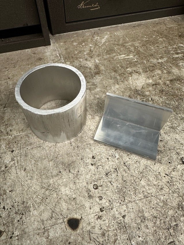

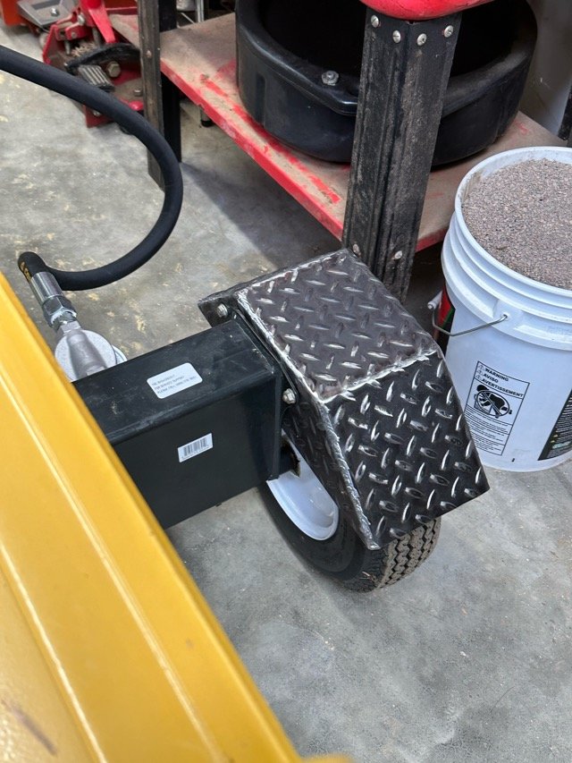

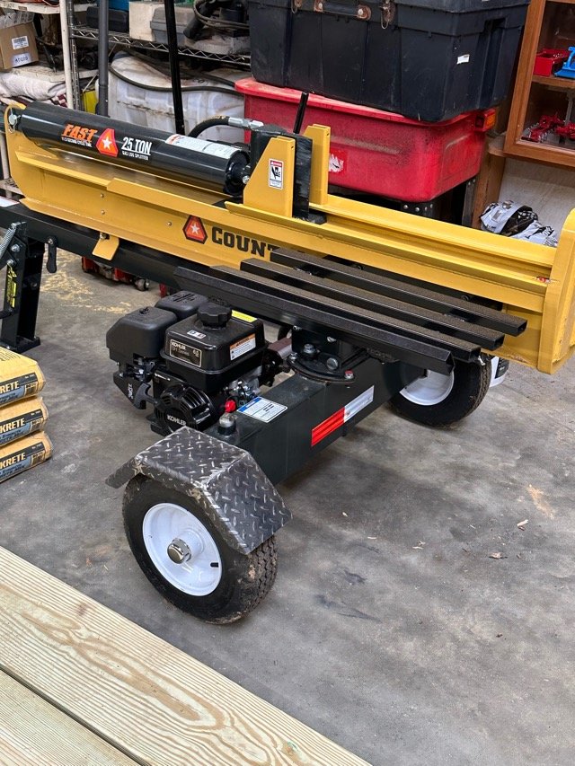

  6. Apr 11, 2024 at 3:44 PM
    six5crèéd
    six5crèéd [OP] Be the light
    Jul 9, 2019
    #298734
    35,737
    Southern Virginia
    8 lugs no plugs

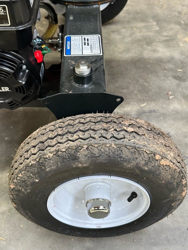

    Wood splitter already had the brackets, it’ll help keep the mud off the engine side.
    Little close with the wing, not too close though.
    Verified fit, off to powder coat tomorrow.

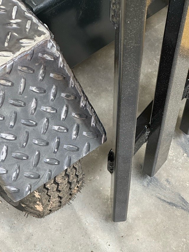

  7. Apr 11, 2024 at 3:46 PM
    koditten
    koditten Well-Known Member
    Sep 8, 2013
    #112077
    19,725
    Kirk
    Central Michigan
    04 trd x-cab 4 x 4 3.4l
    Reserected from the dead.
    Can you get the tire off with the fender sitting that low, or so you just pull the fender beforehand?
  8. Apr 11, 2024 at 3:47 PM
    six5crèéd
    Jul 9, 2019
    #298734
    35,737
    Southern Virginia
    8 lugs no plugs
    @hiPSI thanks for the idea. Now it won’t fall off and I know where it is supposed to be.

  9. Apr 11, 2024 at 3:48 PM
    six5crèéd
    Jul 9, 2019
    #298734
    35,737
    Southern Virginia
    8 lugs no plugs
    Probably not since I bent the edge, it’s fairly easy to take fender off though :thumbsup:
  10. Apr 11, 2024 at 3:48 PM
    koditten
    Sep 8, 2013
    #112077
    19,725
    Kirk
    Central Michigan
    What size pipe? Gonna do this, too if I got some scrap.
  11. Apr 11, 2024 at 3:49 PM
    six5crèéd
    Jul 9, 2019
    #298734
    35,737
    Southern Virginia
    8 lugs no plugs
    3” inside, minimum.
