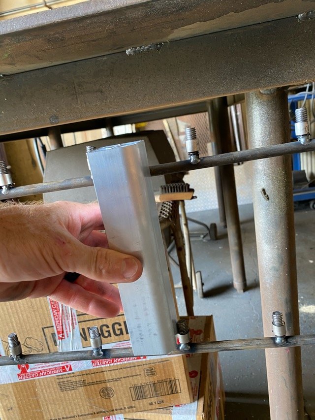

    What’s the function of these fixtures?
  4. Jun 29, 2020 at 10:57 AM
    #104
    six5crèéd
    six5crèéd [OP] Be the light
    Jul 9, 2019
    #298734
    35,736
    Southern Virginia
    8 lugs no plugs
    Powdercoater is screwing parts on them to run through the paint line.

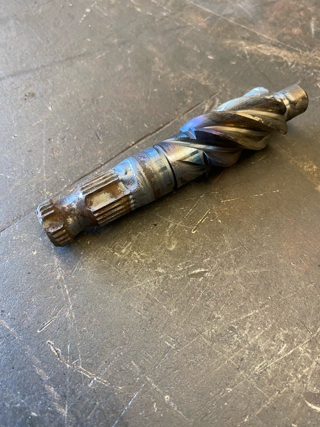

    Finally done.

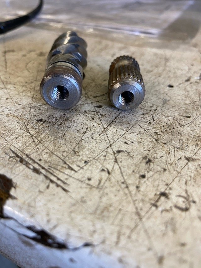

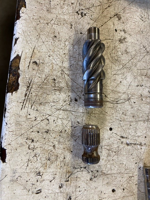

    Friend brought this shaft by and ask me to fix it. Drilled and tapped both pieces after facing them off in the lathe to get them square and tig welded it. Put a 1” long 1/4” set screw in the center.

    You just told us you don't run a lathe, when you're welding, (which I find suspect)....dammit.....make up your mind.
    (nice work too, and don't tell anyone I saw this)

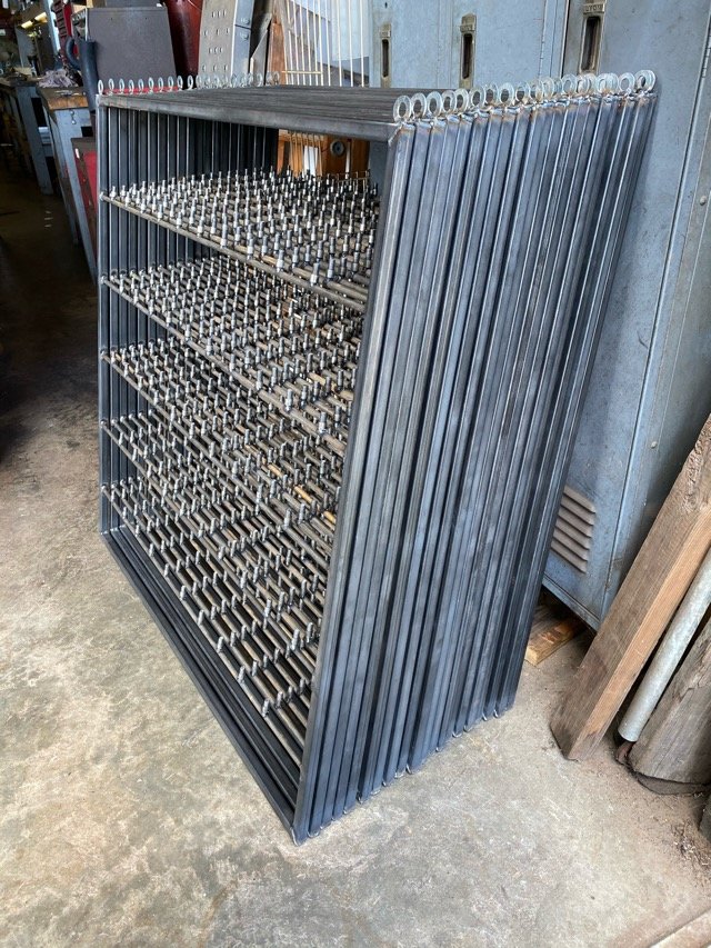

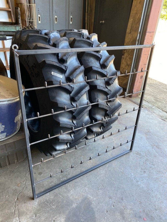

    Remember the 20 racks I made a couple weeks ago? Customer sent parts to powdercoater, powdercoater came to us to build racks. Supplied sample piece from customer at 4" long, rack drawings approved that my boss drew up, etc. Got them done, well guess what? They come to us today and they don't work, they have 2 different parts and one is 7" long and doesn't fit. Makes me so mad when people get in such a rush on a large job they forget what is actually going on. Luckily I get paid by the hour :thumbsup:
