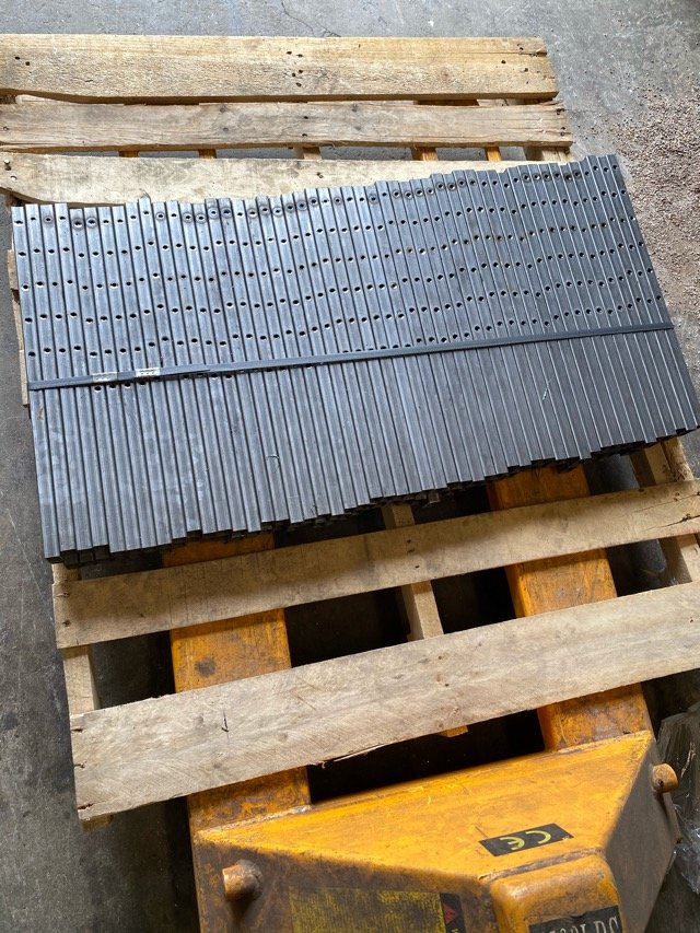

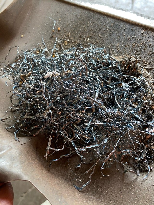

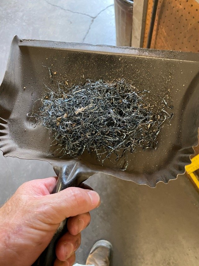

    This is all the chips I had from 612 holes.

    Cleanup alone is worth the expense of the bit.

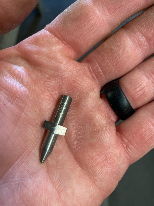

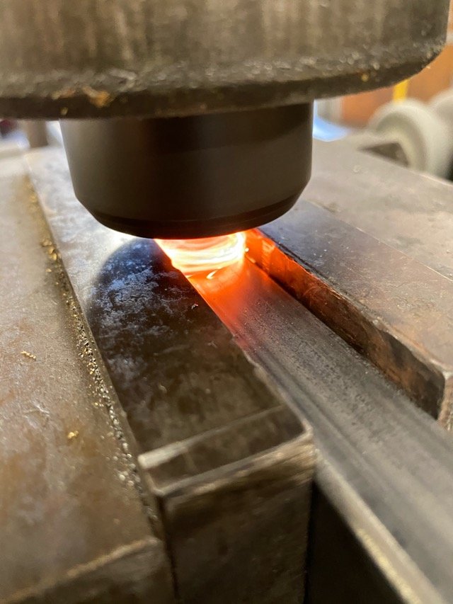

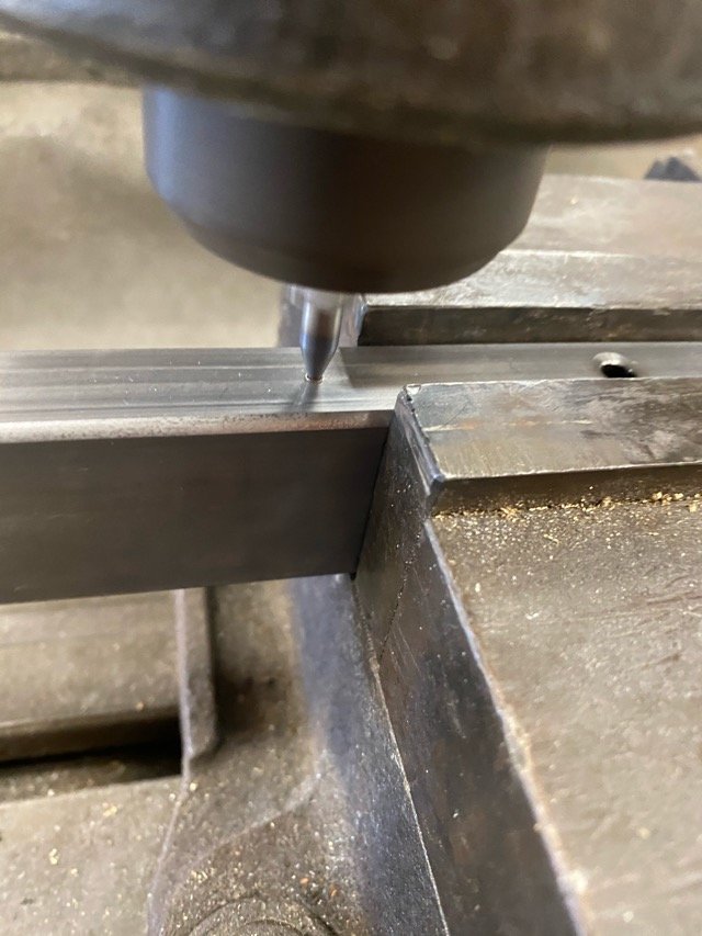

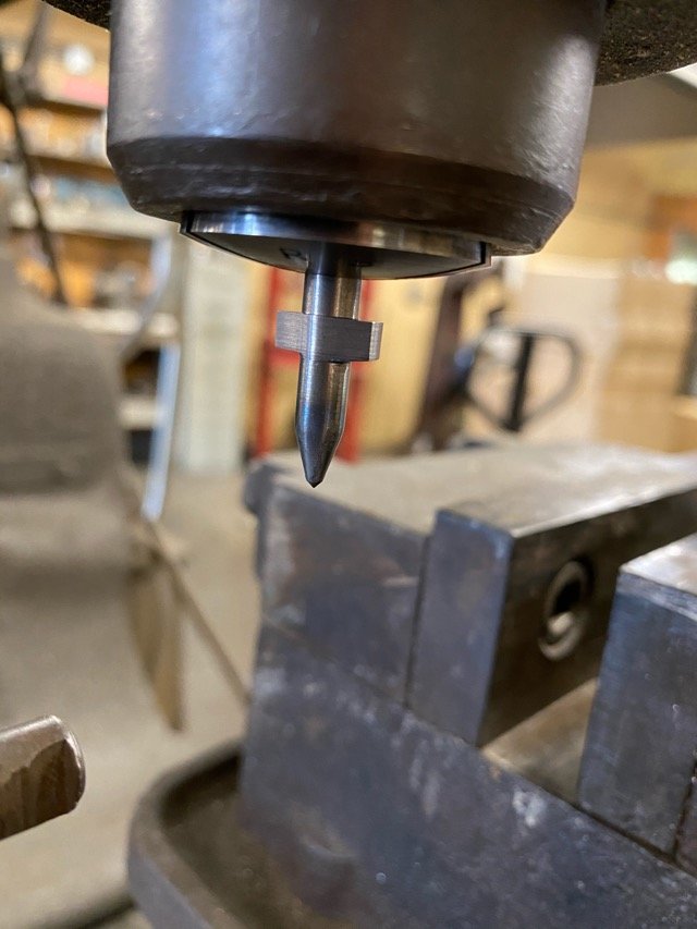

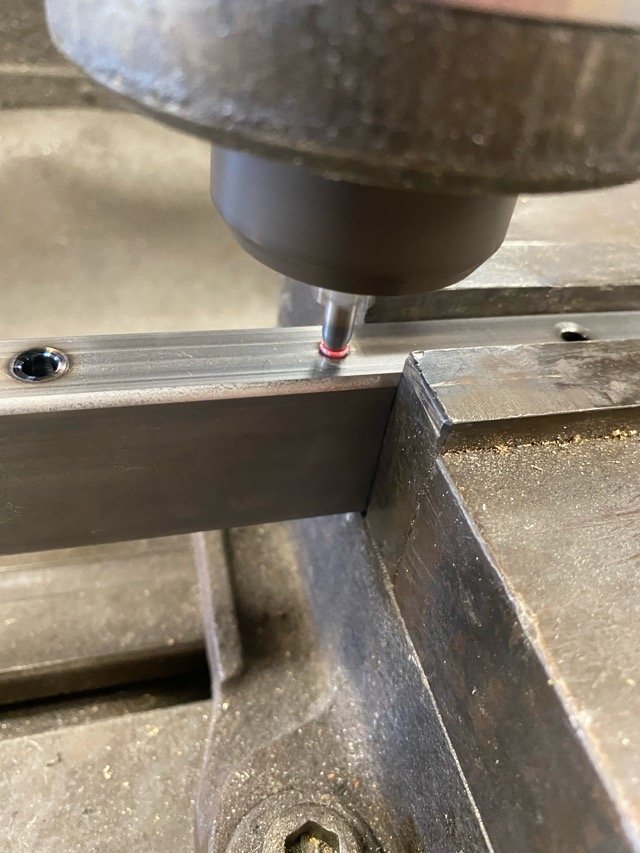

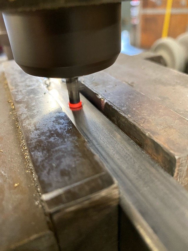

    Self Tapping feature. Shorter line up.

    Two bits to cut that many holes is amazing

    Should have been one, it was my fault the other one broke.

    Apparently you can’t put even a little bit of side load on carbide, rookie mistake. I was in a rush to get done.

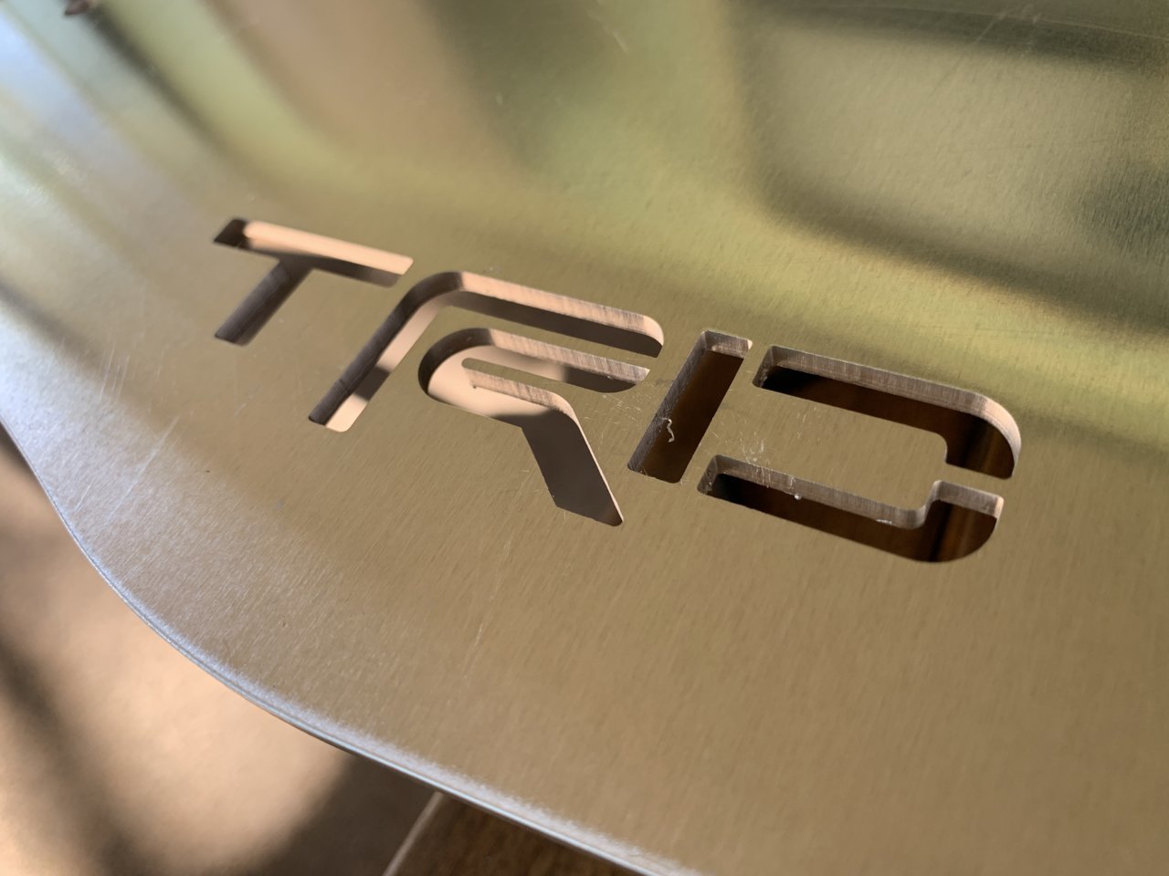

    Pretty. What is that for?

    That is beautiful :drool:
