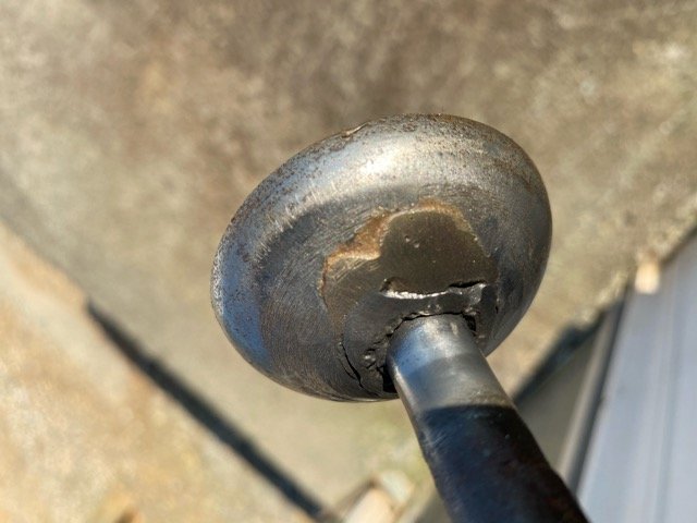

    I don't know. I sold this tractor to a guy about 3 years ago, it's a 1949 Farmall Cub. The guy is 81 years old. He said he was cultivating his garden and it went floppy. He ask me about it and I told him to pull the cover off and he brought me this. I think I'll just make him a new stick. It looks hard as a rock but it scratches with a file. It's in a bad place to weld being up against the sheet metal piece.

    Is that mud or is the gear oil just that color brown??
    I see what you mean that would be interesting to weld is this:boink: warranty on the 3 year old tractor sale??

    It is gear oil and rust. Warranty ran out when it left my place but he's a great customer at our store. He is 81 but you wouldn't think it, he is a general contractor and out works most 20 year olds.

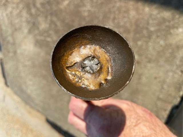

    Someone put a huge dollop of braze on this.

    A brazen attempt to repair. :)

    I see why they brazed it now :frusty:

    Given where it broke, I wonder if they didn't accidentally anneal it when they did the brazing repair.

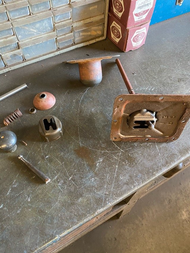

    Possibly so. Luckily this just got easier. Found a used one I had :D

    You know, I’ll bet that’s about the size of a steam trap float ball. Give or take.

    This has now taken a very interesting turn.
    I know Ford can be great for new Parts But this old??
    Missed the good old extra part!!

    These are reproduced for $69.99 They made so many Farmall Cubs there are a lot of aftermarket parts available.
