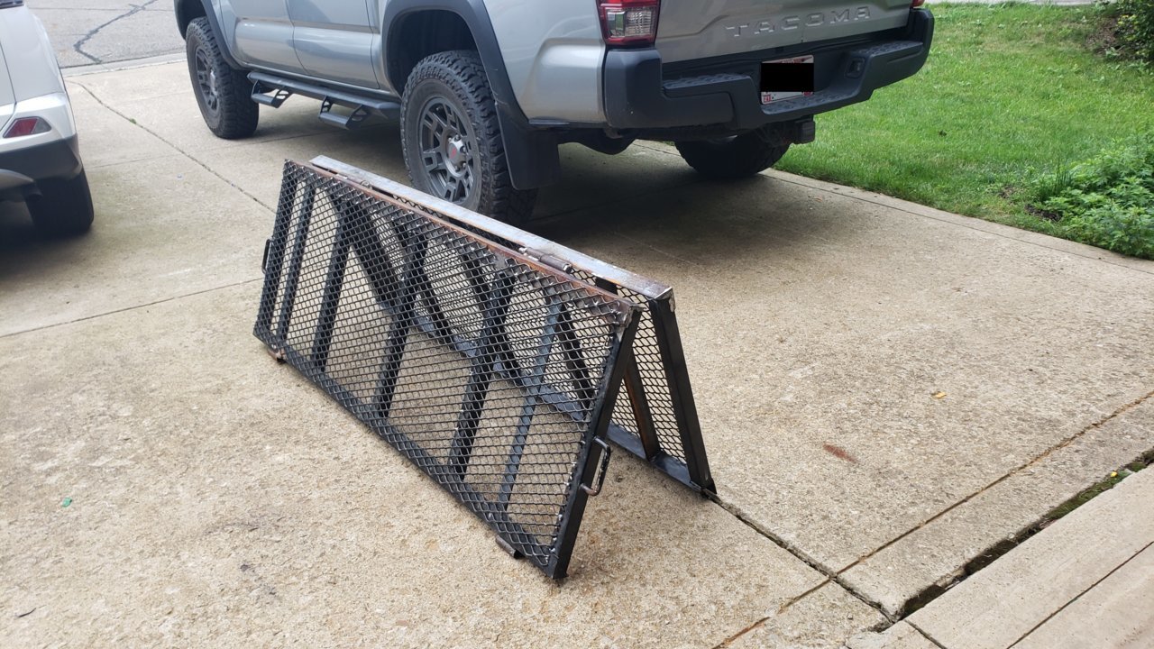

    So a few weeks ago I blew out the grating on my trailer gate and pulled it off my trailer. I then found out that I get like 4 MPG better without the gate vs. having it stand 4ft in the air. So I decided to create a bifold gate and see how it goes. Unfortunately I have about 1" of warp from one end to the other across 5' lol.
    I also added some angle reinforcement where my SxS and tractor blew out the mesh.
    Good news is it open and extends, then shuts well so I guess if it works it's not stupid.
    Right?

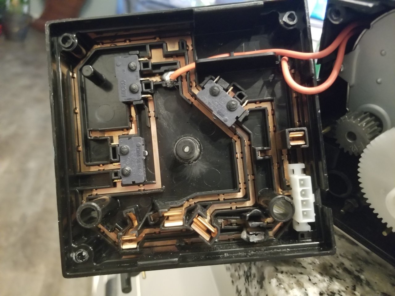

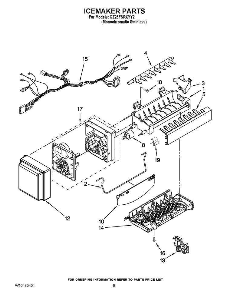

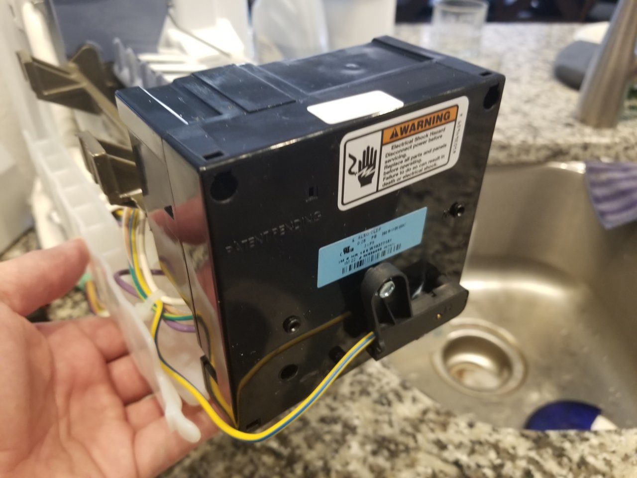

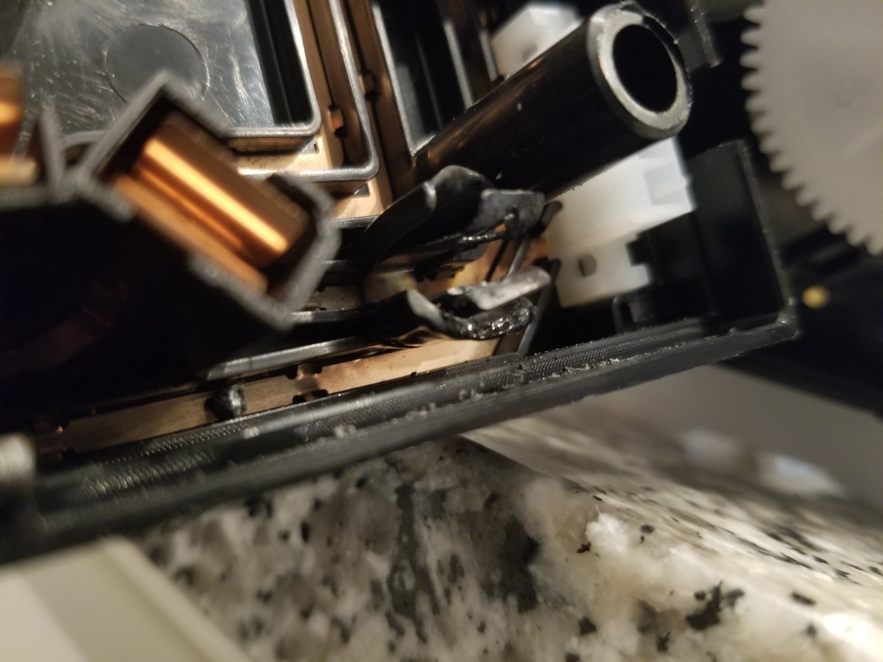

    After I got the ice maker out, I took the front cover (12) off, expecting to see the gear in part 17:
    but mine looks like this:
  9. Jul 13, 2021 at 5:51 PM

    You need to pull the 4 screws and that comes apart the good thing is that’s a updated ice maker. IM 22 ?

    That plug looking thing is the main power that’s where you can check voltage at the ice maker

    Three screws and a bolt later, I've found the culprit.
    Bottom right connection to the heating element is cooked.

    :thumbsup: New one

    I still need to grind the barbs off the mesh and prime and paint. About half way through this project I muttered to myself that I should just make some ramps and call it good. So once I get done "fixing" my gate, I'm going to make some ramps lol.
    Realistically I should have just made a dirt ramp at my cabin to back the trailer up to and drive off. I still might do that too I guess.
    I have some metal next to my garage and this is what happens...
