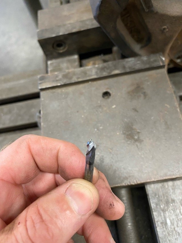

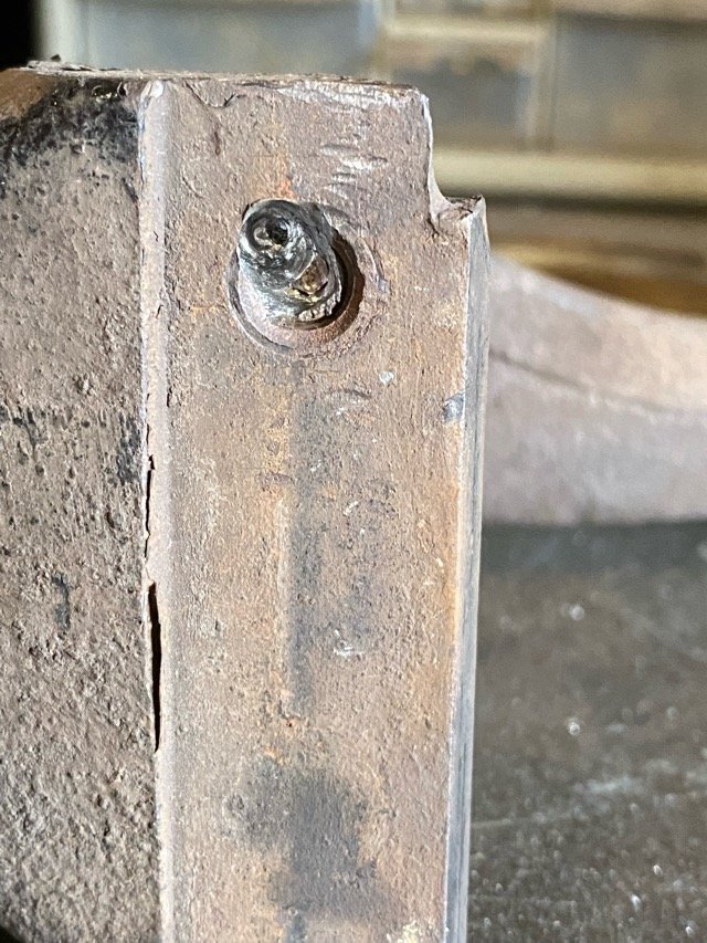

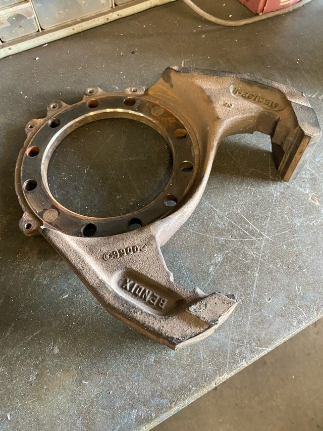

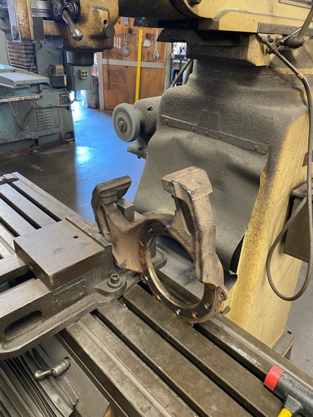

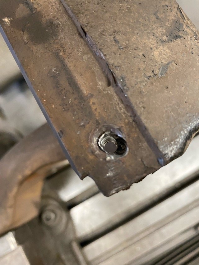

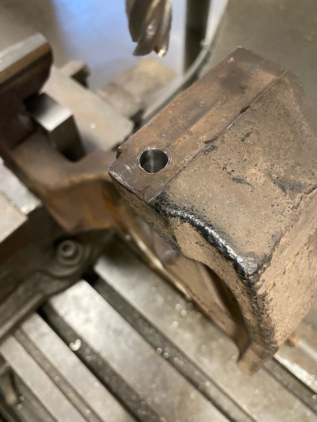

    Friend brought this by the store yesterday evening and ask if I can fix it. He tried to drill it, it’s off center and it has an easy out broke off in it :annoyed:

    Tried to drill it still in place ?? Cast Iron or Cast Steel
    Have any contacts that EDM I can`t remember??

    Solid carbide is your friend here. Run the tooling in a collet so it runs true. High rpms and no cutting fluid. Center drill then tap drill or slightly under. Then pick,punch and chisel.
  5. Jul 16, 2021 at 4:59 AM
    tacotoe
    tacotoe Pastry Chef
    Nov 25, 2007
    #3593
    5,915
    Nebraska
    `17 AC Sport MT
    ARE Topper, Icon aal, OEM Audio+
    Even a center cutting carbide end mill. After you get a hole through it and drill or mill operation is done, squirt a little foo-foo on there while it's still warm.
  6. Jul 16, 2021 at 5:02 AM
    tacotoe
    tacotoe Pastry Chef
    Nov 25, 2007
    #3593
    5,915
    Nebraska
    `17 AC Sport MT
    Sometimes these situations, I'll lock the quill down a ways, then feed up with the knee, more control and rigidity.
  7. Jul 16, 2021 at 5:11 AM
    tacotoe
    tacotoe Pastry Chef
    Nov 25, 2007
    #3593
    5,915
    Nebraska
    `17 AC Sport MT
    Oh, and if it's a through hole, work it on the back side. Using RH cutters ya never know, might be your lucky day and get to spin out. Unlikely given that off center deal pretty much got it staked in there:rofl:

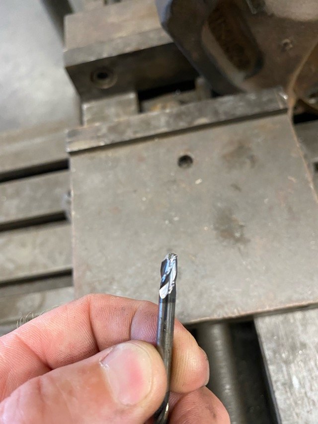

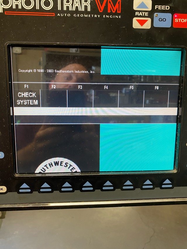

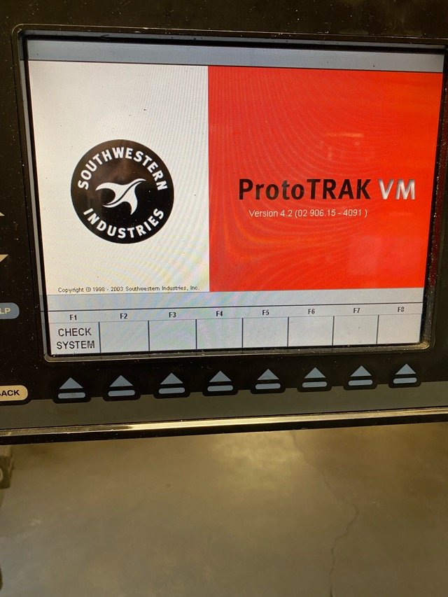

    This isn’t the first time this mill has done this, I wrote a program and tried to draw it and it locked up. I reset it and got the dreaded split screen.
  10. Jul 16, 2021 at 5:43 AM
    six5crèéd
    six5crèéd [OP] Be the light
    Jul 9, 2019
    #298734
    35,970
    Southern Virginia
    8 lugs no plugs
    And we’re back.

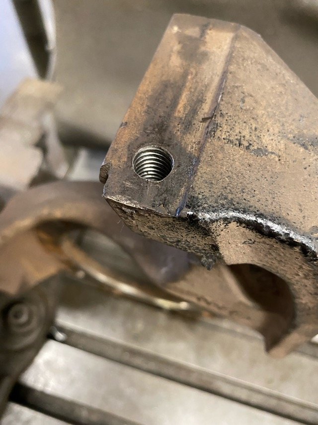

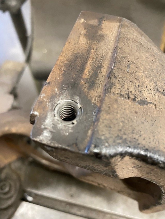

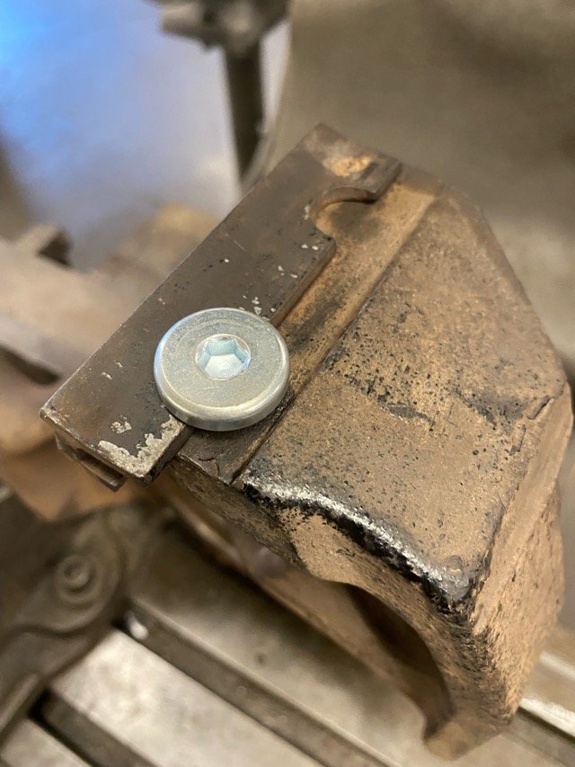

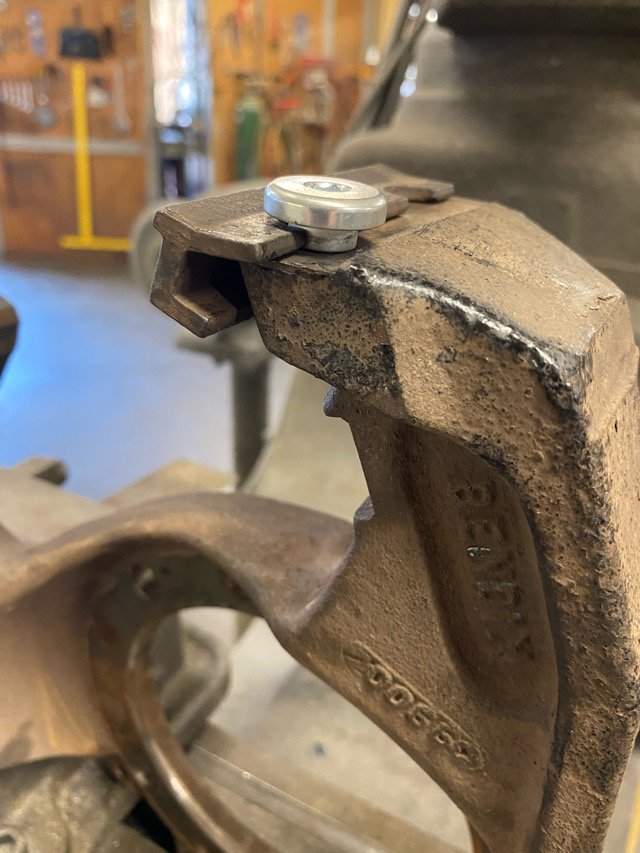

    Used a carbide 3/16” end mill and got the easy out out and through then went to 3/8” carbide, drilled it X, tapped it 7/16-14 and installed a 5/16-18 thread insert.

    The guy this is for said his truck has been down for a week, he’s ordered two of these and they sent the wrong one both times. He was on his last straw with me, I’m glad it was fairly easy :thumbsup:
