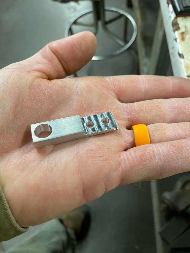

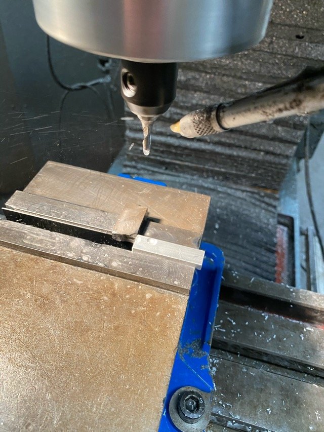

    I have 45 of these to make which is a large production run for us, we usually make <5 of something.
    Our mill doesn’t have a tool changer and I was dreading changing parts numerous times and tools.
    It hit me on the way in, use a 3/16” end mill (the size of the small holes) and do it all at one time.
    I faced one end off yesterday, doing it all in one step now :bananadance:

    Cool, looks like some kind of electrical terminal connector

    It's getting a bronze bushing pressed in the 3/8" hole and it goes in a uniform facility. Not sure what it does there though.

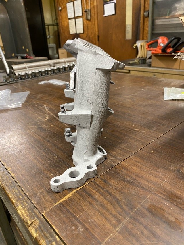

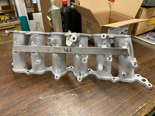

    This is going to be fun when I get to it. Customer wants to mill 3/8” off of the top of this so he can weld it to something. He welded a bar to it for support.

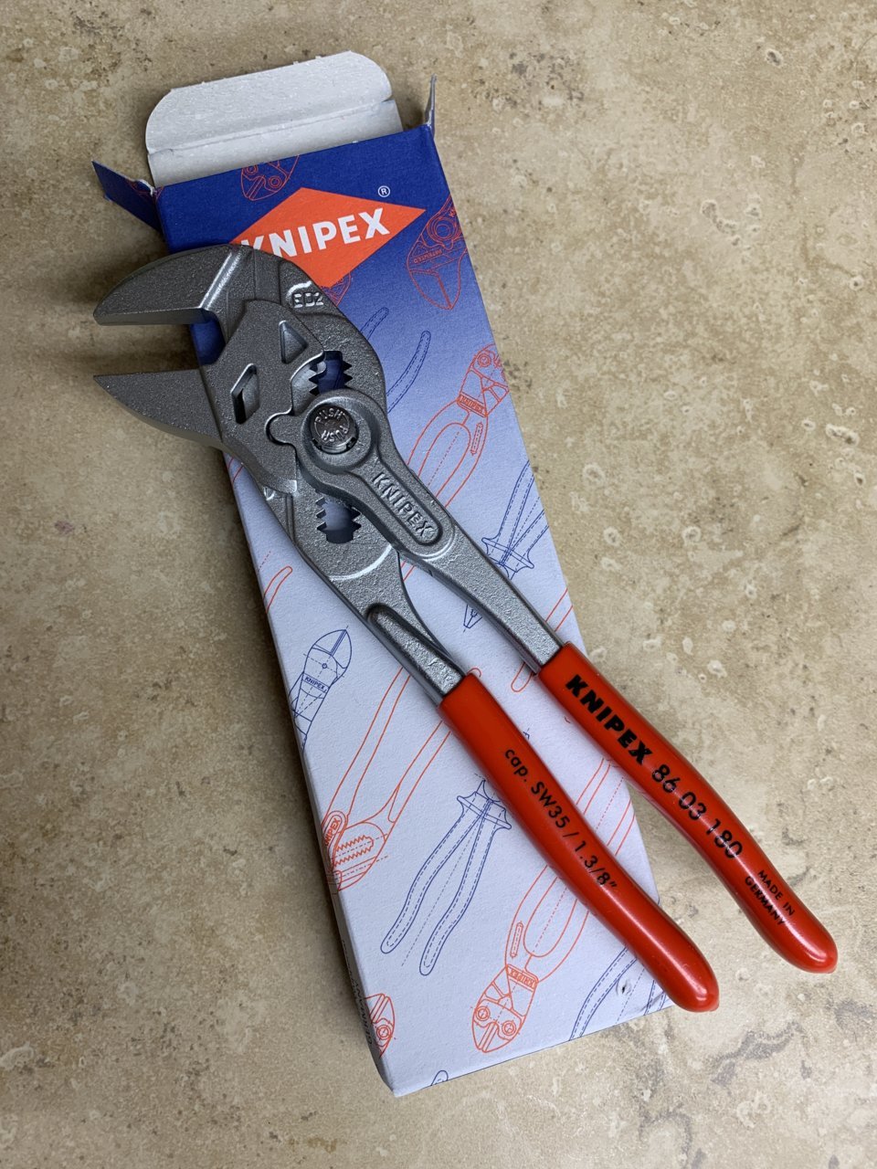

    Never seen any of these, let us know how you like them :thumbsup:

    wth is that? Left handed Channel lock crescent??

    They’re classified as pliers-wrench. They have locking grip range settings, are gear reduced, and hold parallel to not slip off bolts or hex fittings. So in simple terms, a multi-sixteenths, semi-automatic, crescent wrench!
    We’ll see how they work out. I’m sure they’ll have their place in my tool chest!
