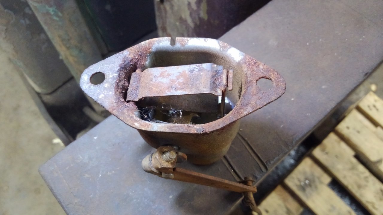

    It is a Sisson automatic choke control, commonly found on Chrysler cars from the 30s-50s.
    The bimetallic spring closed the choke about 1/2 way when cold, when the starter was engaged the solenoid closed the choke the rest of the way. Once the starter was released the solenoid dropped out putting the bimetallic spring back in control to gradually open the choke as it heated up.
    This came on a Wisconsin twin cylinder engine from 1964.
    IPNPULZ is right: "a critical part that if that does not work that motor won't run...." If it sticks open the damn thing won't start, if it stick shut the damn thing won't keep running. :laugh:
    Installed photo, right under the flying saucer muffler, the link runs down to the choke, the solenoid wire went to the terminal on the top front of the unit above the arm pivot.

    You figured it from; bang...squish, squish,squish, bang?
    I'm still wondering. I've seen something that looked similar on old Chevy manifolds and something a bit different on some exhaust manifold. Heat risers.

    Bimetalic/climatic same difference gosh darn it

    You were on the right track -- most folks here might not know what a heat riser was much less fussed with them.
    I wired many open to stop them from rattling after the spring broke.

    Well you did re teach me something too, because I had forgotten about the two different metals, bimetal :bowdown:
