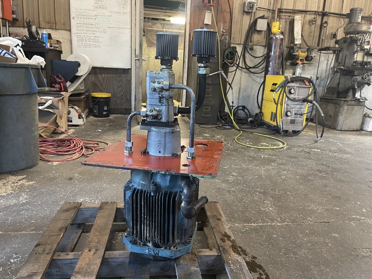

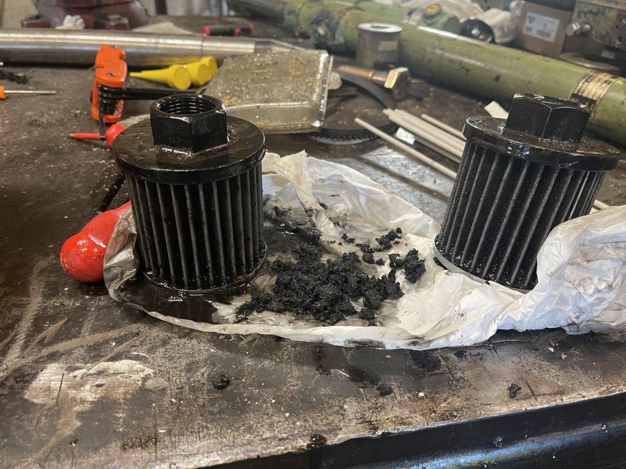

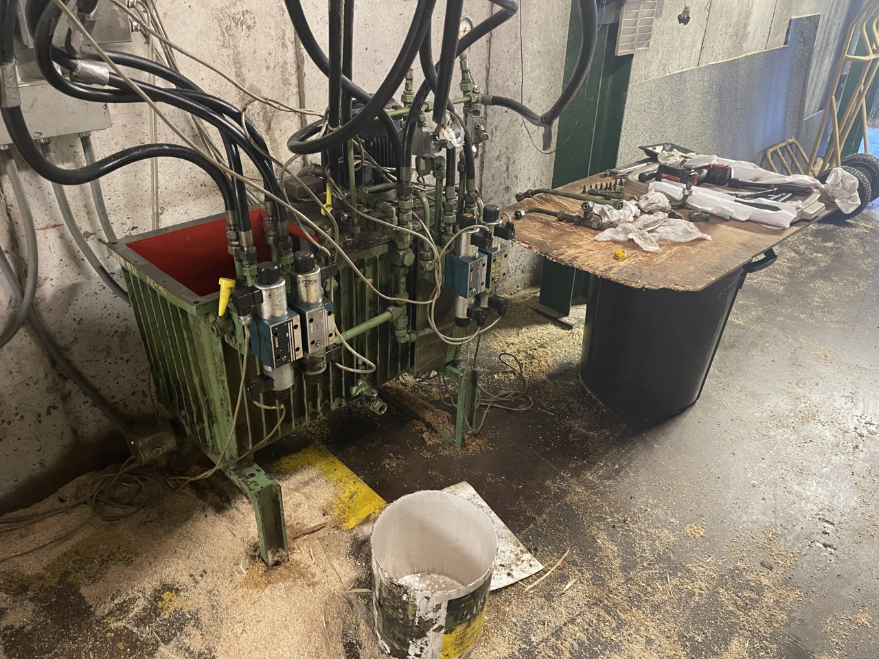

    Update on the tank situation. Our vendors were able to source replacement pumps, but they're two days out. The exact pump from the original company is a 16-20 week lead time, so that's definitely not happening. Flushed the old pumps, put new filters on and new fluid in the tank. About to put it back together and hope for the best for the next two days. CB49B619-9F76-47B4-9002-11D19C0DC395.jpgBAA76113-D22D-4C5B-8E52-A09BC492ADF7.jpgBD13C42D-7507-4C22-8524-5DFA5506B1E2.jpg

    Looks like the filters were doing their job, and beyond. I think those pumps will still be ok but surely not like new.

    Well, the entire reason we pulled this out was because this hydraulic unit powers some feed roll cylinders on one of our sawing machines. One set of cylinders was acting very laggy and slow. One of the two pumps attached to this motor sounded like marbles in a blender when activated, but it's been sounding that way for months supposedly (before I started at this location). We swapped valves, replaced cylinders, tried everything without having to pull this apart. Finally the only thing left is the pump, so here we are. And when I pulled those filters off, the smell of burnt hydraulic filled the shop.
    I guess the point of that explanation, is that the pumps are toast, but not fully cooked yet.

    According to the site supervisor, this hasn't been apart since he's been here. (Nearly 5 years) and this unit runs 10 hours a day five days a week.

    It's a bit frustrating that I said "hey, it's probably the pump." On day one, but the supervisors insisted on trying every valve/cylinder combination and going over diagrams and schematics for three days before finally saying "we're pretty sure it's the pump."
    At least we finally agreed on that decision and got it out and figured out. At the end of the day I've done my job, done what I was told, and got praise for doing exactly that.

    Final update on the hydraulic fun. Total start to finish time was five hours. That's with nobody present having ever taken it apart before and not knowing what we were going to find inside. I think I could do the whole operation in two hours next time as long as it's just changing the filters and putting it back together. The whole unit has been assembled for an hour and runs fine, new filters and the pump runs quiet again. All functions are present and accounted for as well. New pumps will be arriving in two days and then I'll pull it back apart to swap those in, and keep the old ones for emergency backups.
