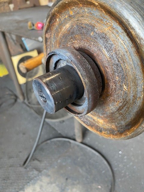

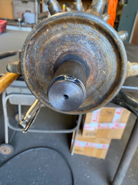

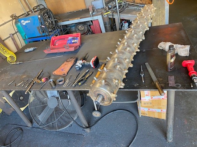

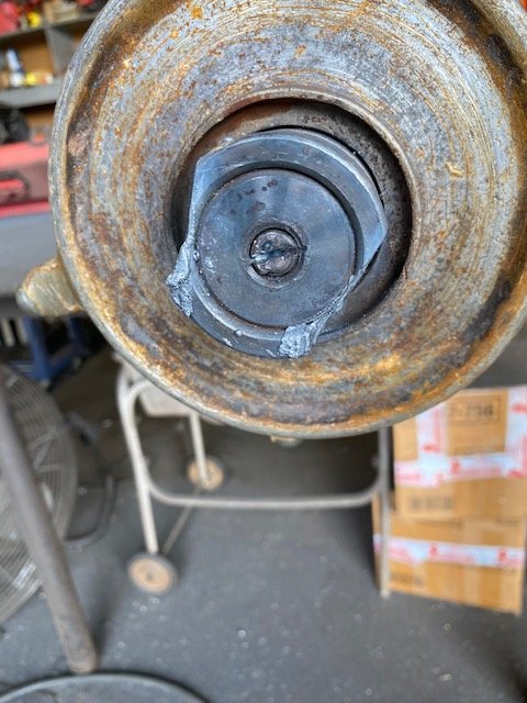

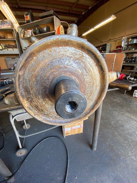

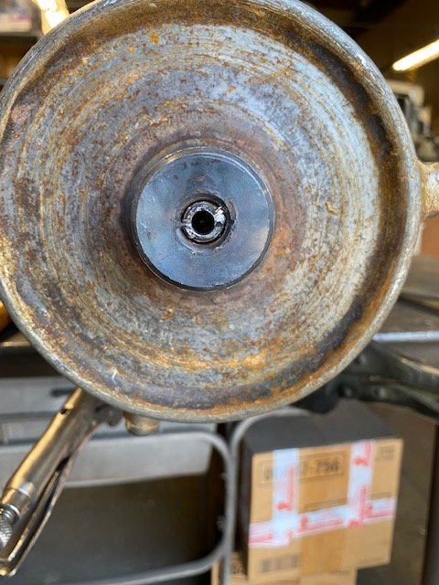

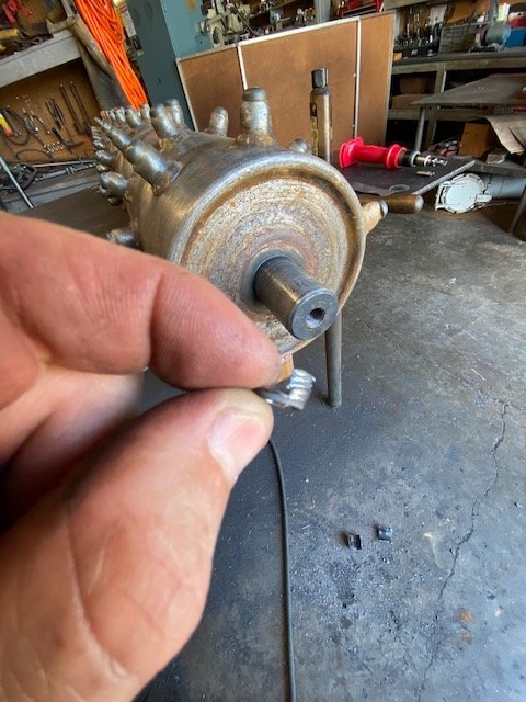

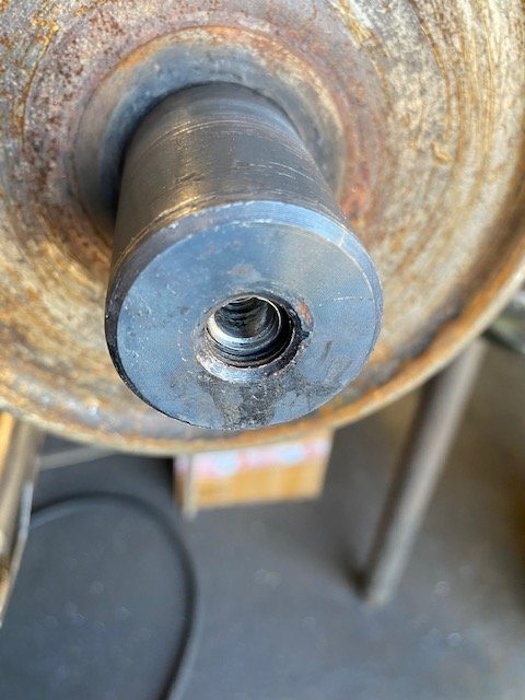

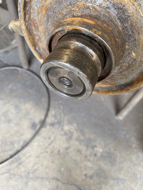

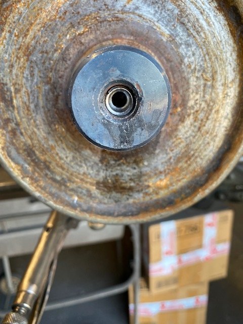

    Guy brought in a roller off of a harley rake with a broke bolt and bearing race that needed to be removed. Bearing race was no problem, hot wrench on it.

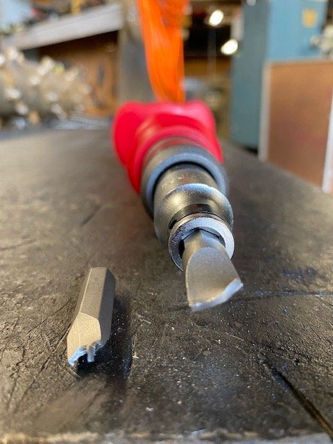

    Took the dremel tool and cut a notch in the bolt hoping to get lucky with the new MAC impact driver :facepalm:

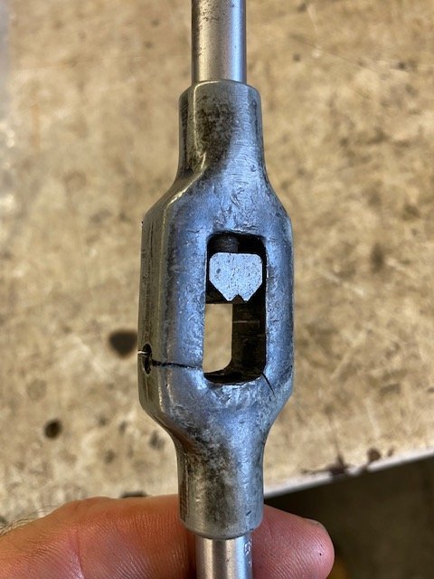

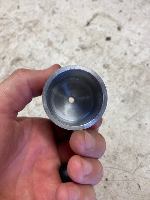

    Went to the lathe and made a piece to keep me centered so I could drill it, heat it, and use an easy out(s) to extract it, never budged :frusty:

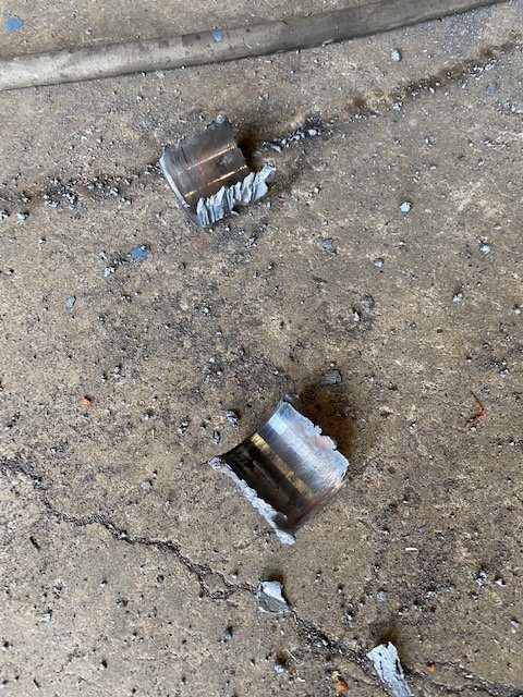

    2 1/2 hours later, 5 easy outs, lots of heat, oil, etc. and more drilling this is all of the bolt I managed not to turn into chips. It was 1 1/2" long and 1/2-20 :goingcrazy:

    ARE Topper, Icon aal, OEM Audio+
    LH threads? Hate it when something fight you the whole way like that.
  12. Aug 10, 2021 at 7:23 AM
    six5crèéd
    six5crèéd [OP] Be the light
    Jul 9, 2019
    #298734
    35,954
    Southern Virginia
    8 lugs no plugs
    No, they were right hand. I don't know why it wouldn't come out. Figured maybe it had loctite on it but the heat would have broken that loose. I left about 3/8" of it in the bottom and I couldn't get that to turn out either.
  13. Aug 10, 2021 at 7:47 AM
    My Name is Rahl
    Jul 5, 2018
    #258370
    22,105
    Cross threaded?
    tacotoe, T-yoda, RustyGreen and 2 others like this.
  14. Aug 10, 2021 at 8:01 AM
    six5crèéd
    Jul 9, 2019
    #298734
    35,954
    Southern Virginia
    8 lugs no plugs
    Don't think so, he said the other end came loose and caused the bolt to break off.
    tirediron, T-yoda, RustyGreen and 3 others like this.

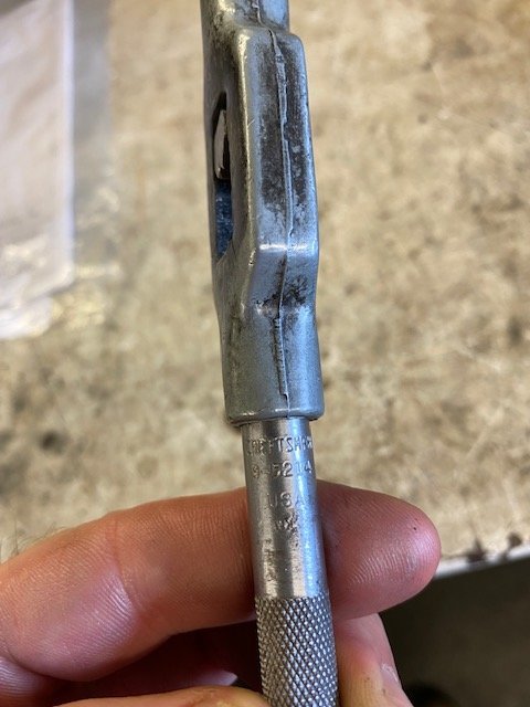

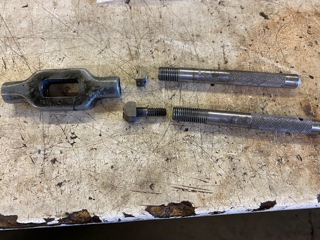

    Craftsman with lifetime warranty? Probably can't even find one of these now, time to make a new body.
  17. Aug 10, 2021 at 9:59 AM
    tirediron
    tirediron Well-Known Member
    Jan 19, 2019
    #279864
    3,891
    John
    Victoria, BC< Canada
    2022 4x4 Sport, Auto, BCM
    Might have been damaged threads combined with a bit of corrosion? Either that, or whomever put it in last used their 48" breaker-bar and their full body weight to tighten it. I had to get a bolt out of my climbing spikes to change the gaffs; threaded part was only 3/8" long, but it was in there - I even went so far as to weld a sacrificial hex bit on to it... just twisted out the metal of the head. Took two hours with a Dremel, needle files, and a LOT of profanity to get it out of there, and like 'Creed, I wound up with a piece of thread about 3/16 or less that was so thin, it looked like a Heli-coil.
