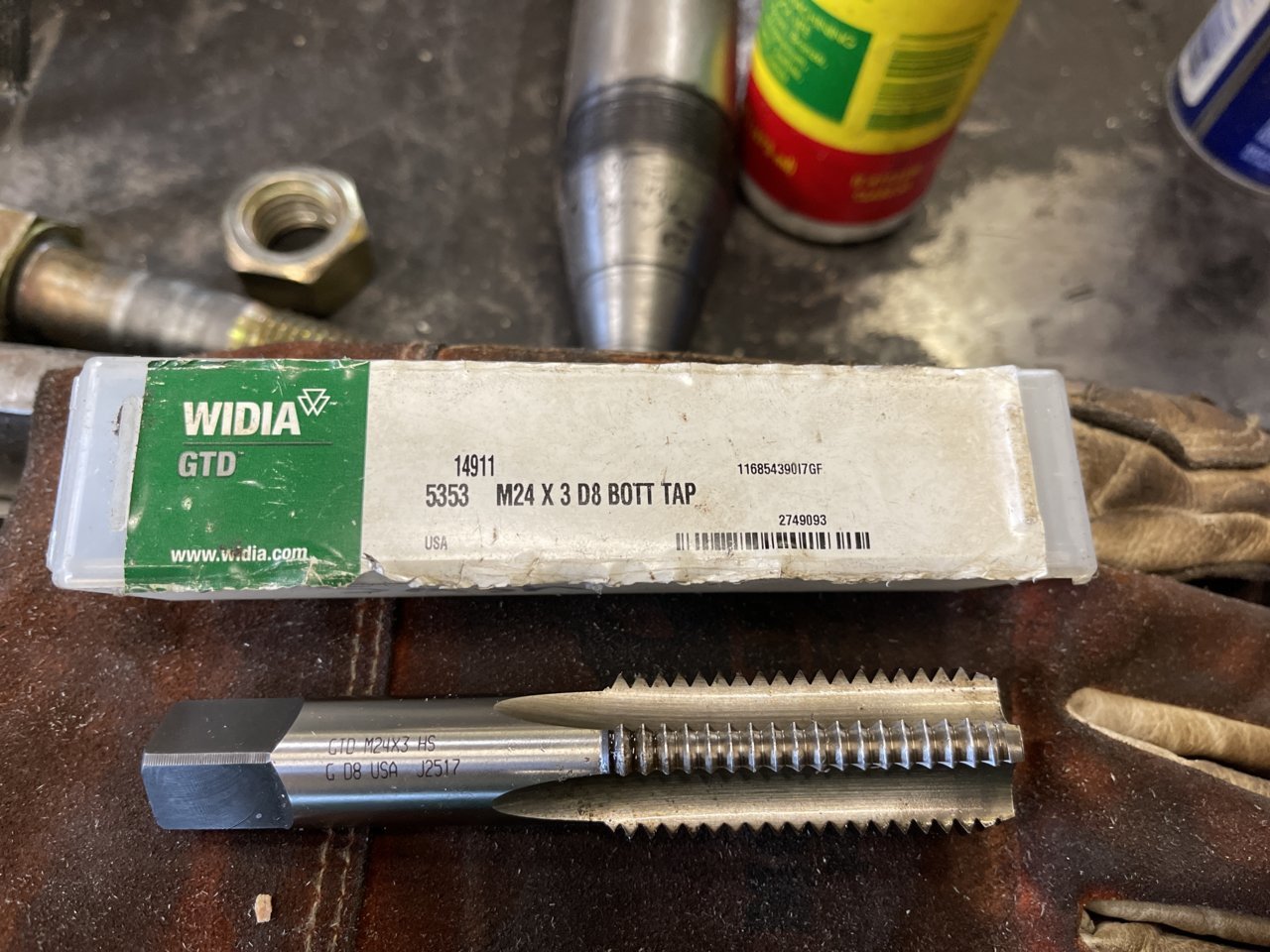

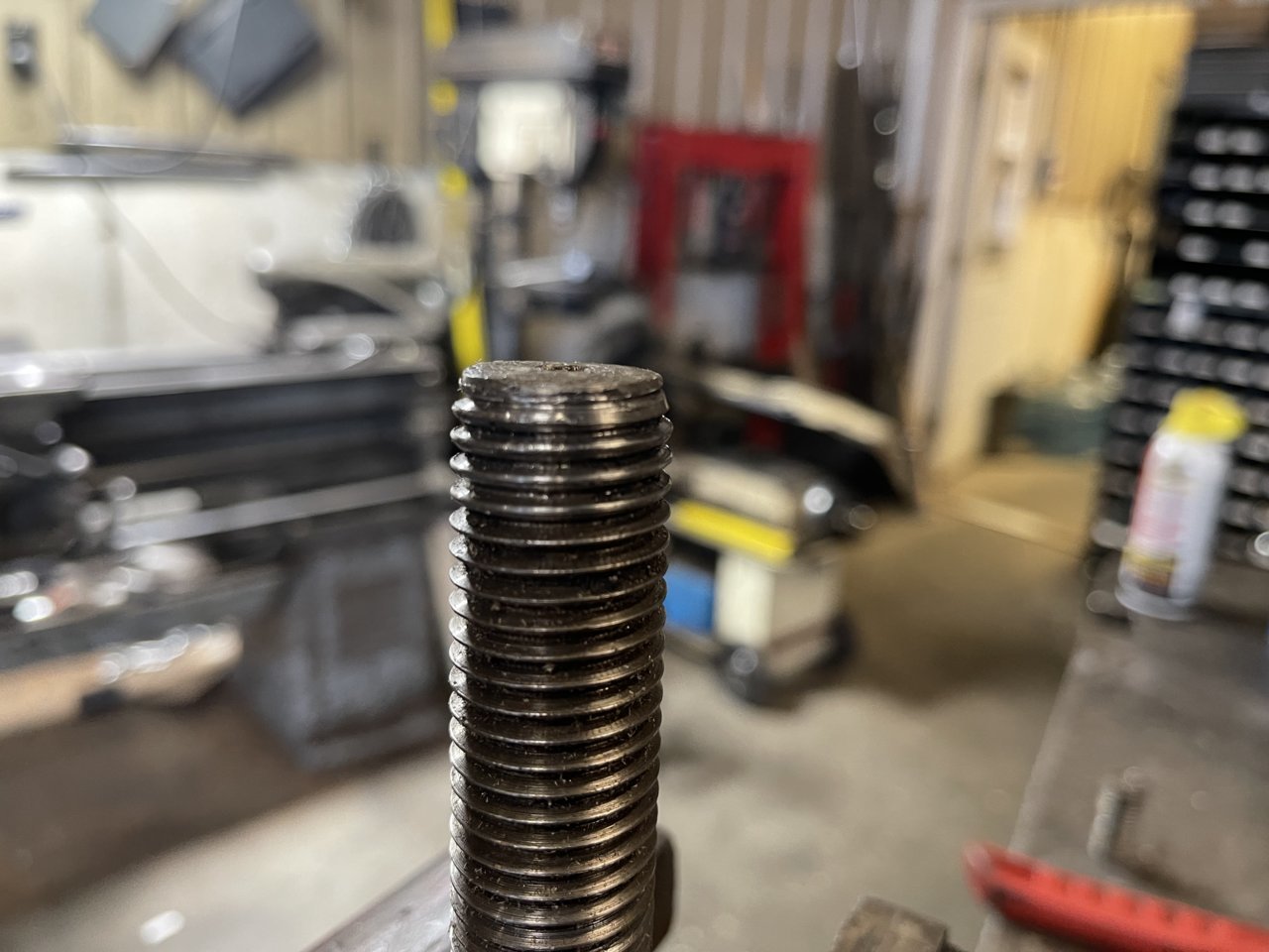

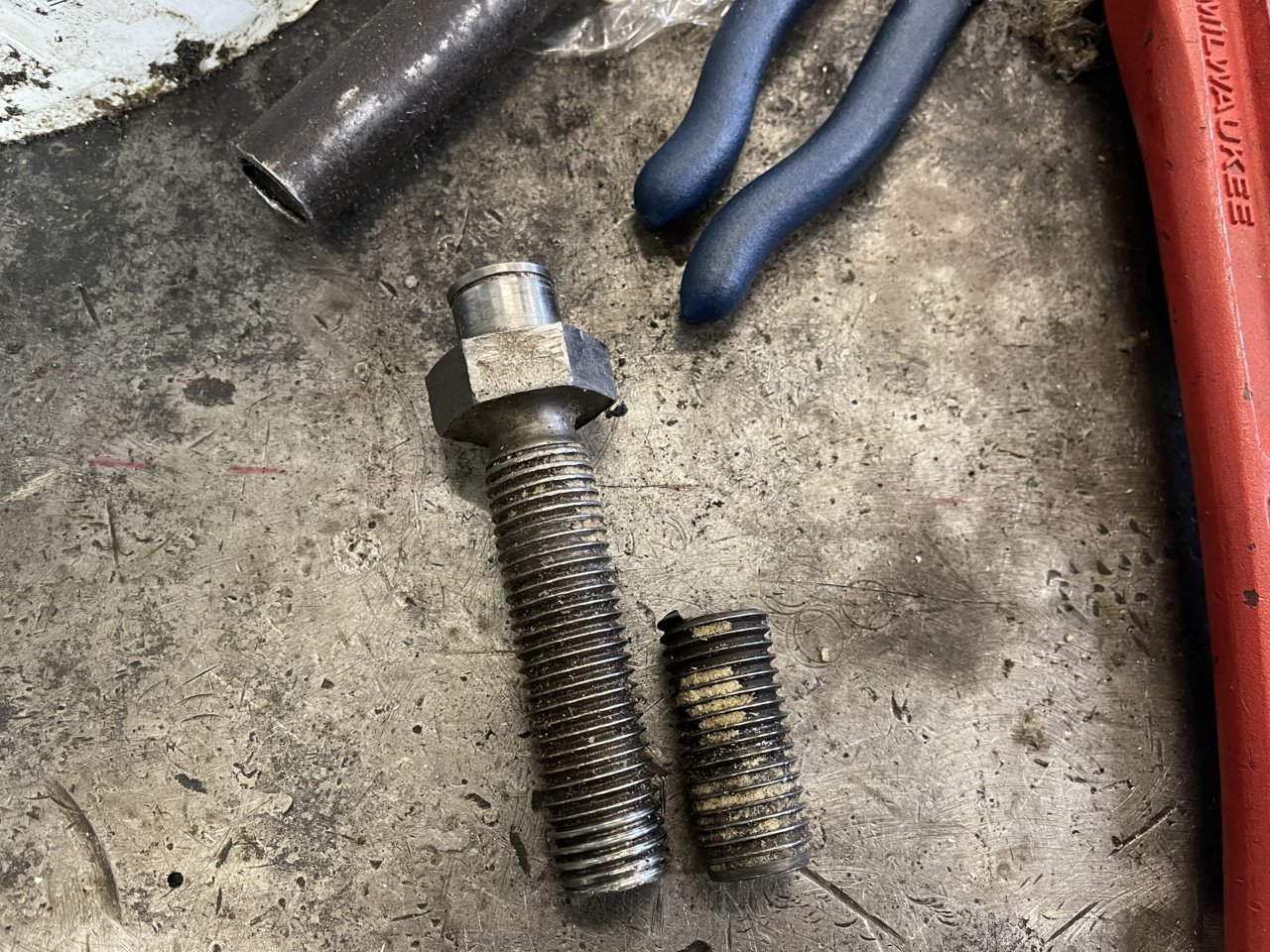

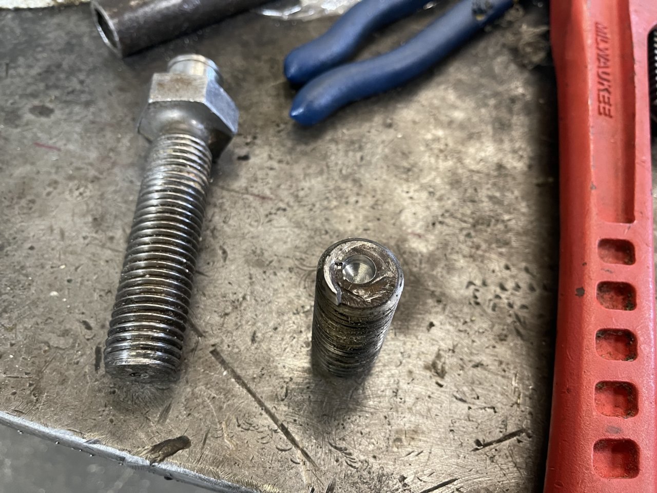

    Morning y'all. Little bit of carnage and luck to start the day. Boss messaged me last night asking me to come in early since they broke a bolt off in our gang saw. Luckily for me it's a through hole, so after a bit of drilling it screwed itself right out the back with no extractor needed (I had one ready though.) The new bolt they tried to put in went in easy at first then munched the threads. The threads in the hole stretched and I ended up having to re-tap it with a bottoming tap. Now it's all back together and everyone is happy! Except for these bolts... 668A5A26-8A03-4EE5-8DBD-C7C8DF1C1242.jpg947ABCEC-B1EA-41D1-AE65-35E785AA9245.jpg32F94BFF-31A0-4AF3-BB5D-A89AF40C68CF.jpg

    I just discovered what grinds my gears. Coworker was looking at the tap I used this morning since they had never used one this big. When they were done, instead of putting it back in the case, they casually tossed it onto our steel workbench. I nearly came unhinged.... image.jpg

    I was going to ask if that was an 1"-12 bolt, but then I scrolled down to see it was metric.

    Yep, we have two machines in this mill that are German- all metric. So now my toolbox is split between metric and standard.

    That's some money right there! Even a 1" tap can run up to $400.

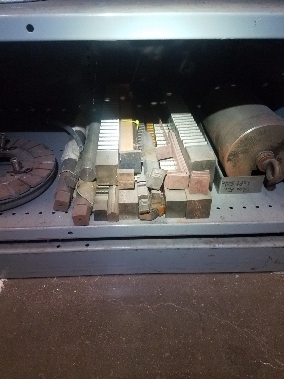

    We have some larger broaching bars too. I had a opportunity to use these but opted to send the parts to a shop in Lincoln NE, and have the key ways wire EDM cut.20210812_082828.jpg
