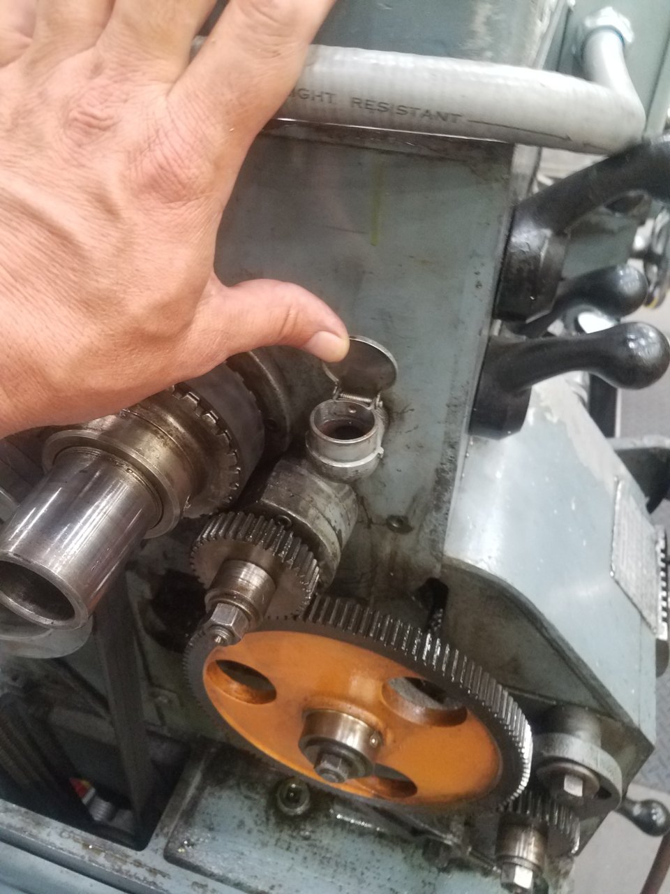

    @BananaMan , has the capability to fix all that stuff though. Be nice to find the original manual. I think a spring/ball detent possibly keeps that handle up to run. It looks like it's upwards enough it should be running. Regardless that is a easy fix and should be addressed. I took some pictures of maintenance on little blondie I did today.
    Quick change box way low on oil.

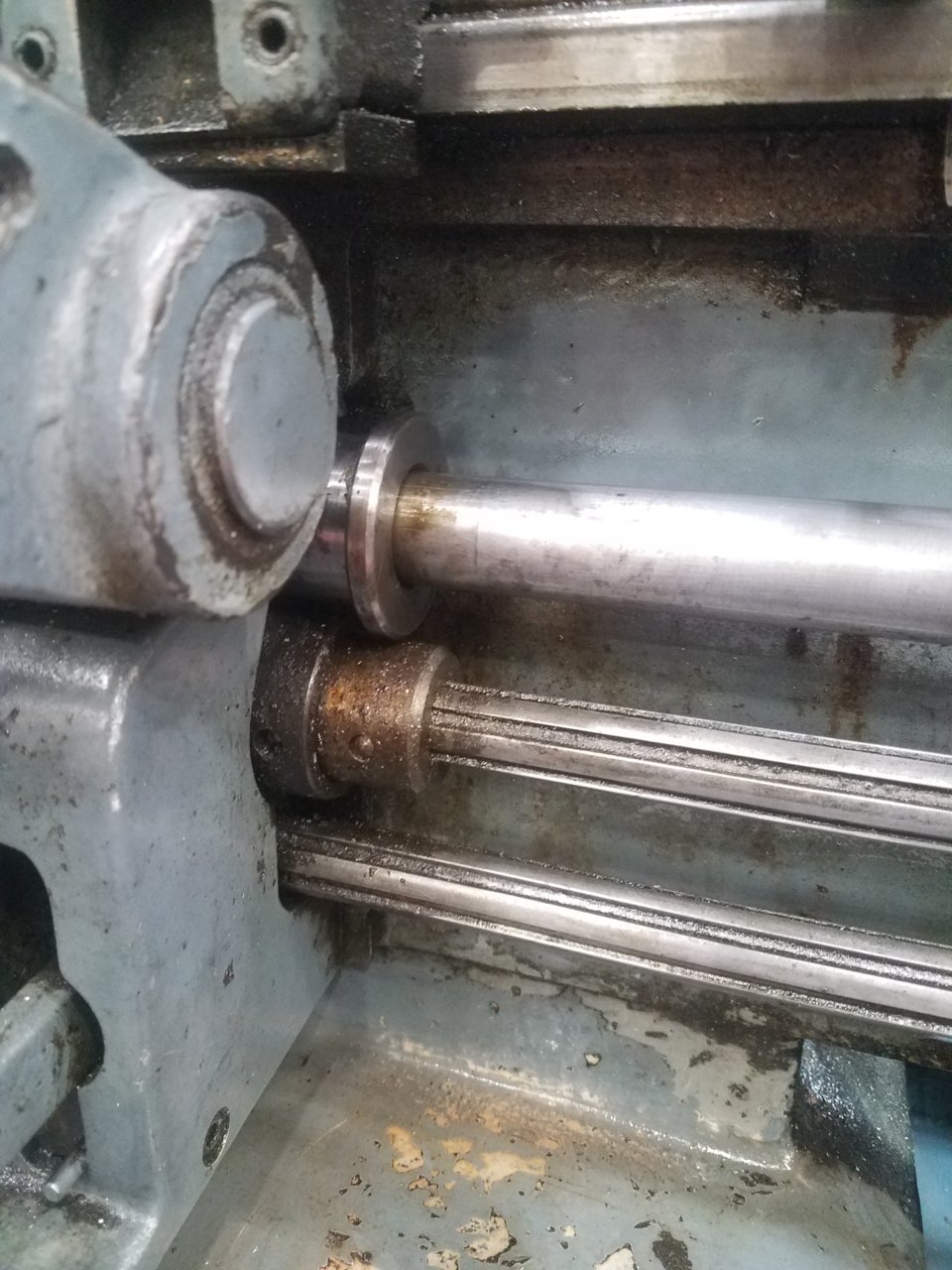

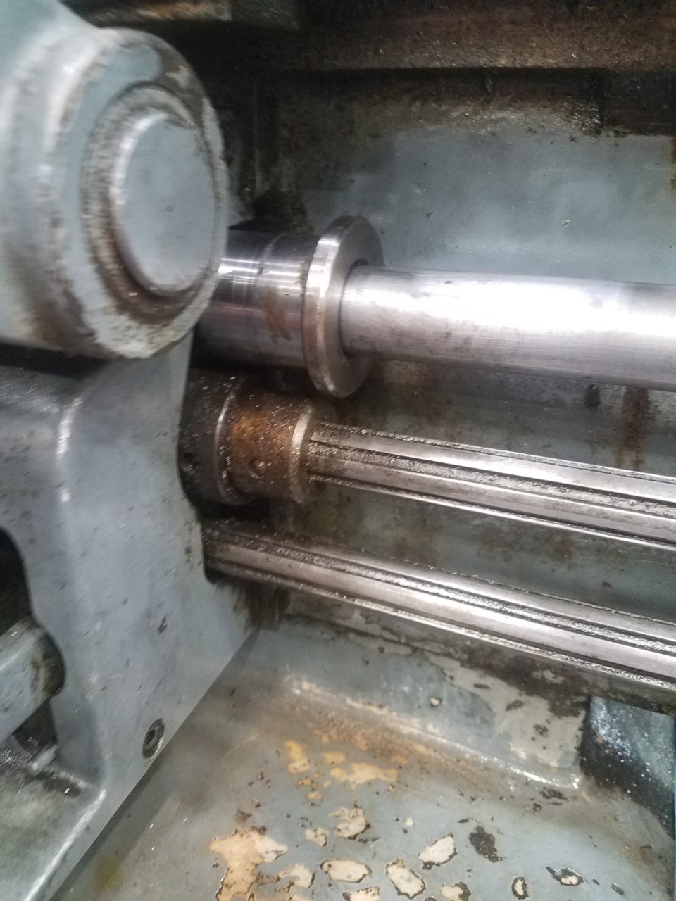

    Some pictures of maintenance talking about earlier.

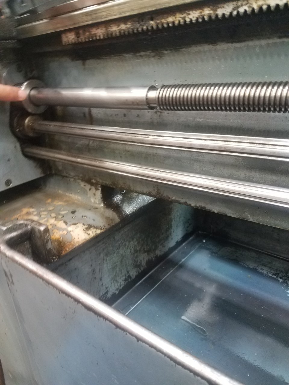

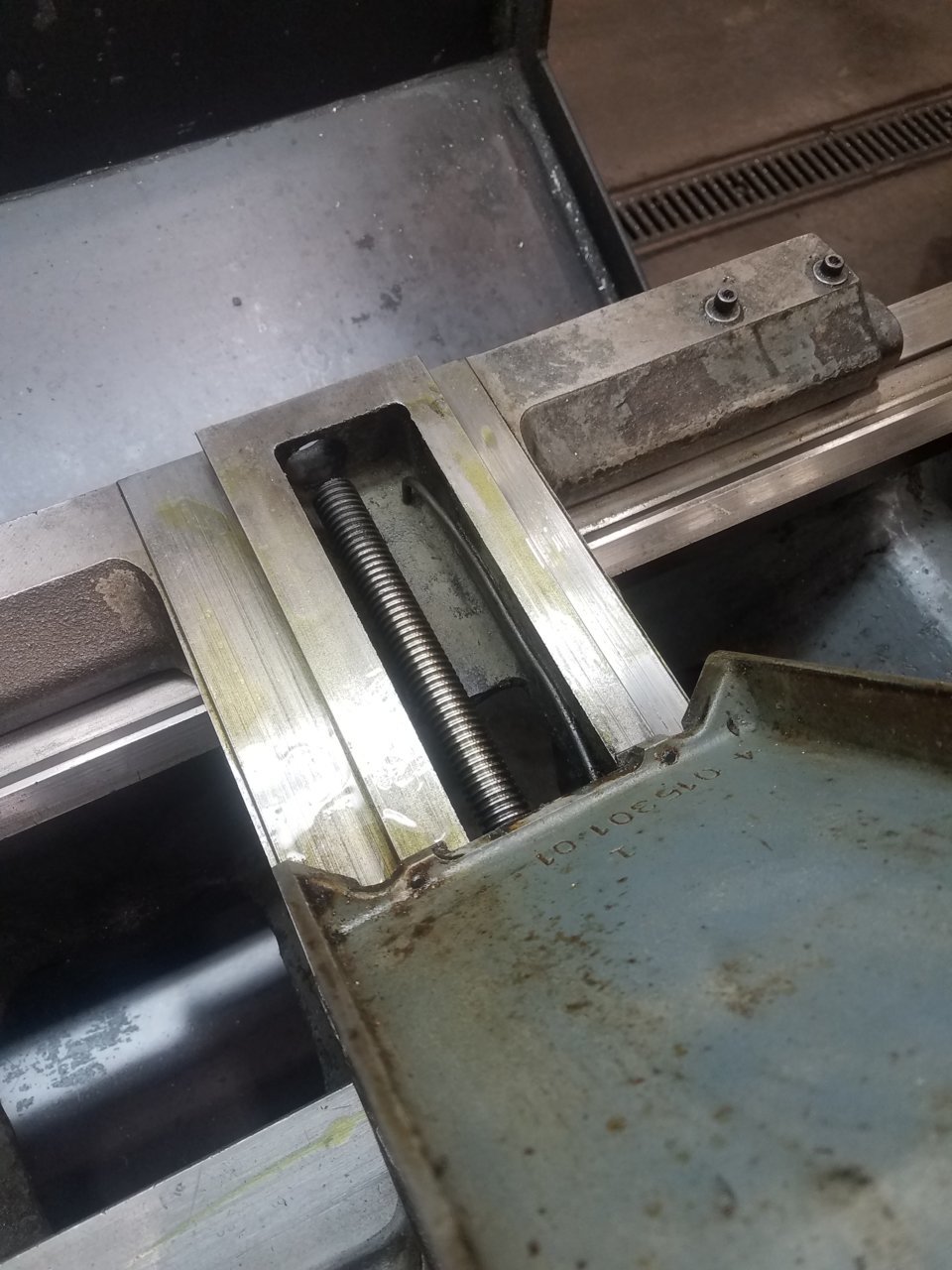

    This is called the lead screw and is what you will use when threading. This piece on the end will slide in/out to engage/disengage 20210812_151202.jpg 20210812_151208.jpg 20210812_151216.jpg

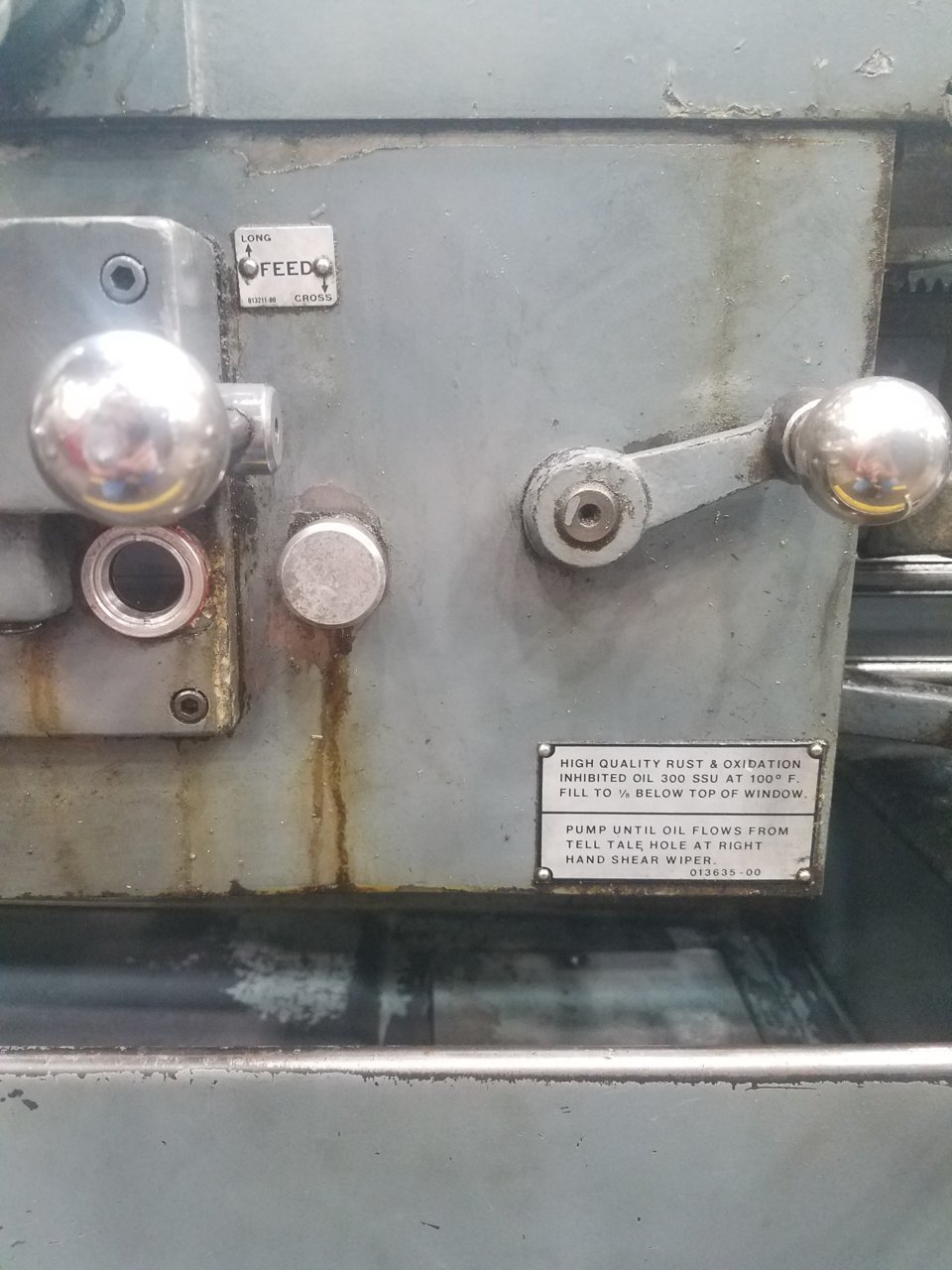

    Middle photo above are the feed levers. The lever on left is longitudinal then pull out and operate for cross feed. The levers to turn the spindle on (like one with string on it) I believe are taper pins, may be wallered out or rigged with something else sloppy.
    The lever on the right (looks like one bungee cord on yours) is for engaging to the screw when threading.

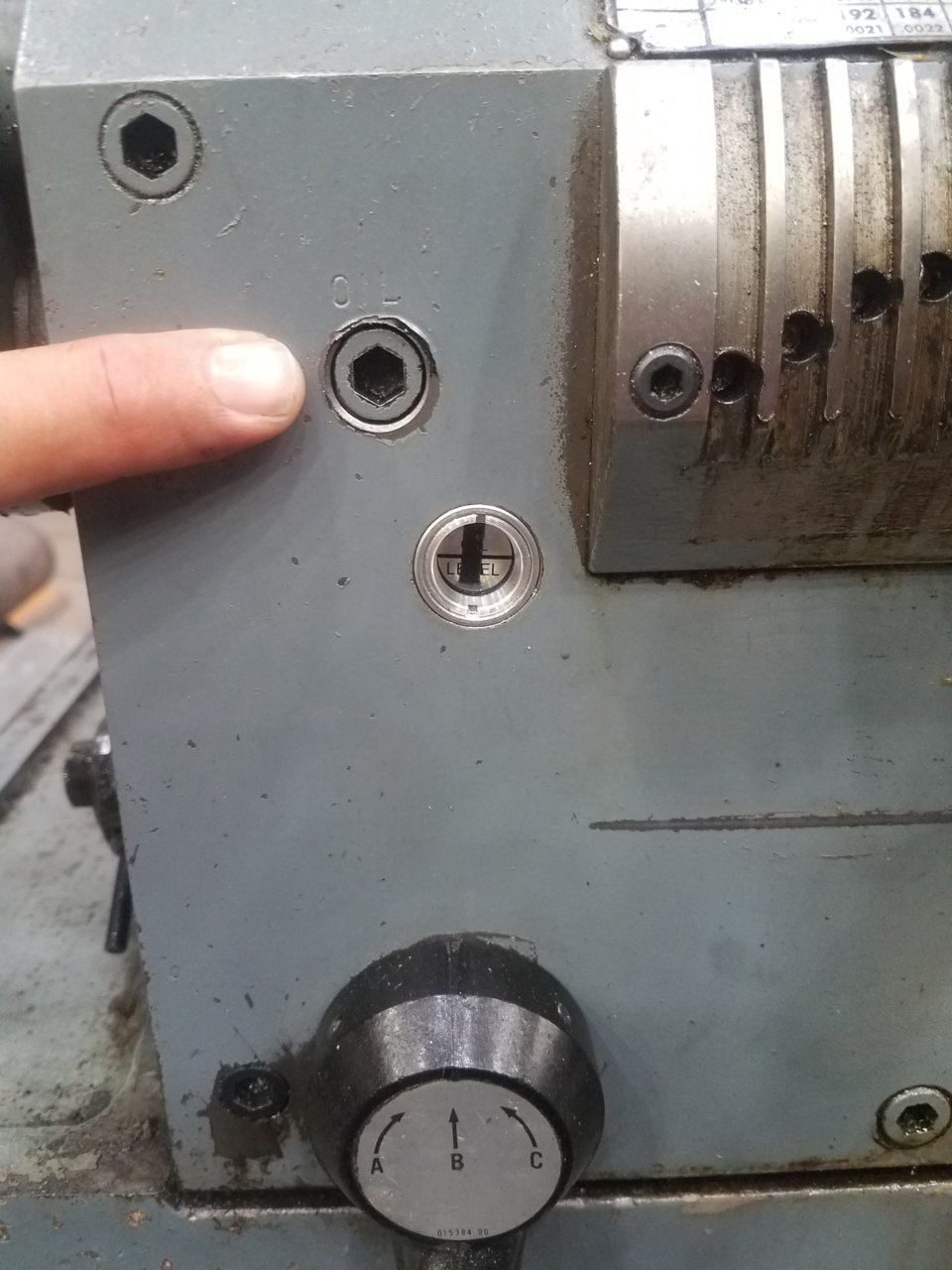

    This is the sight glass for the quick change gear box. I topped it off today. Finger by fill plug. I replaced the sight glasses a couple years ago. Hate to admit but I was so miserable working with dipshit, that I stayed as far from the shop as possible and let much stuff go, my give a care was a little broke.20210812_153509.jpg
