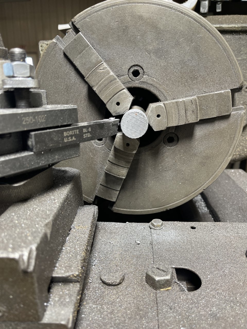

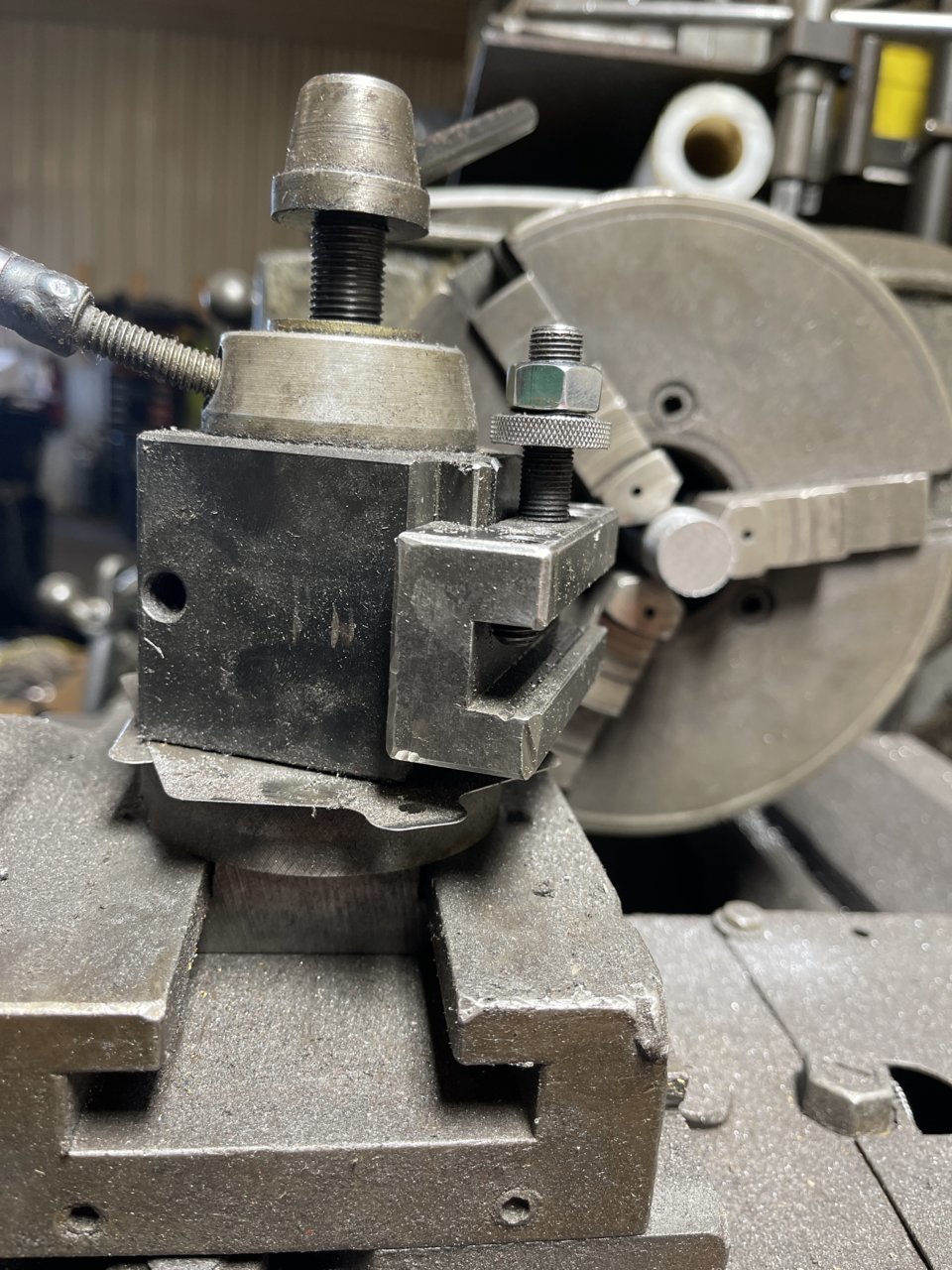

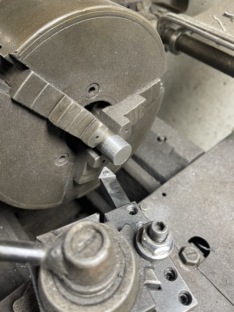

    Alright... I'm doing something wrong I just don't know what. 3A956568-4596-495E-9ECA-68422D50C6D2.jpg

    Looks like the cutting insert may be worn, can you rotate it to a new side? Maybe slide it back in the tool holder a little as well, seems to be sticking out which will give you more chatter.

    I'll try both of those. Is it making contact too high up on the piece? This is where everything was when I started position wise so I didnt adjust anything really, hoping it would just work :oops:

    Yes it's too high, needs to be just a touch below center :thumbsup:
    Opposite on a boring bar, it would need to be a touch above center.

    If you've found a center for the tail stock that tip will get you close. Another trick to get close is (with spindle off of course) bring the tool up to the bar stock with a 6" rule in between so the tool hold the rule there. Then step back and eyeball that, rule straight up and down. Then after facing the end off you can use that little teet to set center.

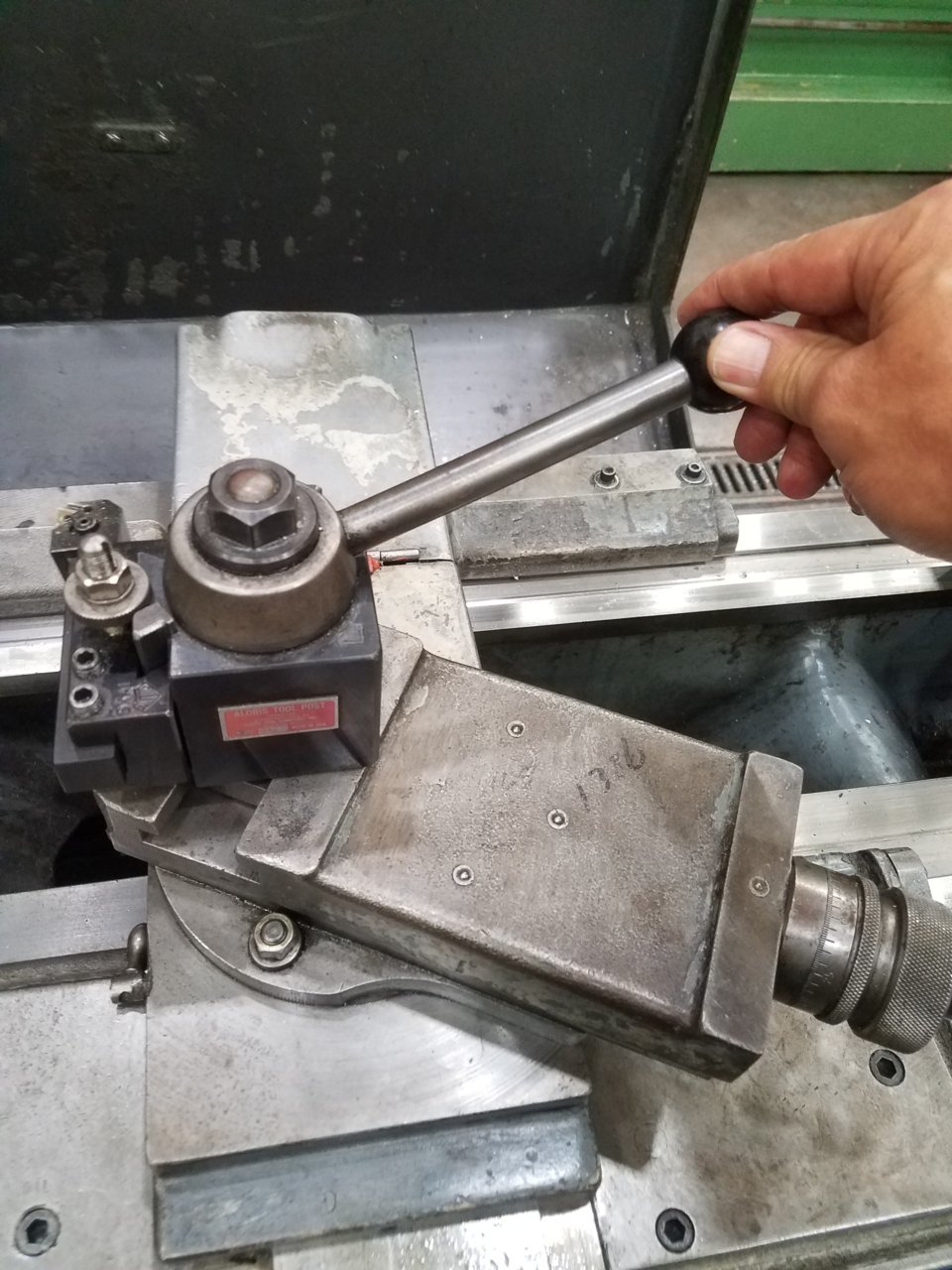

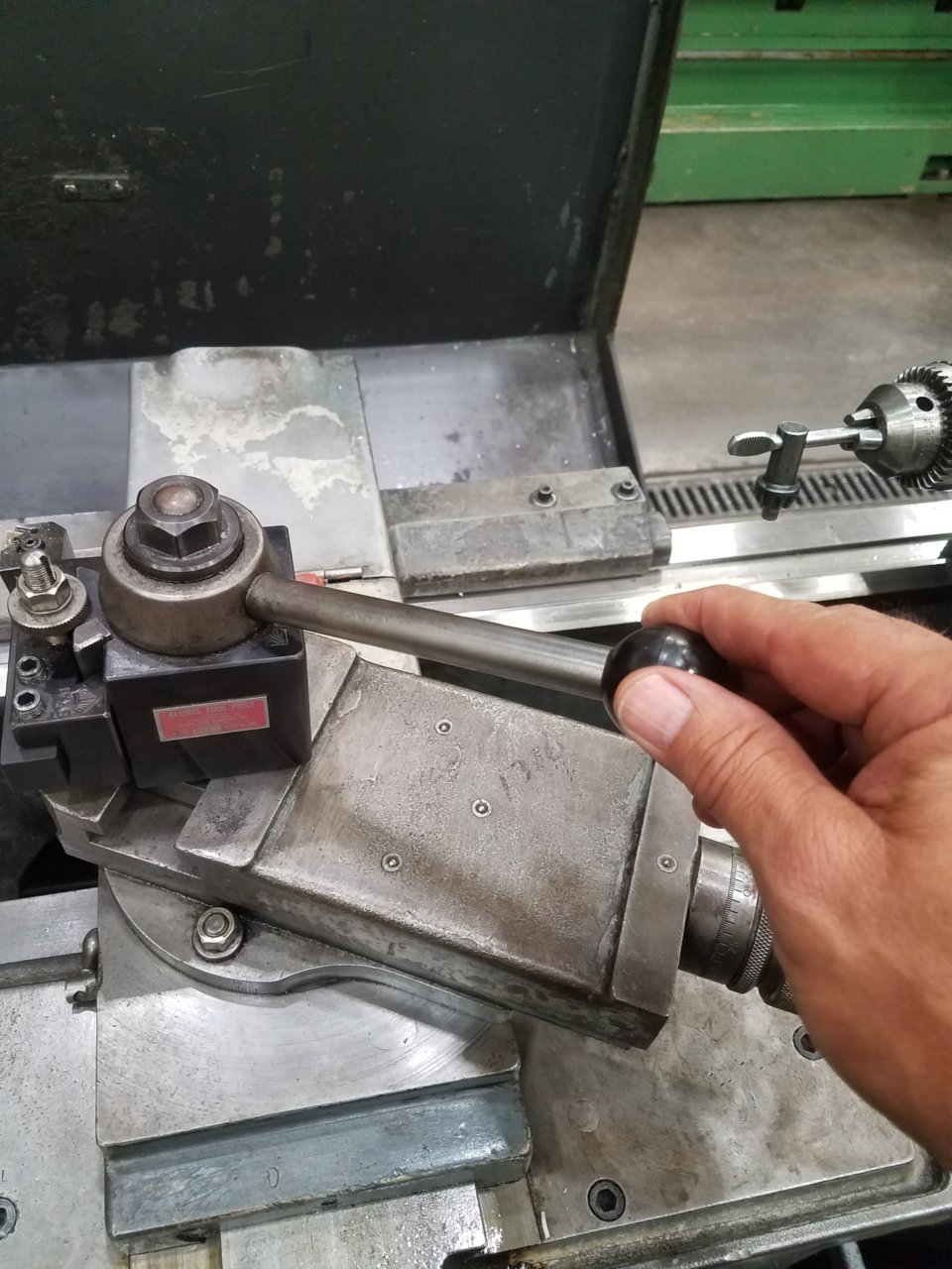

    Turn the handle on top, it releases the wedge then unscrew the nut on the tool holder.

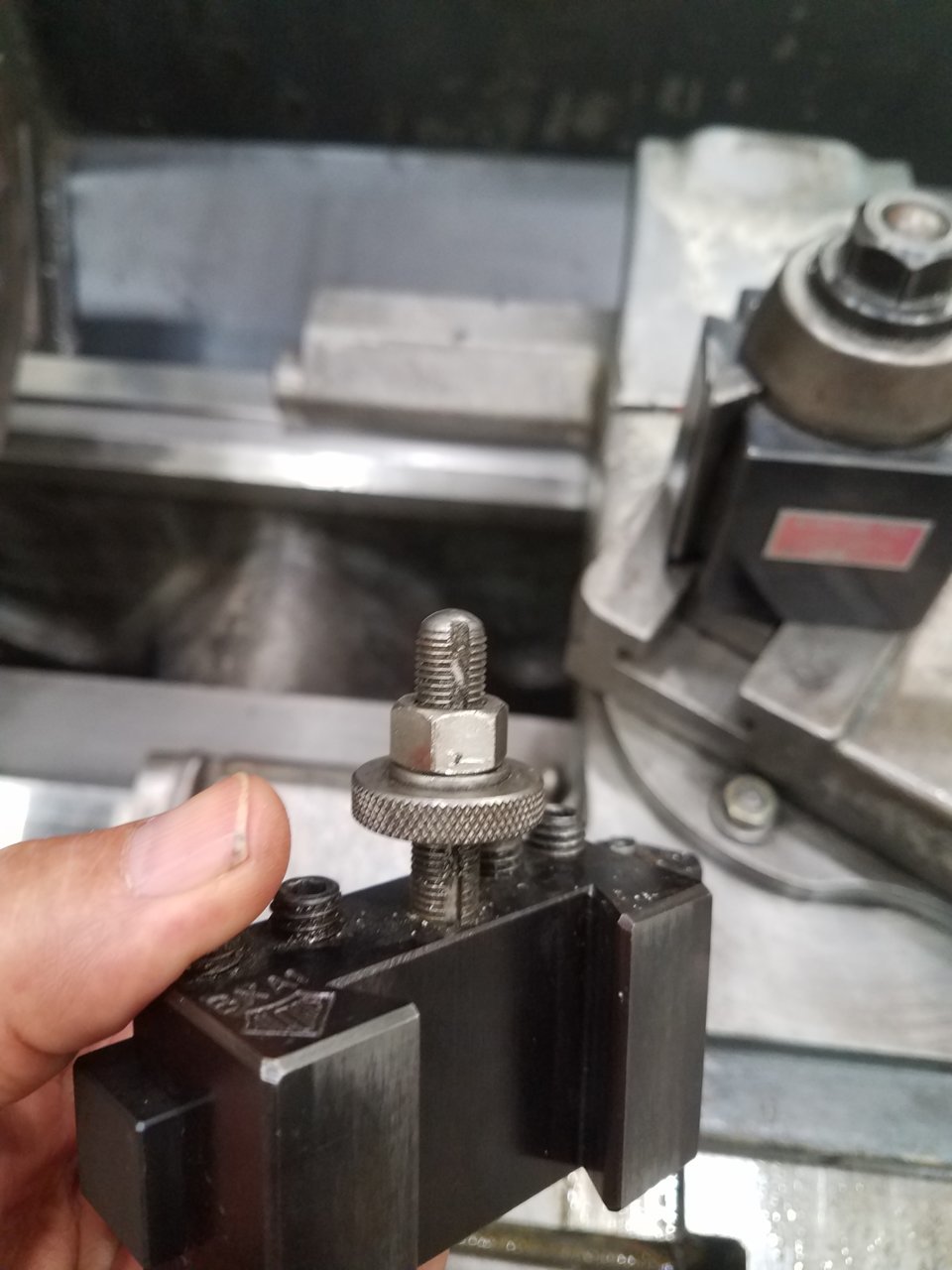

    Lock, unlock, loosen jam nut then adjust 20210903_140037.jpg 20210903_140040.jpg 20210903_140053.jpg

    Tighten that top bolt back down. The piece below it should unlock the tool holder.
