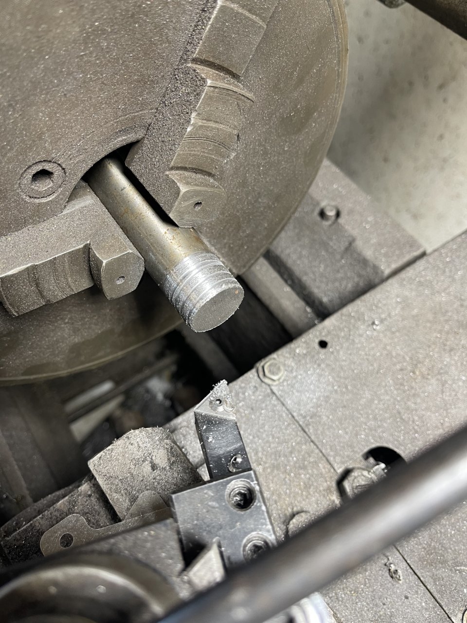

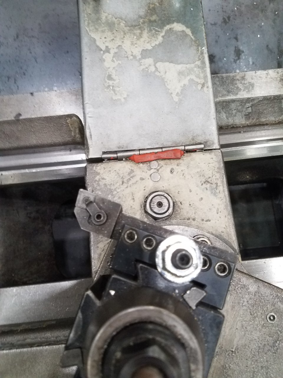

    If you wanted to you could loosen that top piece back up and get your insert at a little better angle too.

    tacotoe

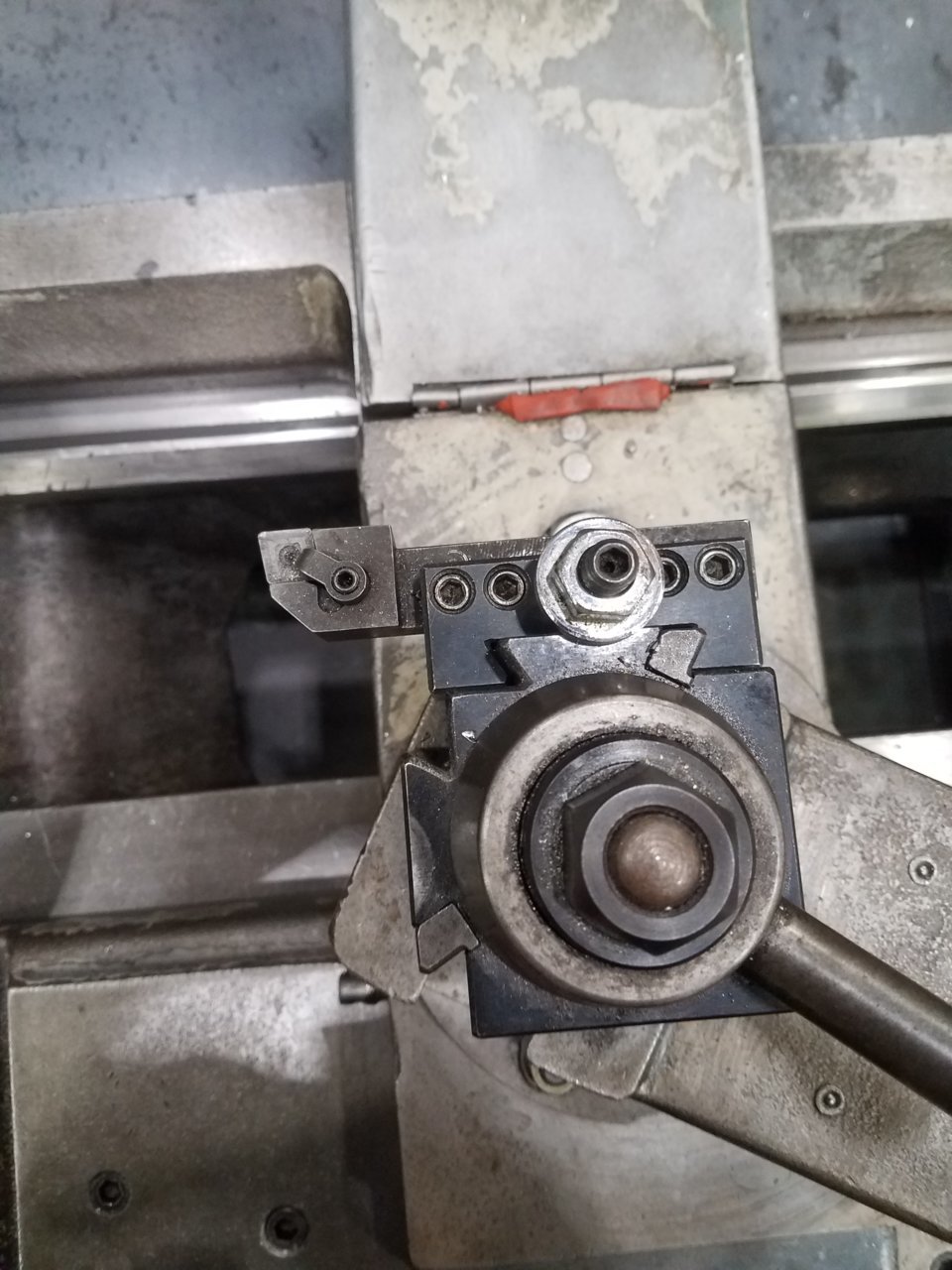

    Like the tool you pictured, if that was all I had then would adjust to like second picture for turning OD 20210903_141046.jpg 20210903_141132.jpg

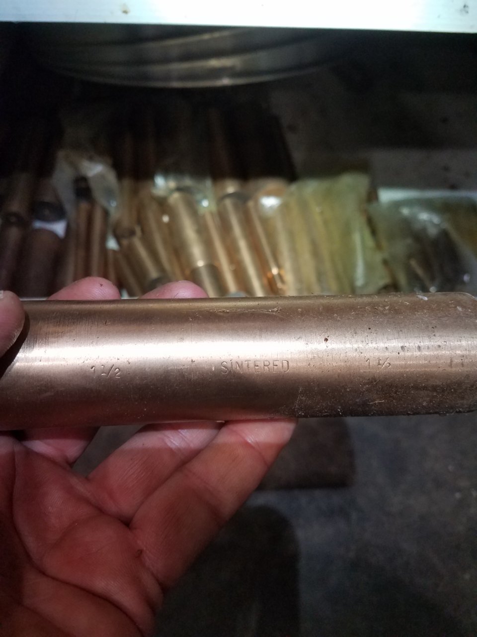

    Then after mastering the bushing fabrication, have them purchase some bushing stock.

    Another question... how do you get the locking handle to lock not on top of the chuck? That's where it tightens up right now, obviously won't work there. 2D08945D-E85B-472A-97E5-EEC63FC8A471.jpg

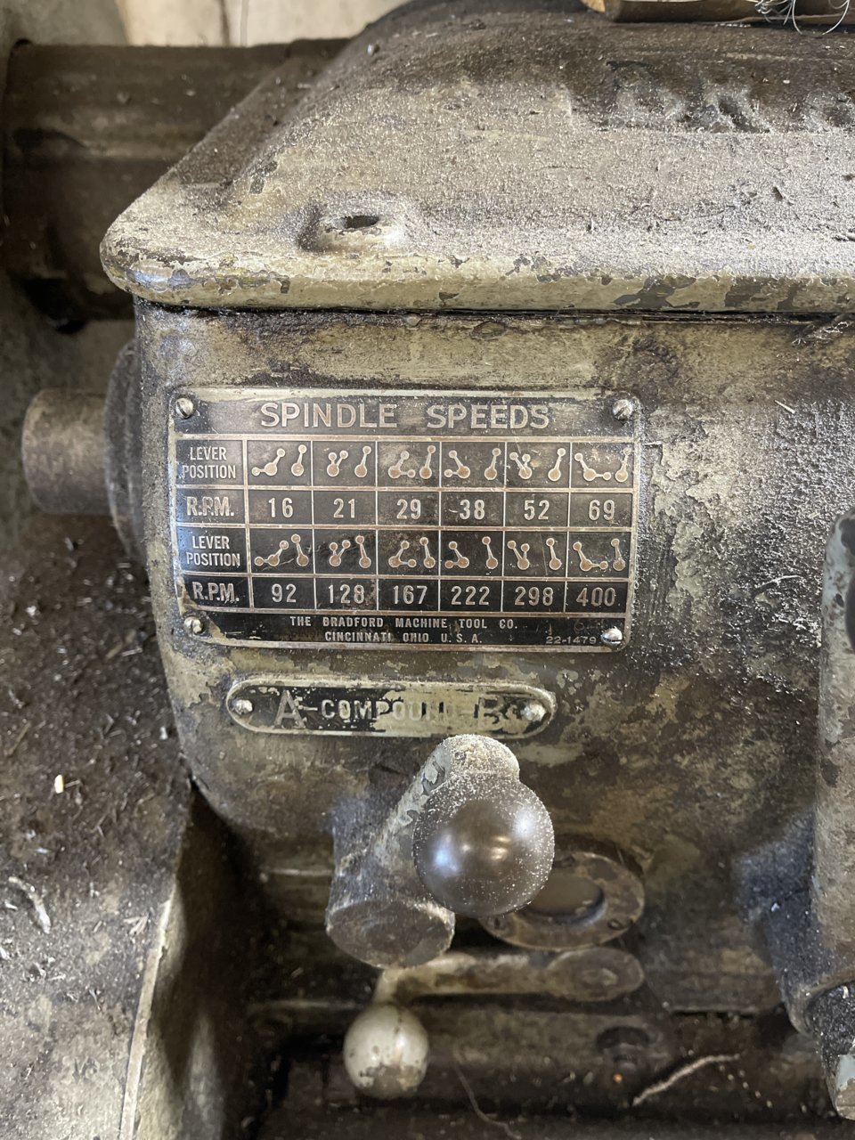

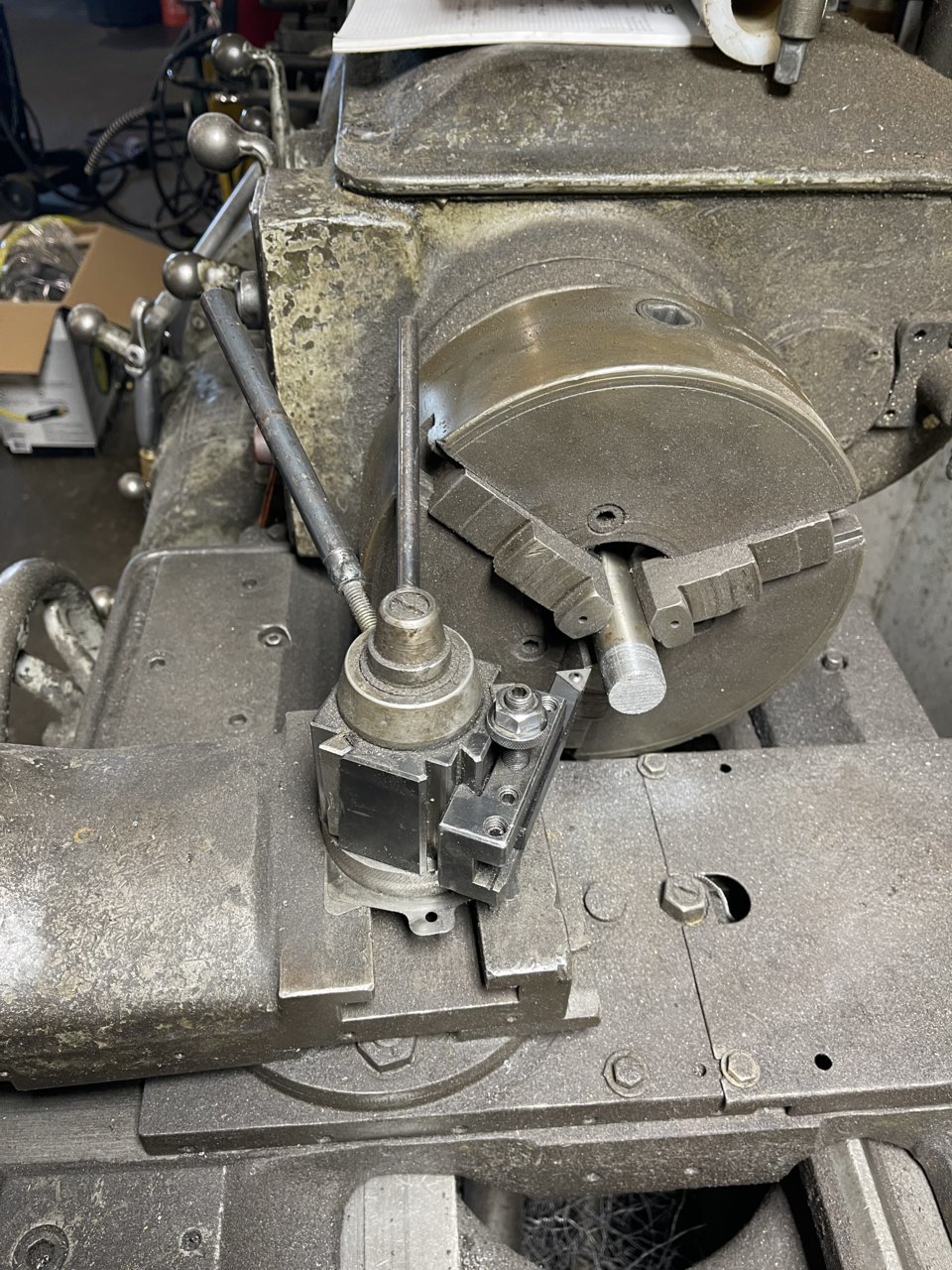

    Put the tool holder on one of the other dove tails!

    Remove the tool, loosen the top bolt and turn the tool post to where you need it. It also has another place where the tool can go.

    Oh damn... that's a slow old beast; I figured it would be good for at least 1200... do you have any HSS tools you use instead of the carbide?

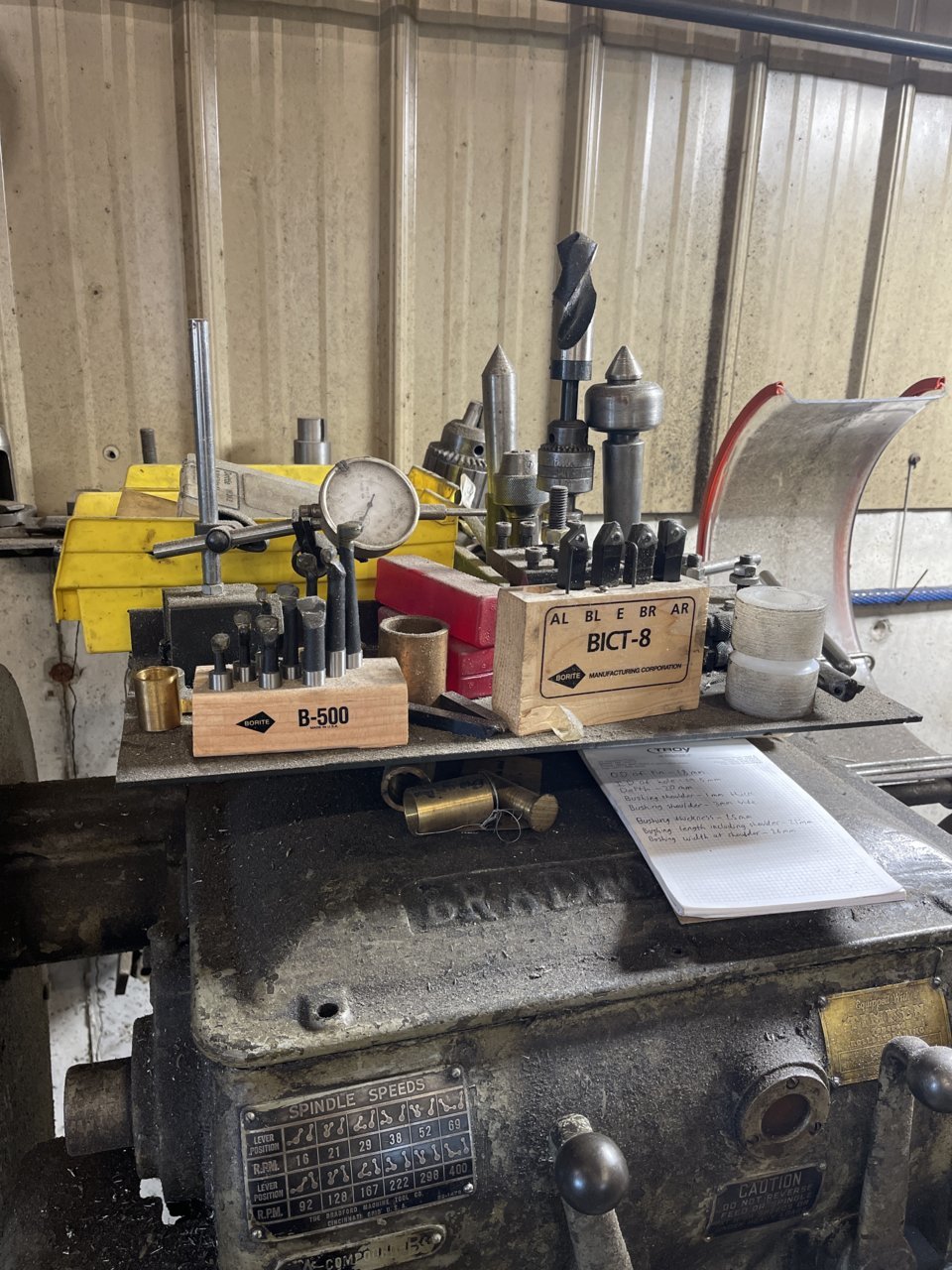

    This is all that I've found in this shop for the lathe... not even any HSS stock to make something out of. image.jpg
  10. Sep 3, 2021 at 12:37 PM
    tacotoe
    tacotoe Pastry Chef
    Nov 25, 2007
    #3593
    5,915
    Nebraska
    `17 AC Sport MT
    ARE Topper, Icon aal, OEM Audio+
    We can help you do all kinds of damage with that amount of tooling!
  11. Sep 3, 2021 at 12:37 PM
    tirediron
    tirediron Well-Known Member
    Jan 19, 2019
    #279864
    3,891
    John
    Victoria, BC< Canada
    2022 4x4 Sport, Auto, BCM
    I hope you've got a good file, emery paper and LOTS of patience! :D

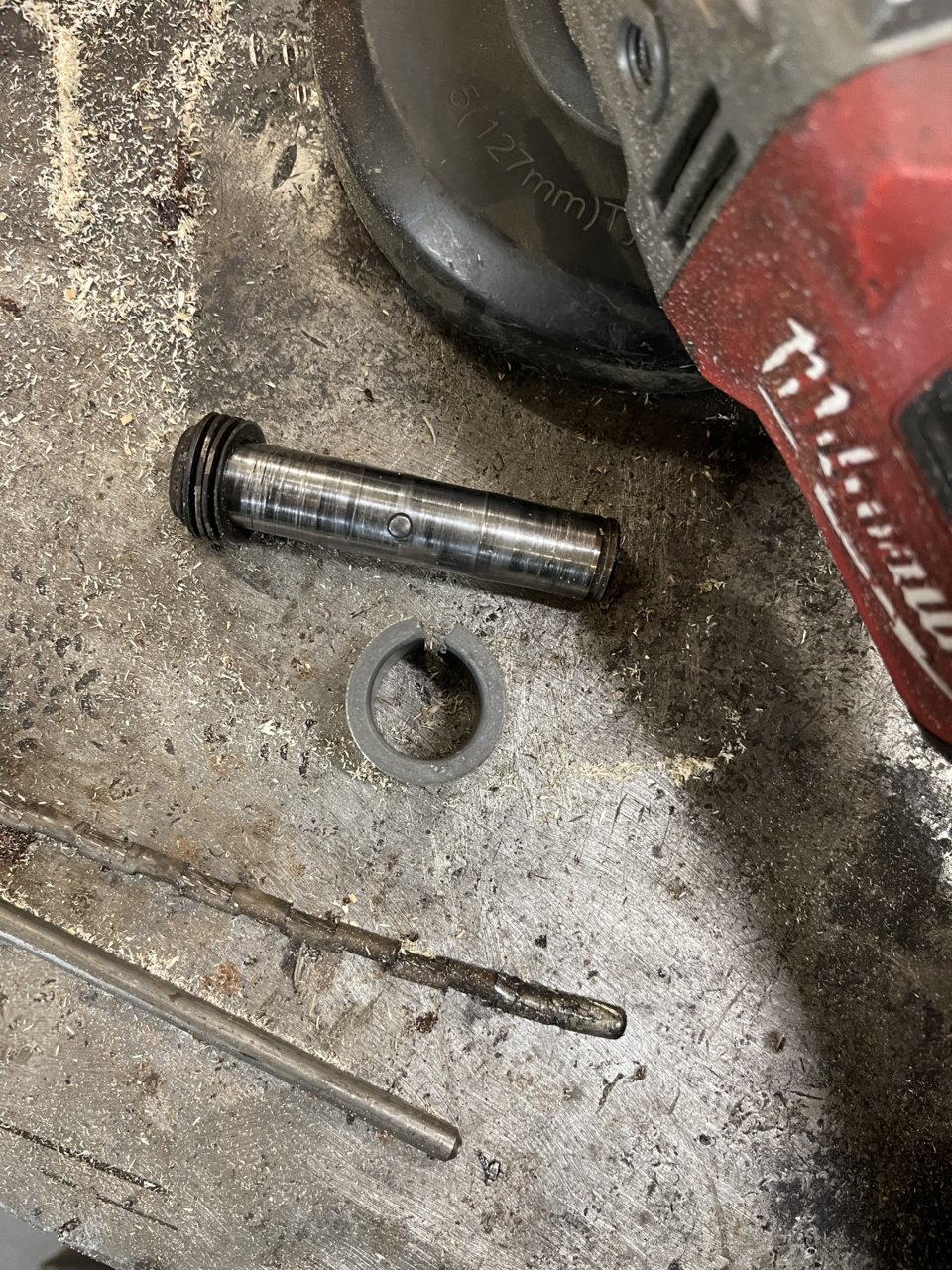

    Visual representation of an "oh shit!" Moment... turned the speed to 400 rpm at the chuck, not realizing that would speed up the auto feed as well... luckily I disengaged the feed as my hand was still on the lever just in time.02DDFFD7-A18E-4292-9018-85DB3F774FDB.jpg

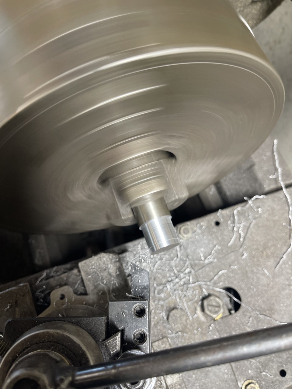

    Yay! Chips! I guess my boss isn't too confident in my newfound ability as he asked me to cut hunks out of a too large bushing and "squeeze it down" to work. Not sure how that's going to go... image.jpgF2CC75FF-5DCA-4569-B630-0B337F311174.jpg

    Thanks! I haven't crashed it yet... my roommate is a trained machinist with a mechanical engineering degree. He was telling me over the phone how to calculate how fast to spin the spindle. I cut him off and told him it only does 400 rpm. There was a couple seconds of silence before he said "just crank that bitch to max and leave it there."

    Cut chunks out of a bushing and squeeze it down :smash::smash::smash:
